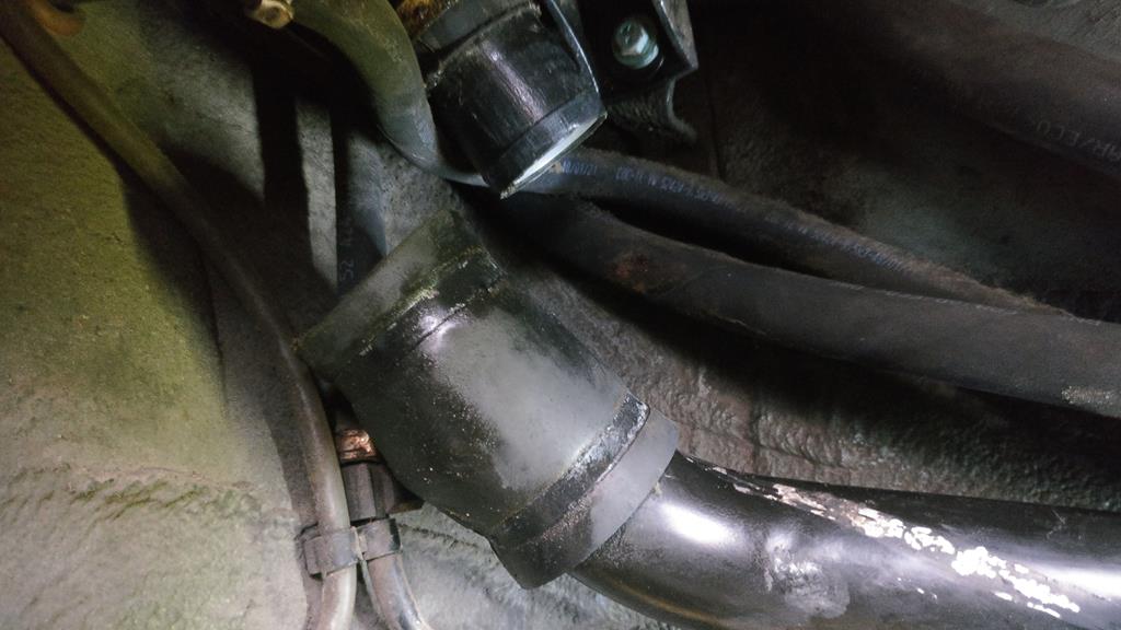

This crusty clamp connects the filler neck to the tank and disintegrated as soon as I touched it
Coupler removed
Slide this coupler down the filler neck and then the tube can be removed

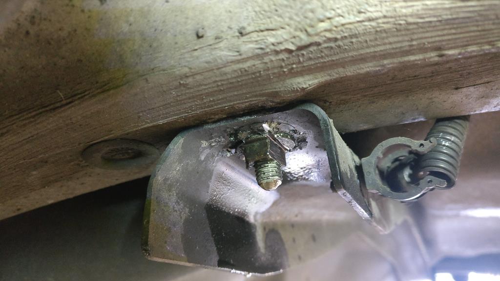

These nuts on the tank support are known to be problematic as the studs are just rivnuts and tend to come loose from the body before the nut comes loose from the stud, so I just slice the nut straight off.

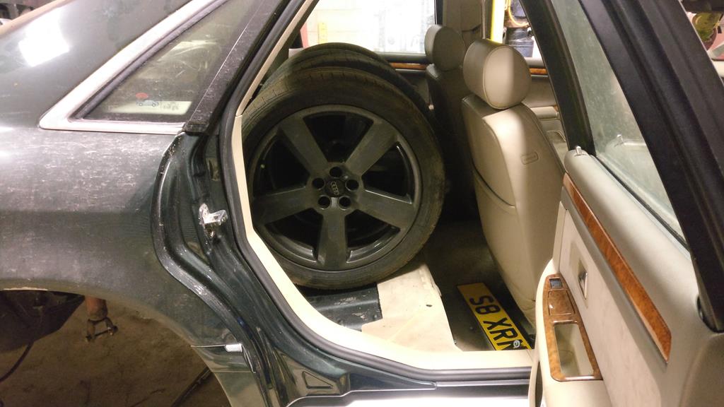

Around this time I am getting very nervous about removing weight from the rear, with the engine and gearbox still in the front, so I strapped the car to the lift!

I replaced the weight of the back seat with wheels

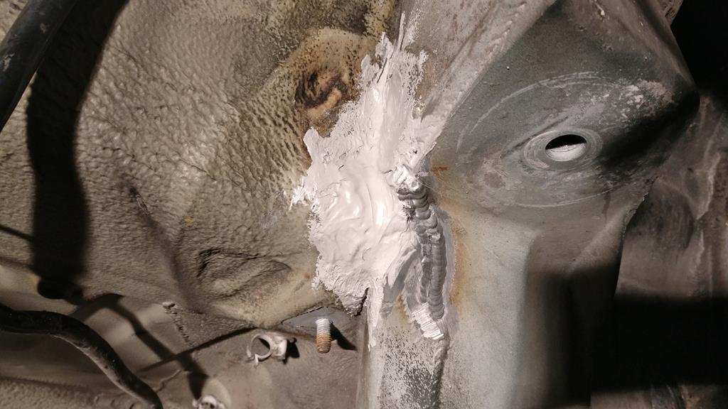

This taped-over hole was actually the best access to the void above the crack, such that it lit up from the welding arc I was standing on a ladder with the fire extinguisher while the welding was happening underneath. I knew when the crack was sealed up again as I could no longer see arc-light through the hole.
Craig the welder drilled holes at the end of the cracks to stop them propagating, then tig welded the crack back together
He then laid a second bead down next to the first for added strength. You can see from the bead going left from the main one where the crack had also gone sideways - this would have been impossible to get to if I had left the tank in. Apparently I didn't quite remove enough underseal though, so that got a little crispy!
Smoke mostly cleaned off and the whole area wiped down with thinnners
Underseal reapplied in the original locations. I will paint over the underseal and the weld tomorrow once the underseal is dry.
