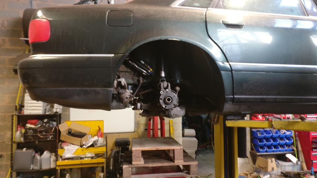

Lunchtime update - the subframe is back on

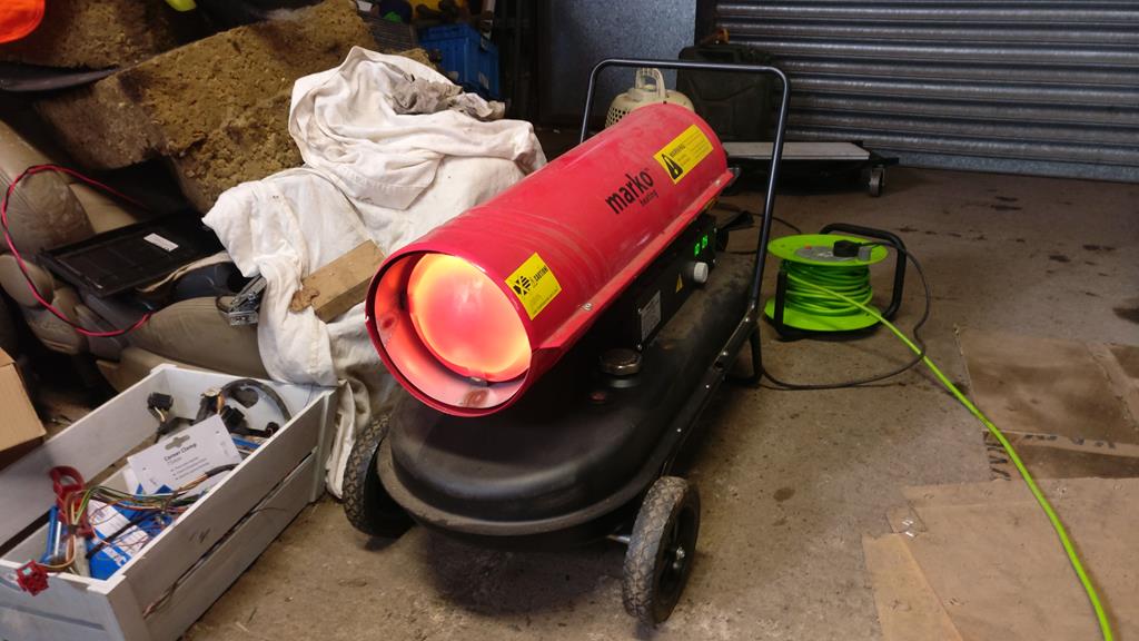

1°C in the workshop this morning, so the heater is working hard today. Thank you to all who contributed to that last year
The original clic-clips cleaned up ok in the end so I put them back on.

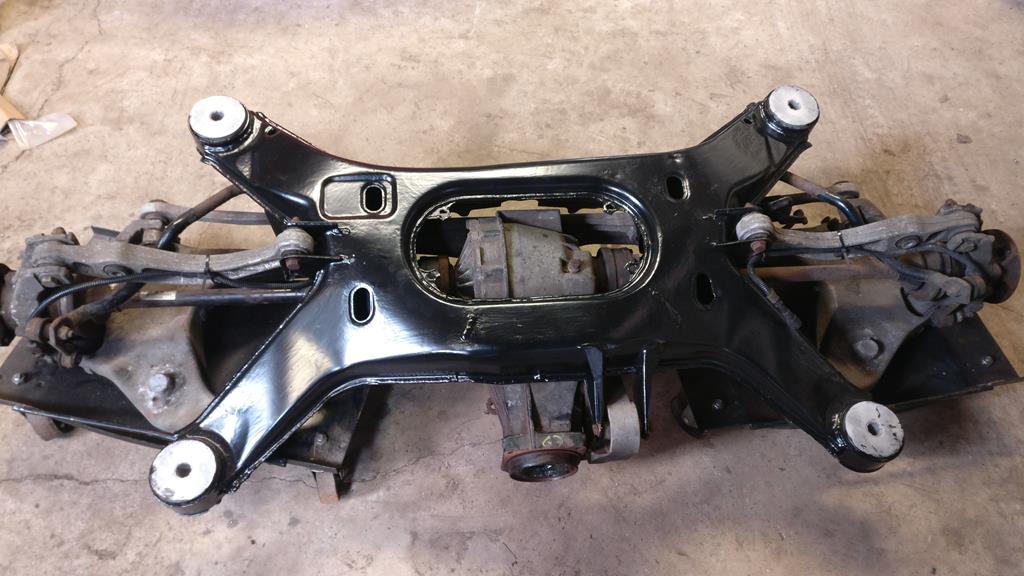

Mike helped me reassemble the subframe the other day so its ready to re-fit

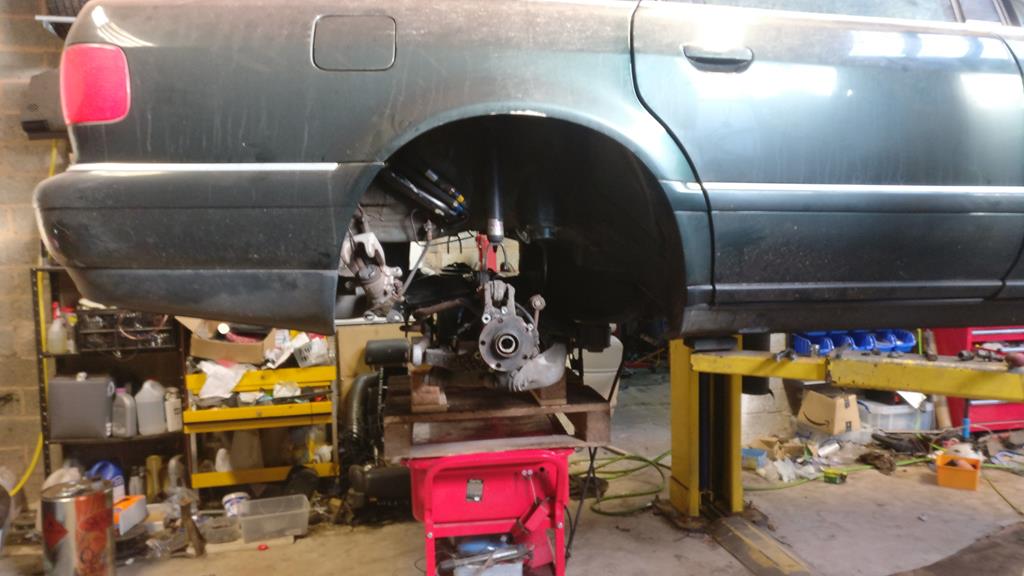

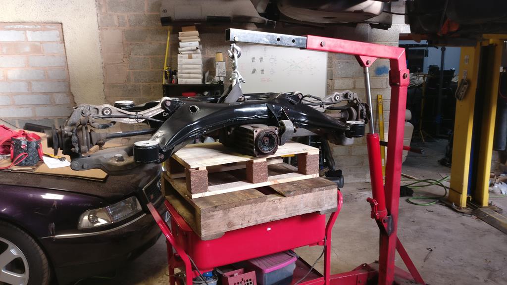

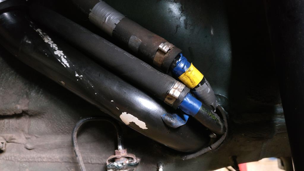

The trolley worked well for the fuel tank so I'll use the same solution for the subframe

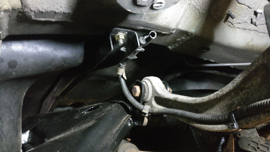

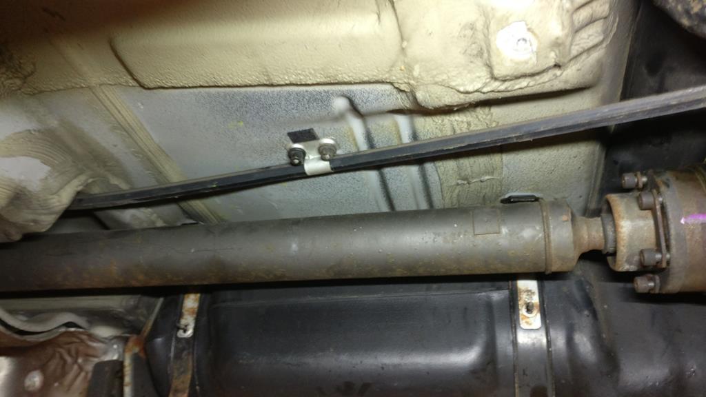

The diff heat shield is always corroded and loose, and of course NLA. I reattached this one with cable ties, but I may look in to laser-cutting these in the future.
Lower the car on to the subframe

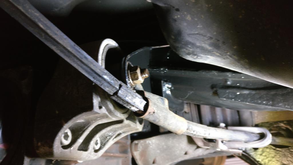

Reattach the ABS sensors before the subframe is fully in place as they're easier to get to like this

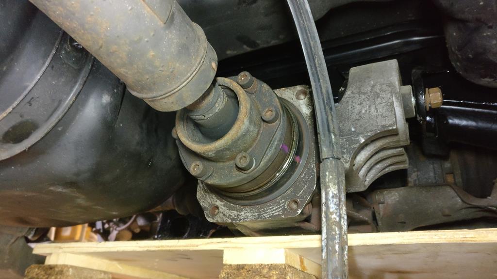

I also reattached the prop to the diff, and the handbrake cable to the subframe
Lower the car the rest of the way, put the bolts in, and lift off the trolley

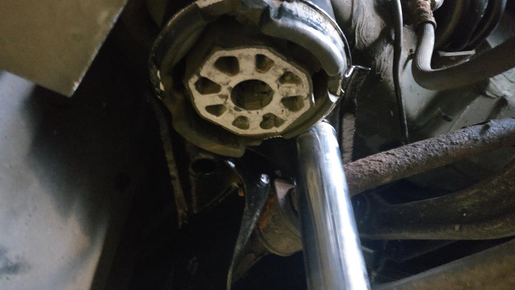

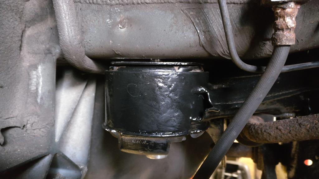

There's no obvious way to align the rear subframe, unlike the pins at the front, but the rear bolt holes have a quite deliberate machined recess in them so I suspect the factory used something in these rear holes. I made a pin which was a snug fit in both the bush and the thread and used it to align one rear bush then the other
The pin goes through the bush and centres it on the hole
Support the subframe with the transmission jack so it can't move, then remove the pin and replace it with the bolt

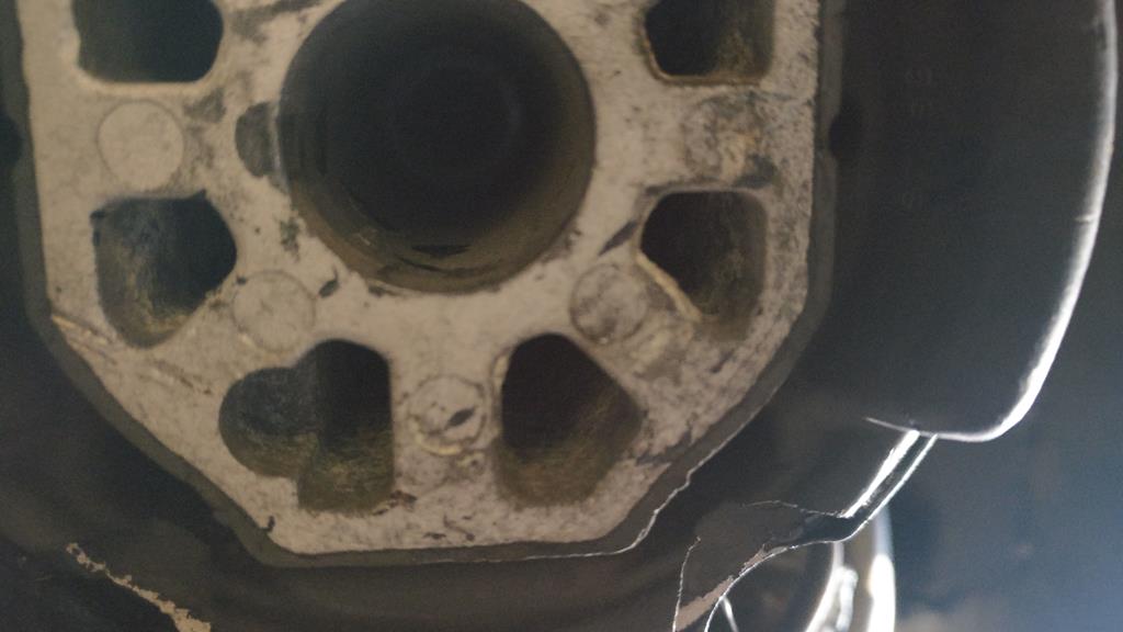

Bad pic, but you can see the bush is centred. I did this on the right first, then the left, then did up both front bolts. The alignment rig should tell if this trick worked.
About this time I realised I also should have put the heat shield in place while the subframe was down, as now I have to drop the propshaft again Luckily I didn't torque the bolts up so not terrible.
Brakes and springs back in next. Maybe back on wheels by teatime ready for an eyeball-alignment

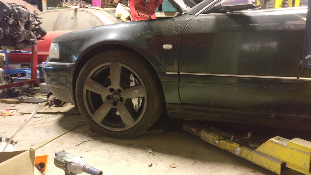

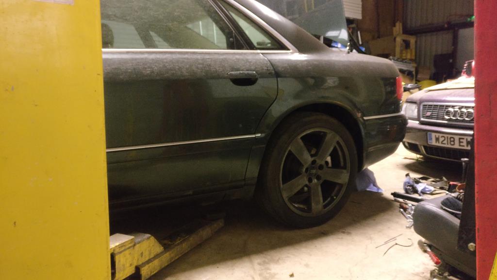

I put the rear brakes and springs back on, and then put the wheels back on to get an idea of ride height and alignment. I wound the KWs all the way up before putting them back on, since its much easier to wind down on the car than up, and I need it at or around stock height to get a proper alignment. It needs to come down a little but all the wheels appear to be in the right place now
