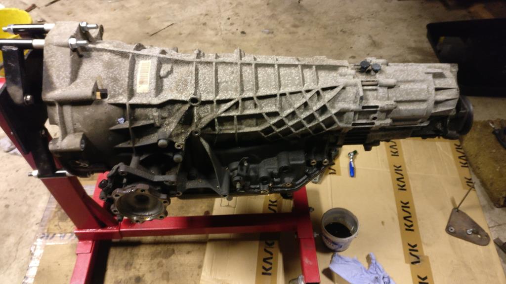

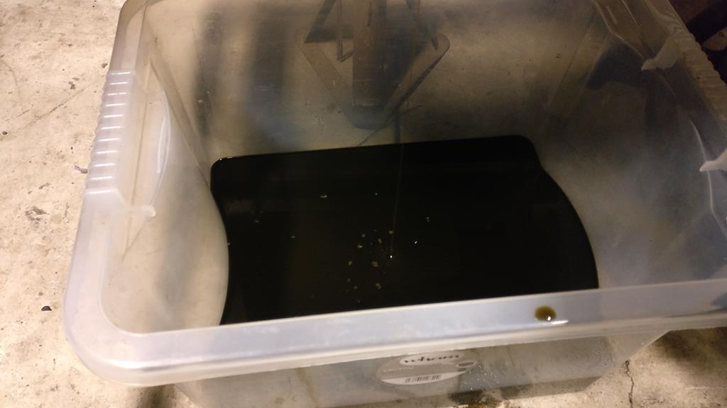

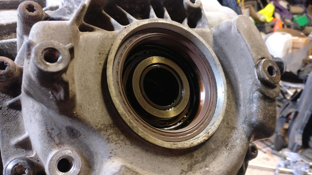

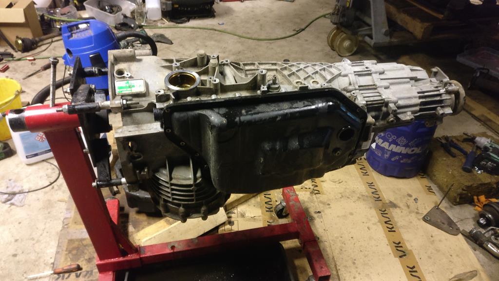

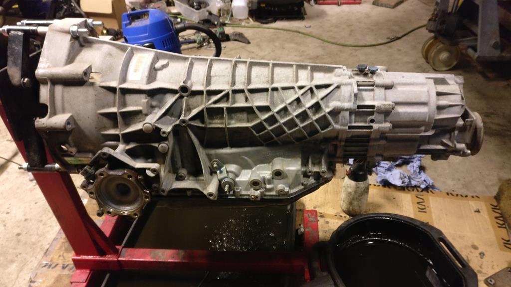

The gearbox oil is quite dark so I'll get as much of this out as I can, including from the converter
The centre diff oil - that's not 0.8 litres Most of it has escaped through the rear output seal.
Gearbox bare of acoutrements and on the stand ready for cleaning tomorrow

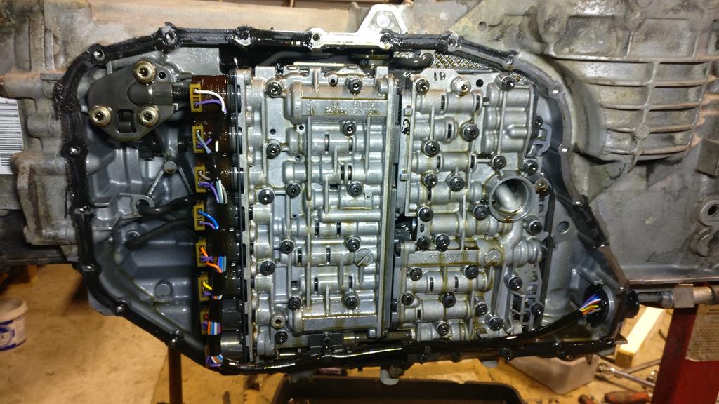

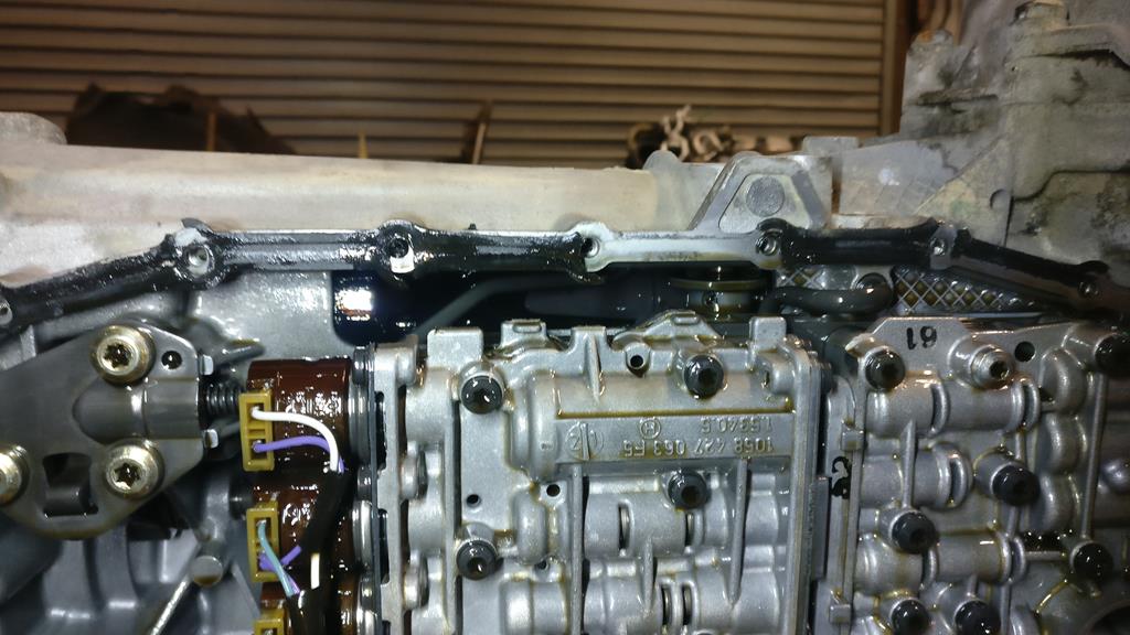

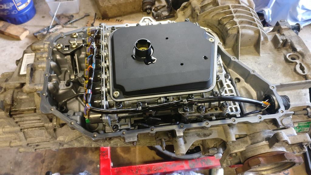

Nice and clean

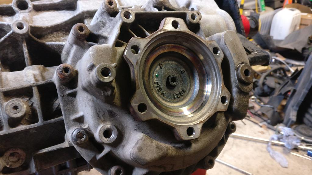

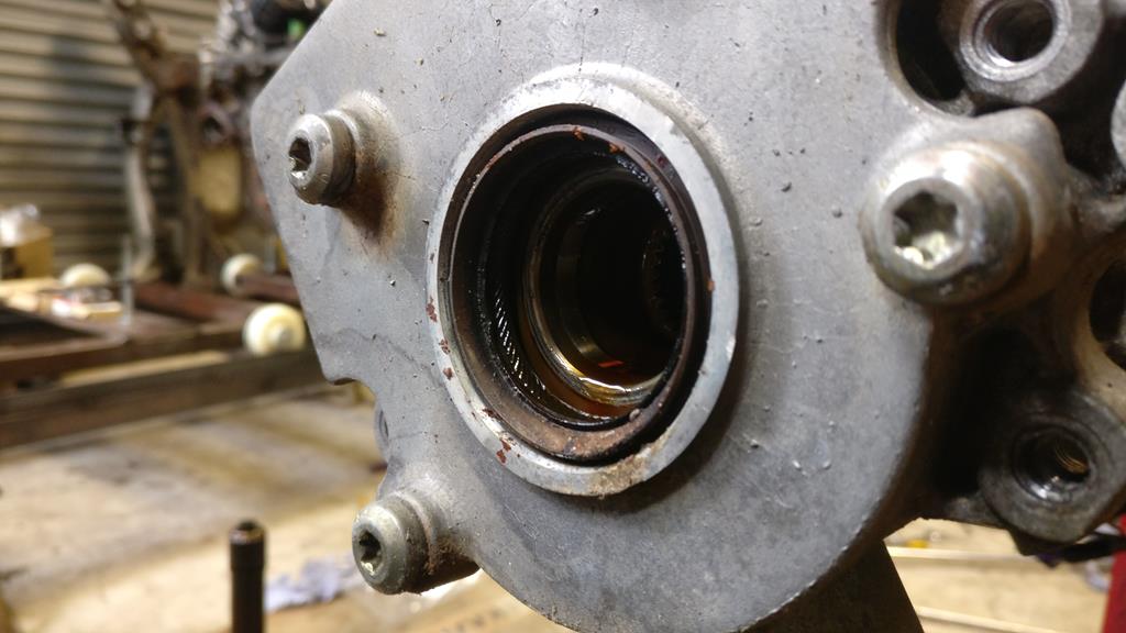

Drain the front diff oil - as with the centre diff, most of it had already escaped.
The left side output shaft will get a new bearing and oil seal as usual
No dirt inside, just drips of dark oil
The gasket is trashed though - it was dripping oil when on its side before I even removed any of the bolts. It has been serviced before so whoever did it probably didn't quite get the bolt torques even.

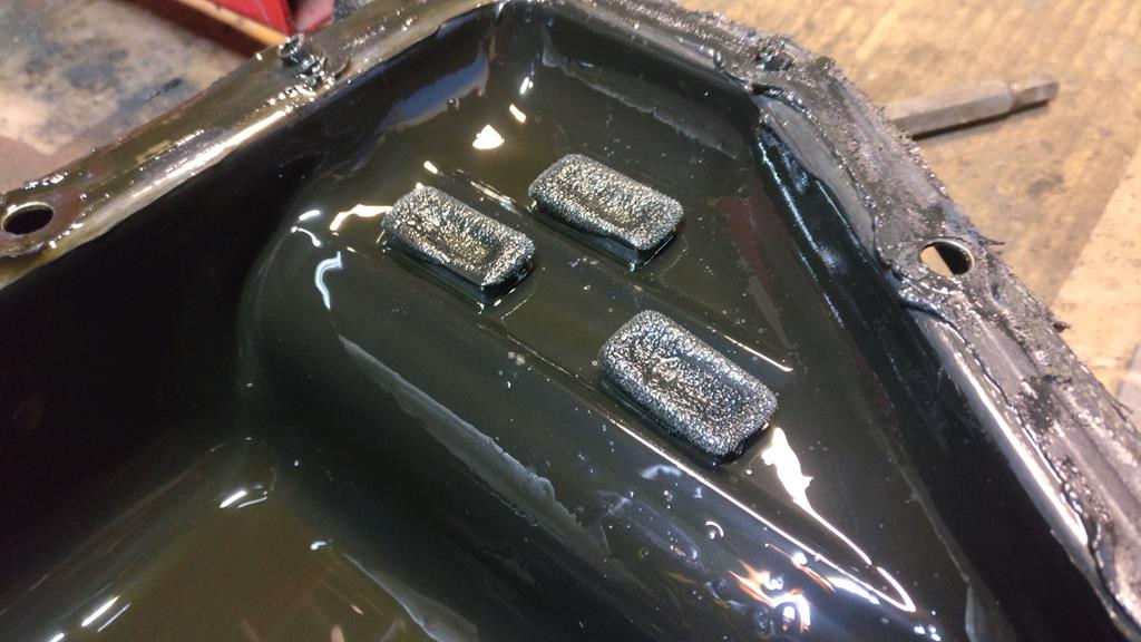

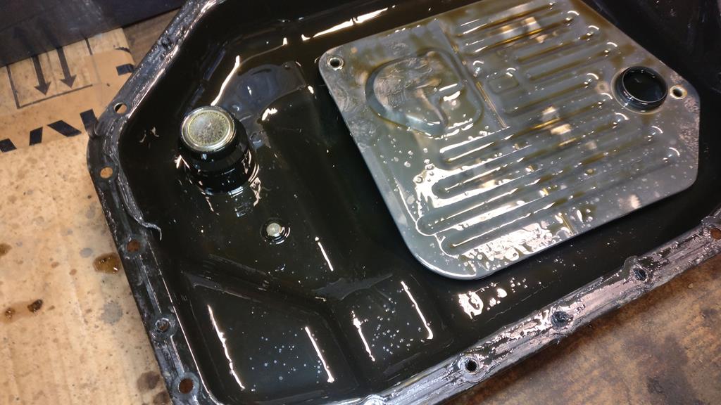

The magnets are appropriately furry - nothing wrong here
The sump is nice and clean
I'll leave it with the sump off overnight for the oil to drain, then back together with new seals tomorrow, then I'll start on the engine

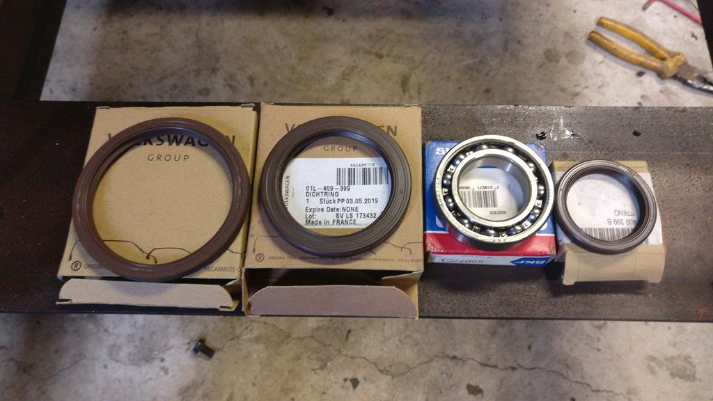

All the seals plus a bearing for the gearbox

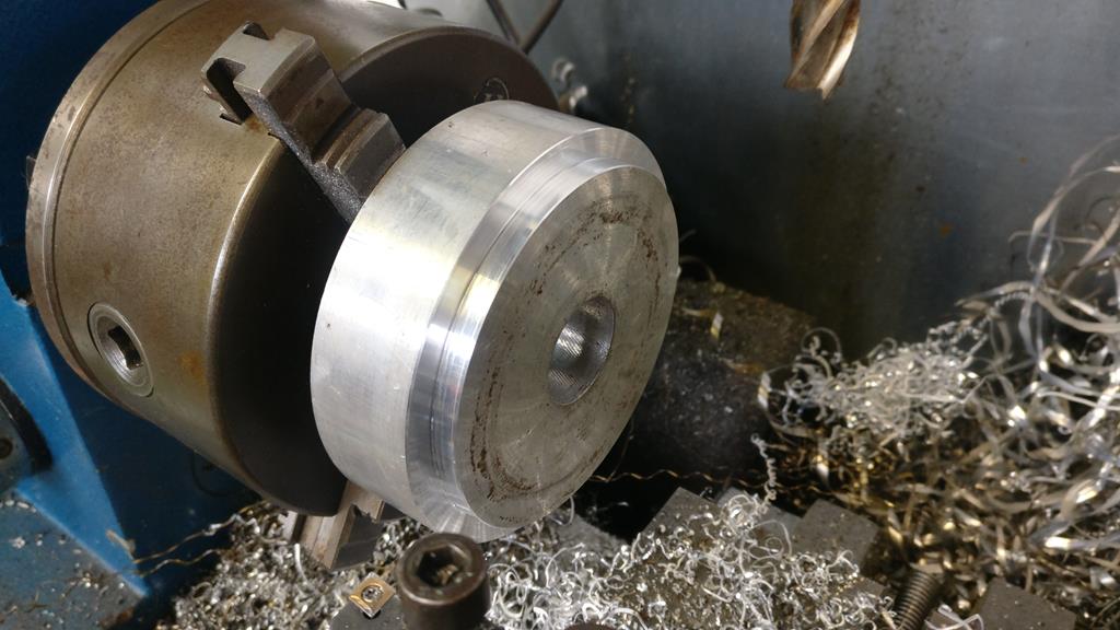

I made a tool for the right hand output seal as this one is a pain to seat square
Seal pushed in at 6.5mm in from the flange
New seal fitted and the flange back in
The rear output shaft had the updated oil seal, but doesn't have the updated flange so this extra lip wasn't doing much good. The seal had been pushed all the way in so it would fit together. I replaced it with an original design seal.

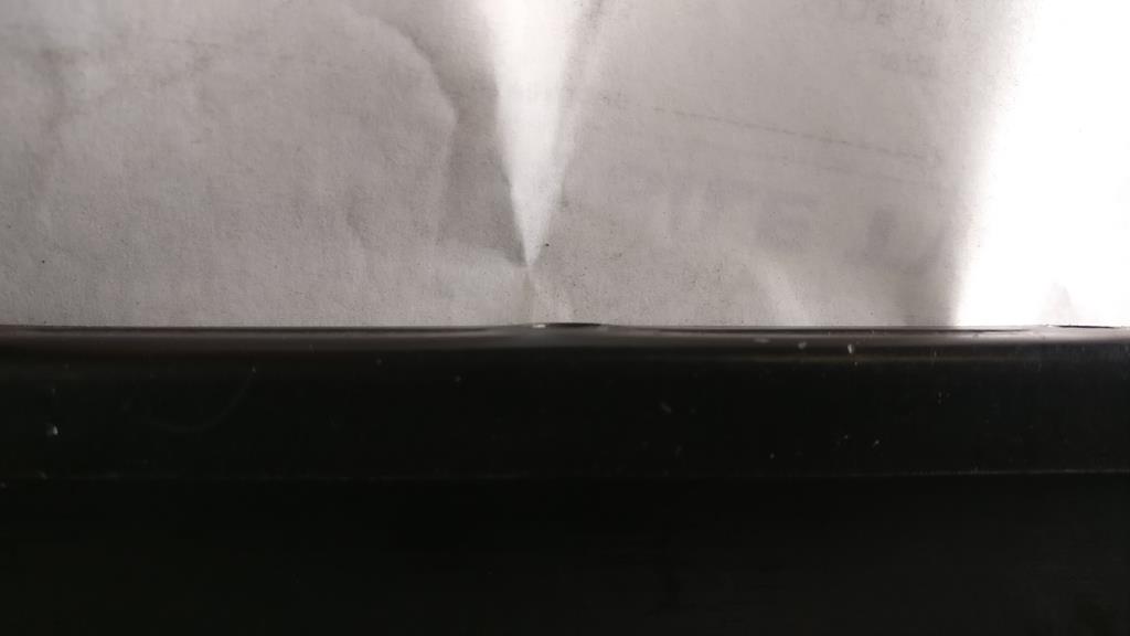

On to the sump. After cleaning I realised that at some point in the past the bolts had been over-tightened and distorted the flange. You can just see the bump in this pic - this will damage the gasket when torqued, and won't seal between the holes
Its also been dropped I think and dinged the flange. It rocked side to side across the diagonal so was never going to seal properly
It took quite a while to hammer it all back flat, but by the time I finished it sits perfectly on the gearbox casing and doesn't rock at all
I primed the oil pump then put a new filter on, then got distracted by the barn-find FE arriving so this is as far as I got today
I'll bolt the sump on tomorrow then the gearbox is done bar filling it with fluids.
