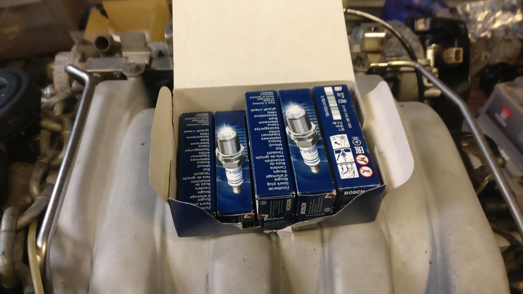

Did the drive plate bolts and the starter this morning
New spark plugs

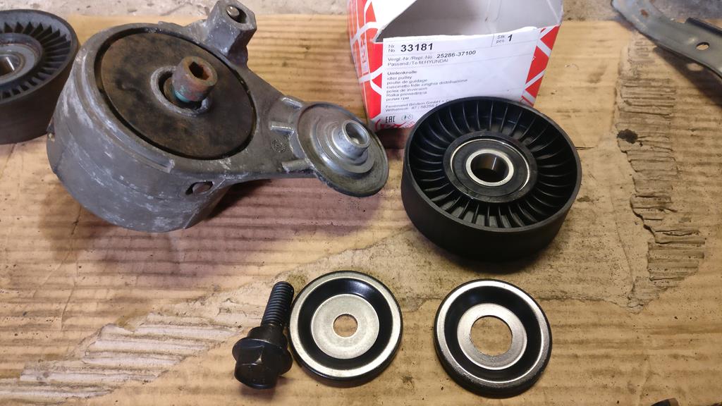

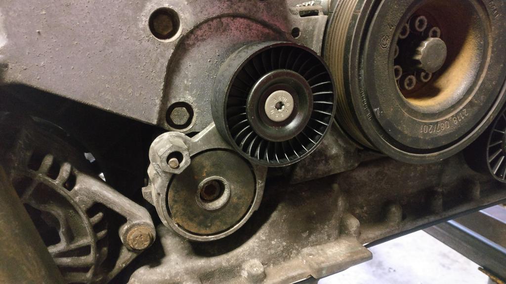

Not sure if I've shown this tensioner trick before. The V8 tensioner is only available as a complete unit for £80-100 depending on brand, but the tensioner part itself is always fine. Its only ever the roller which wears out.
So, remove the roller
and acquire one from a Hyundai 2.7 Febi number in the pic - INA make one too. If you're going to do this, make sure you get a good quality one which comes with a new bolt and washers since we need one washer.
The Hyundai roller doesn't have the moulding to take the plastic cap from the original roller - instead it has this washer which goes under the bolt head. The washer has a 10mm hole though, and we need a 12mm hole...
Embiggen the hole with the step drill. Don't try and do this with a twist drill as it will grab and spin the washer. A step drill is much better for thin stuff.
Attach the new roller with the modified washer and original bolt
Back on the engine and running smooth again but for £22 instead of £80.

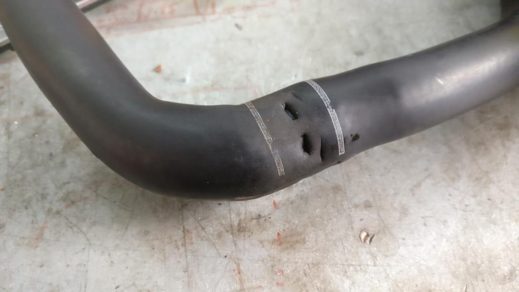

The clips for the header tank hose have dug in to the rubber.
I don't have any spares of this hose as its a very common problem. The hose isn't split though, so the area is protected with heatshrink sleeve.

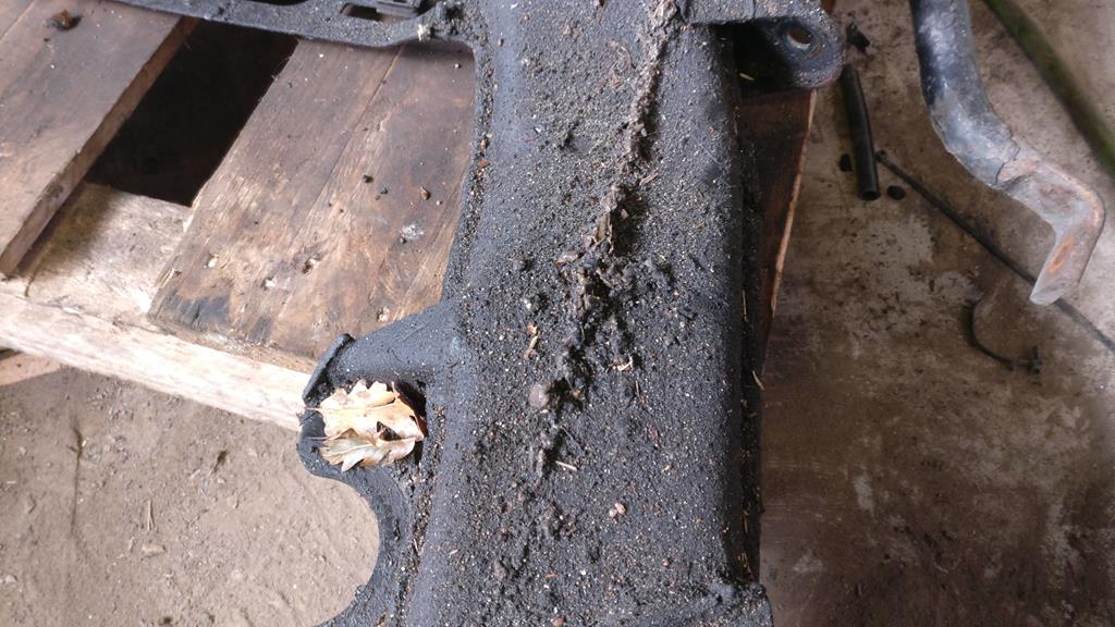

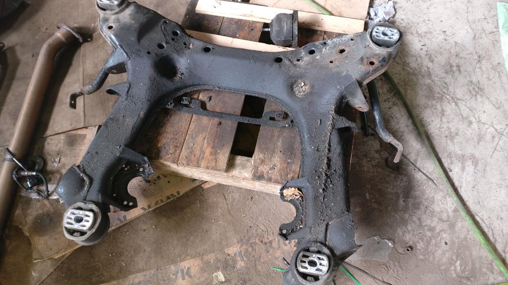

The subframe is pretty grim!
Elbow Grease and the pressure washer mades short work of cleaning it

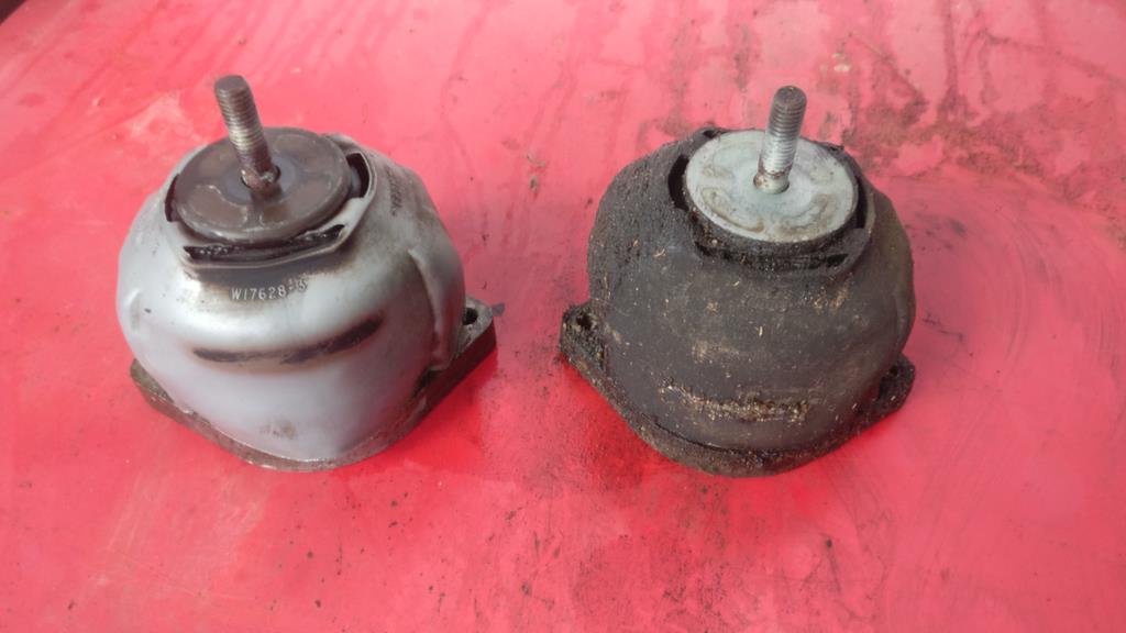

Clean gearbox mounts probably don't make the car run any better, but they do make it nicer to work on

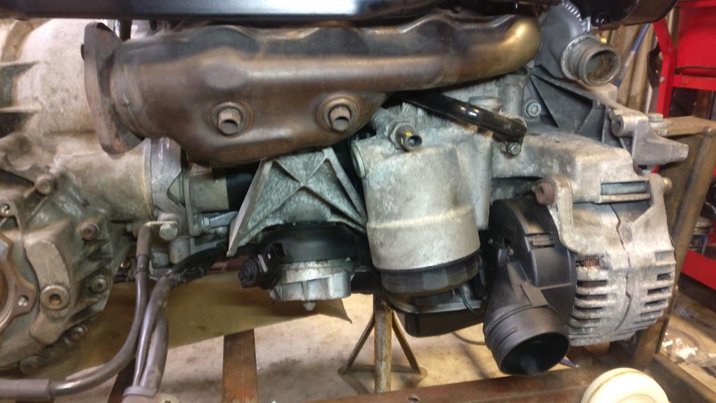

Exhaust manifold bolts replaced with stainless
Engine back in

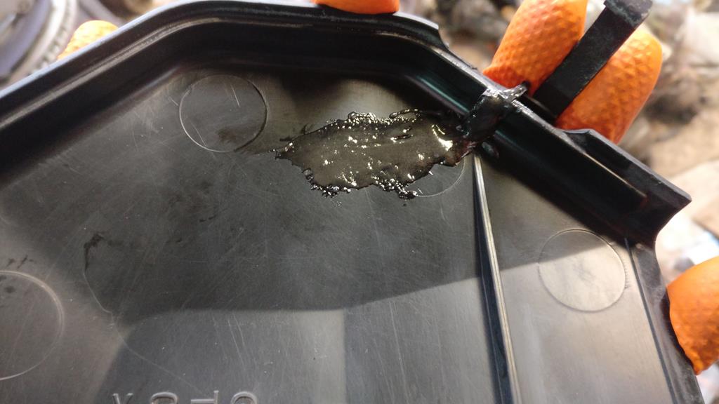

The right hand cam belt cover was cracked and I don't have a spare so this was repaired with specialist adhesive. These covers are nylon which is very difficult to glue as it has low surface energy so traditional adhesives don't stick to it.

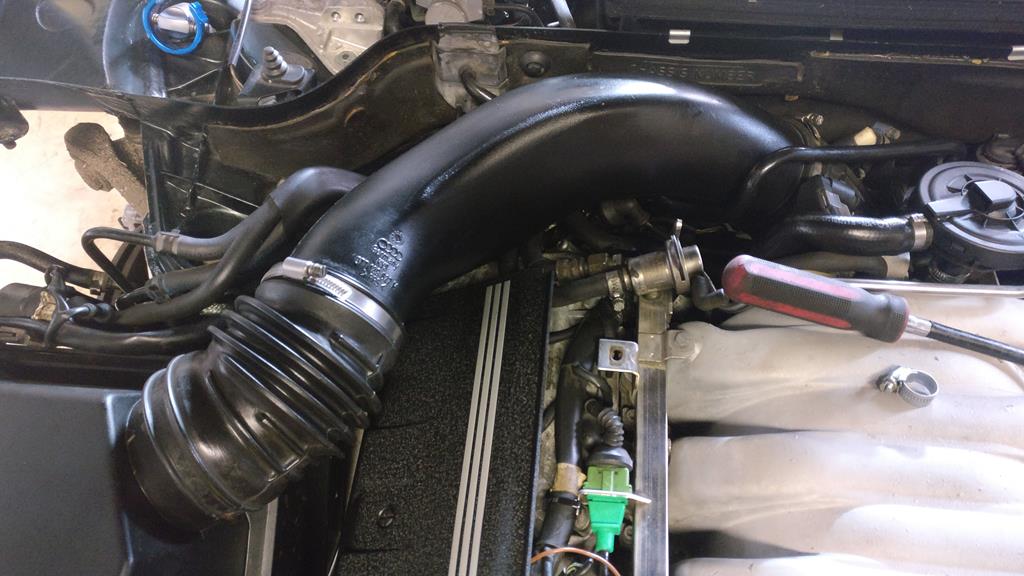

This was a bit of an April Fool's trick on me! I spent a good 5 minutes trying to work out why the intake tube wouldn't sit right before I discovered it was previously on backwards Speaking to Ricky later it turns out he did this while replacing something else, and tbf if you're not that familiar with this area its an easy mistake to make since the ends of the tube are in the same place regardless of which way round it goes.

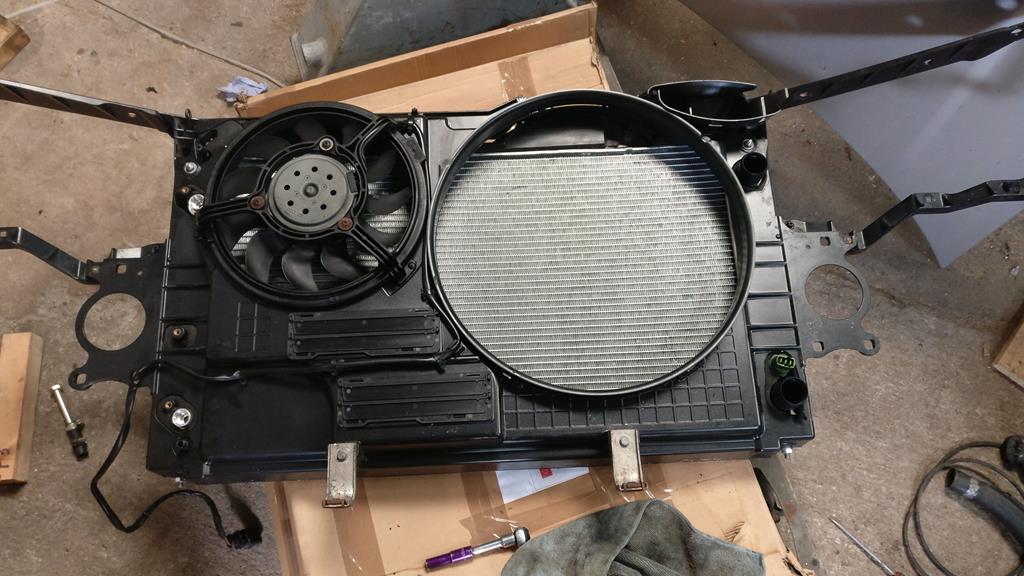

This single picture represents a full day's work! This is a new radiator attached to a replacement front panel, with the headlight surrounds, fan, and other paraphenalia rescued from the original panel which is a lot more work than it sounds. I've used modified aftermarket rubber mountings for the radiator itself as the originals are NLA. I also straightened out the undertray brackets and fitted new rivnuts to the panel as they always take a beating even on stock ride height.

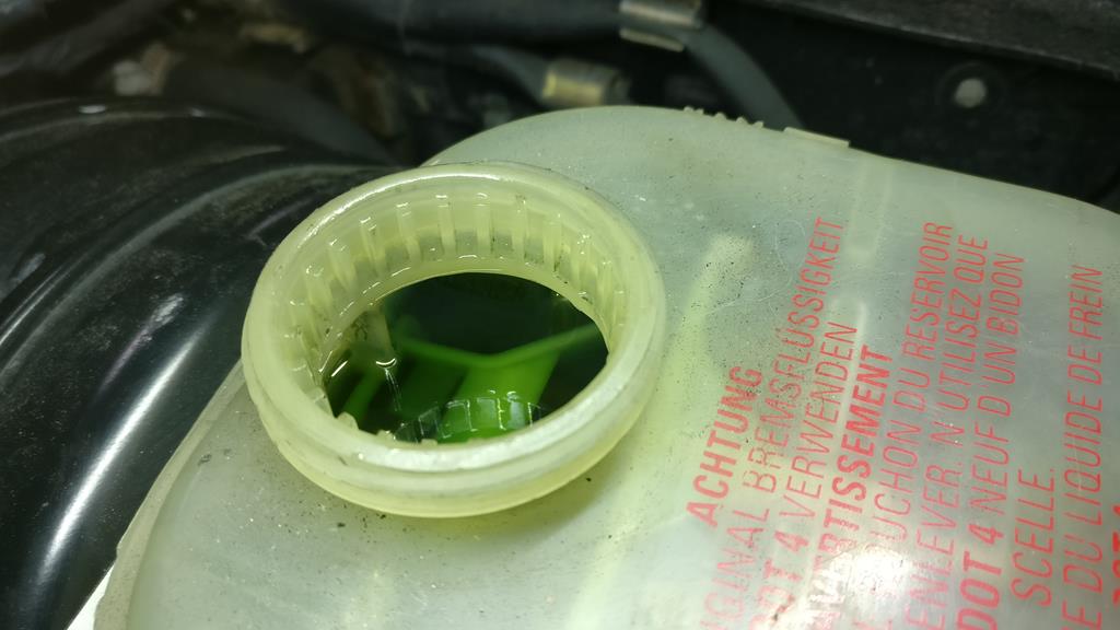

The final job was a brake fluid swap - as you can see, its a little past it's best! It should be changed every 2 years, but they are pretty much all in this state the first time I see them. I think most garages are wary of touching the braking system on the D2s, and with the Brembo calipers tbh its not that surprising since if you don't regularly exercise the bleed nipples they seize solid in the calipers and then you need a caliper refurb to change the brake fluid Luckily Ricky's are in excellent condition so the fluid swap was pretty simple.
Before:
After flushing 250ml through each caliper
