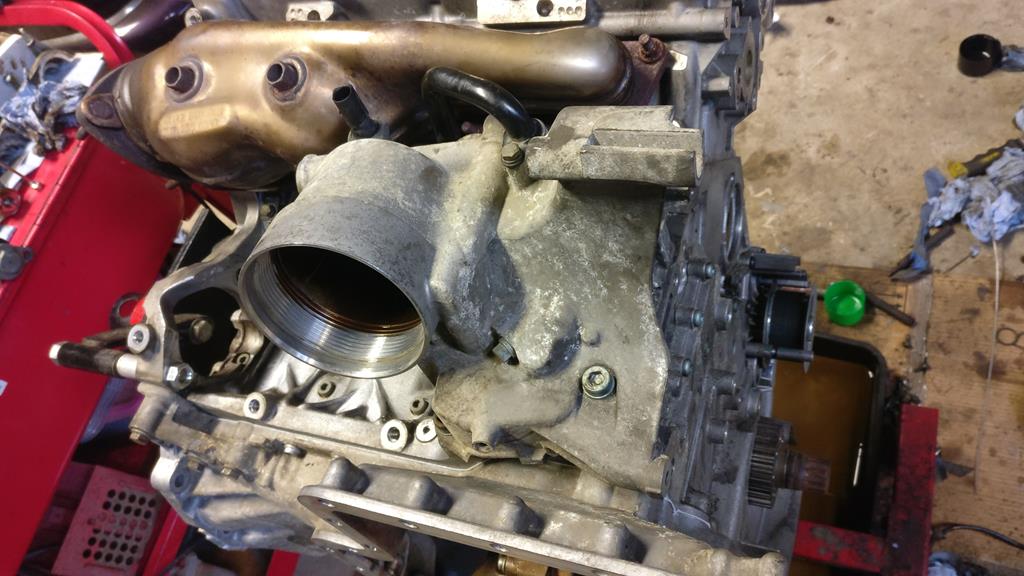

Having made a shopping list and ordered a bunch of parts, I wanted a better look at the broken engine to see if it is saveable, should a head turn up in the future. Also, we wanted to see if the cam chain tensioners were still good, as I know the ones on the replacement engine are not.
Bank 2 tensioner removed - this crud in the oilway is what destroys the filter gauze which then kills the tensioner. I've never seen this much before though. I think this is gunge from the mayonnaise detergent effect cleaning everything out

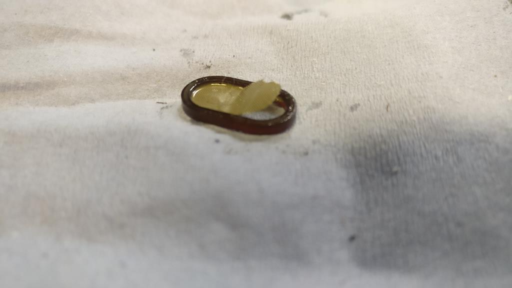

Amazingly the gauze has survived!
Alas the bank 1 gauze and consequently tensioner has not survived. No idea why its always bank 1 that goes first.
The start pin still locks, but the non-return valve doesn't close fully so this will make a very brief rattle on startup, but not frightening clatter that the start pin causes.

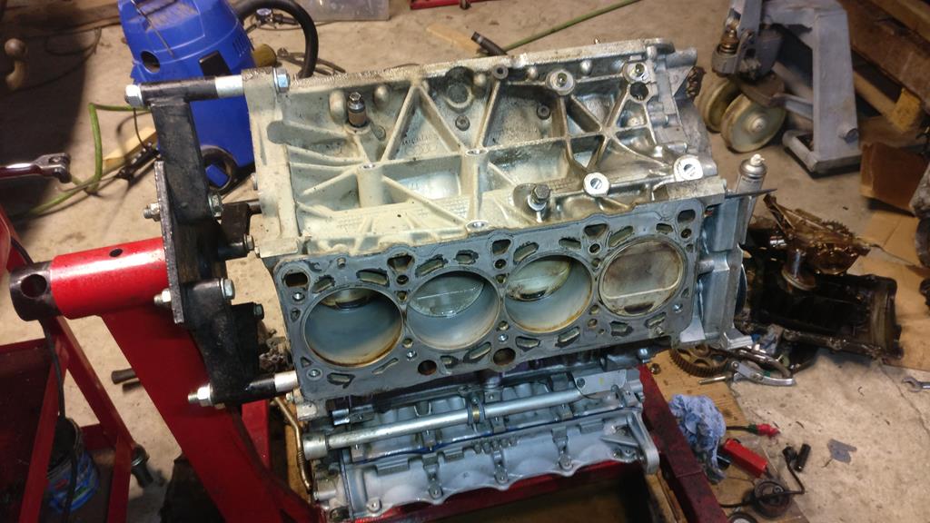

Well, you can tell which cylinder was ingesting water Its spotless!
The head has been cleaned too

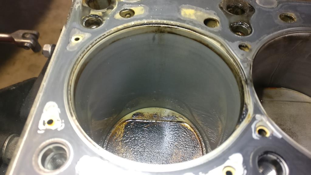

The cylinder wall is perfect though - I feared the water may have washed any lubrication off the bore and caused it to be scored by the rings but it has survived, meaning the engine is definitely saveable in the future
A slight stain on the cylinder wall from where the water has been dripping in, but there's no damage to the surface. Its just discolouration.

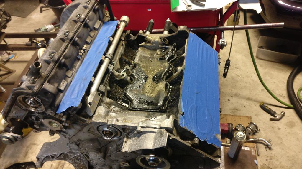

I started stripping the engine to clean it up. I want to get as much of the emulsion out as possible before storing it so it doesn't end up separating and leaving the engine full of moisture.
Not too bad under the valley cover

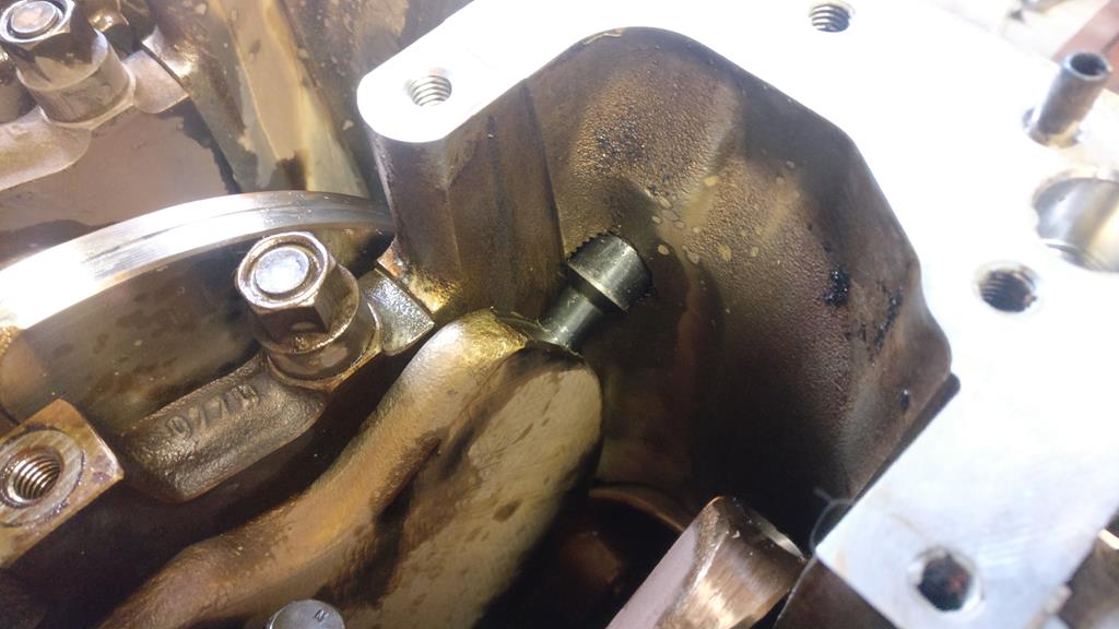

The oil retention valves are pretty nasty though. I don't want to retain any of this!

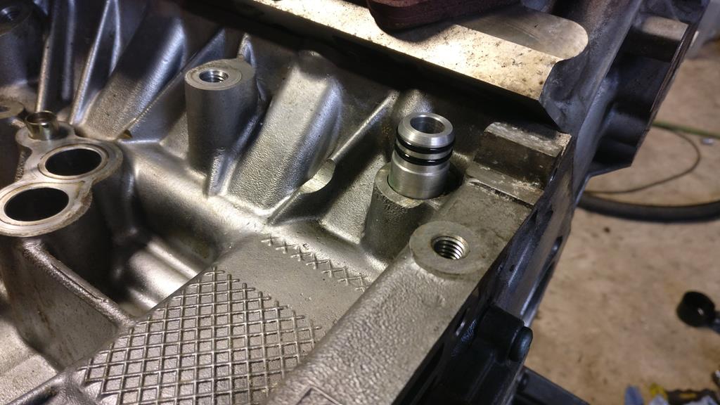

For those who may be curious, this is where the crank locking pin goes.

Cleaned up the mounting face on the block ready for when a head turns up
I'd removed the oil retention valves while the engine was upside down to let the slime drain out. Cleaned them up and put them back in.

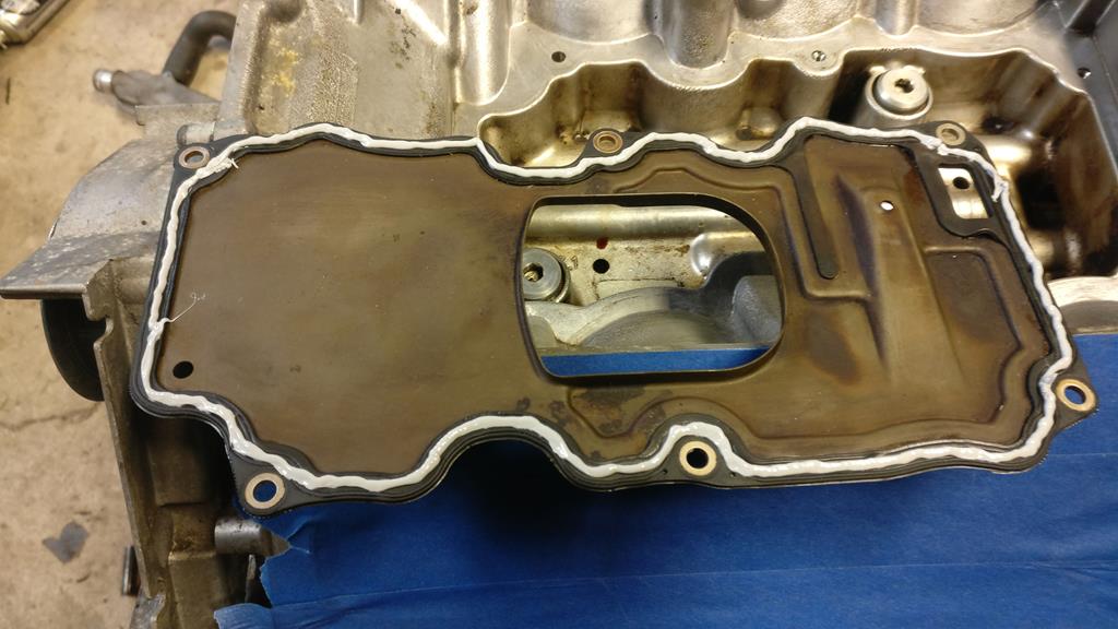

The breather plate is a; really expensive and b; back-ordered so I cleaned it and re-sealed it using the same silicone as used on the sump.
