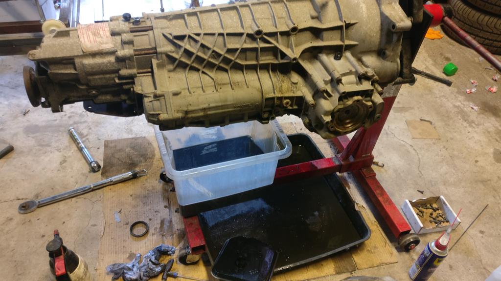

Gearbox next. As usual, I will flip it over to get to the sump and filter, however normally when I do that the diffs are drained ready for re-sealing. This one though is not leaking and so I'm not touching the output flanges and not draining the diffs. That means that if I flip it over, the gear oil will all leak out of these breather holes:
So, I printed some polyurethane plugs for them which worked very nicely
The ATF is nice and clean
I flipped it over to remove the sump. This bolt was stuck and stripped out. I cut a slot in it with the grinder and then persuaded it loose with a cold chise. There are usually a couple stuck on this side because the holes here go right through and the end of the threads get rusty. I have plenty of spare bolts so not a problem.
Stuck bolt at the top with crusty threads. All the other bolts were nice and clean.
Nice and clean in the sump - no fluff on the magnets. The phone had considerable trouble focusing on the shiny surface.
Evidence of a leak on this corner
Left it overnight to drain. New filter and sump back on tomorrow

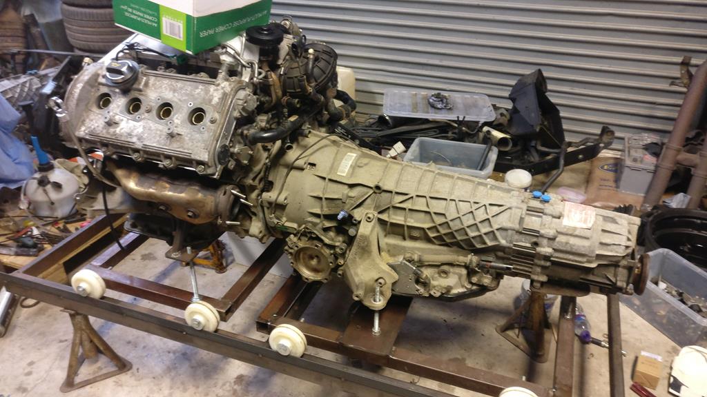

Took the engine and box off the separating table and put them back on the subframe to refit everything else. Spark plugs and coil packs on.

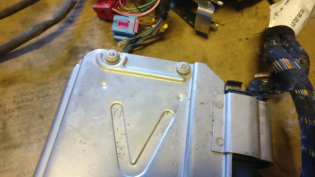

I'm swapping the engine harness (because of the missing connectors) and so I need to swap over the ECU, but first it needs breaking out of its jail

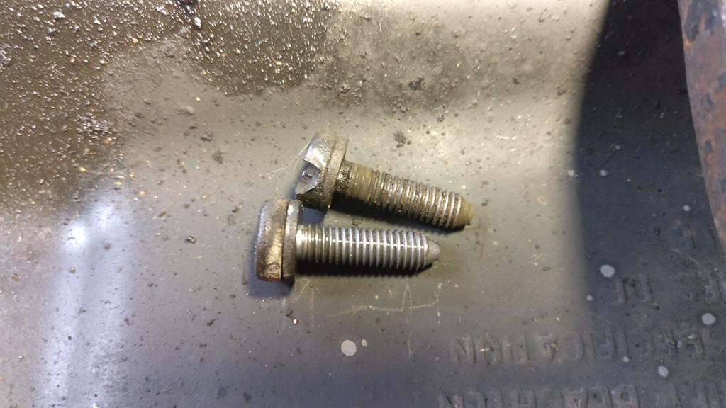

Cut slots in the shear bolts so they can be removed with a screwdriver
Escaped!

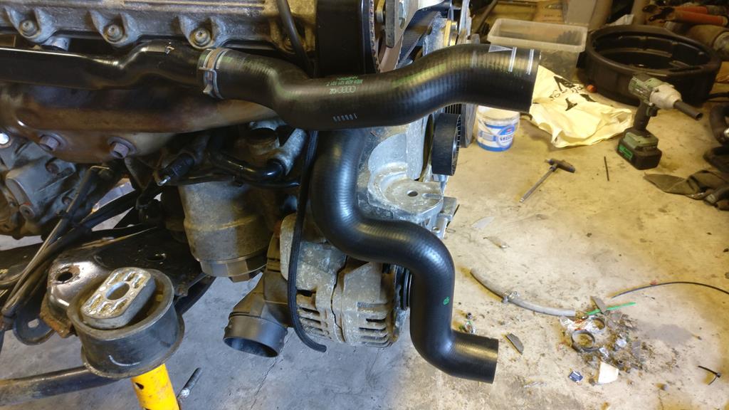

New coolant hoses

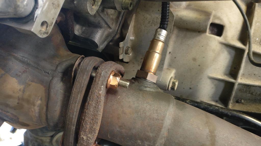

New O2 sensors as well
The engine and box are finally complete, at long last. As I'm replacing the control arms, I'll attach the lower arms and driveshafts to this tomorrow which will make it much easier to put back together.
