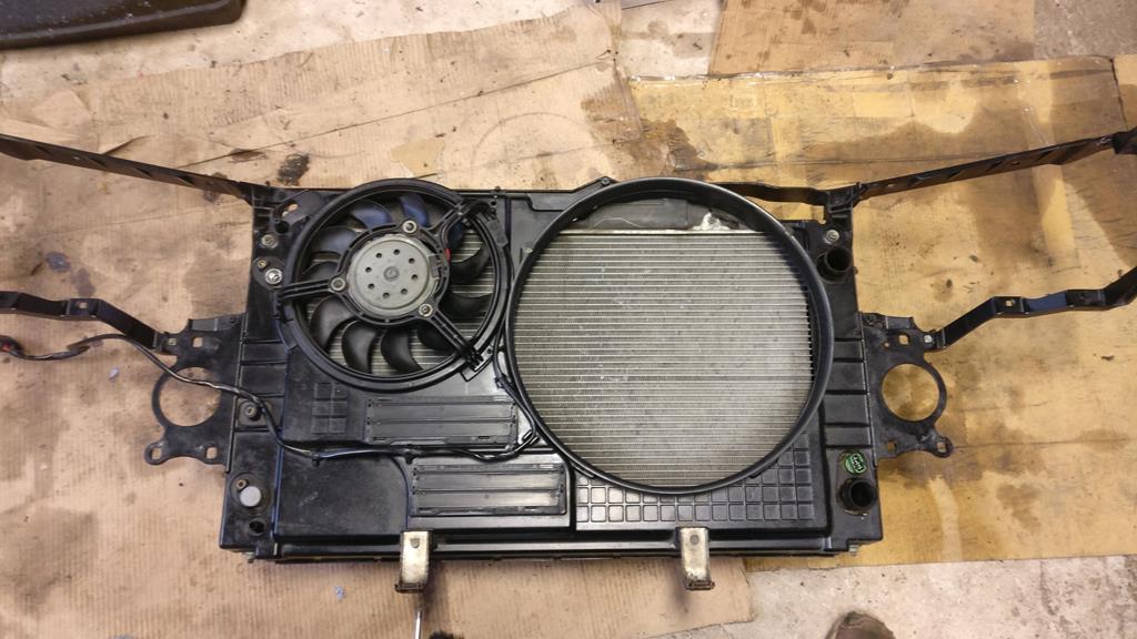

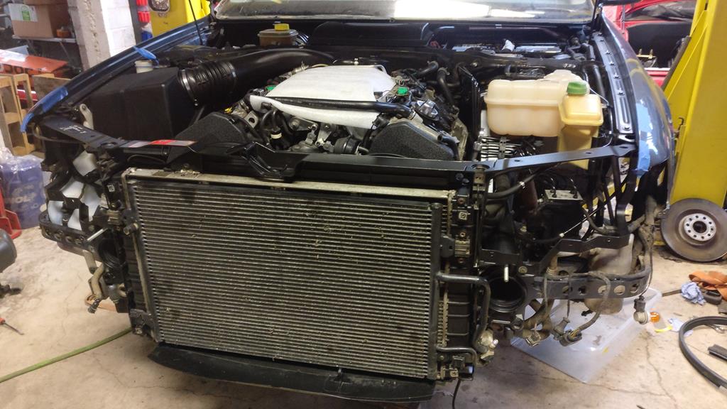

More cleaning and reassembling tonight
Front panel on tomorrow

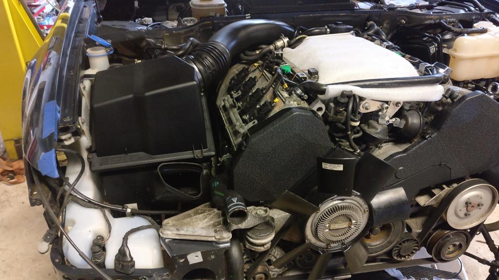

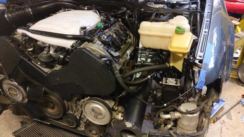

Old 9th June 2021, 07:27 PM
Cleaned up and reattached the front panel
Power steering cooler on tomorrow then I can fill it with fluids and start it up

  #85
Old 16th June 2021, 10:43 AM
Yes, its the front bit with the two black pipes to the right. I don't open the AC for this job - I just swing the condenser off to the side. The AC is still nice and cold
