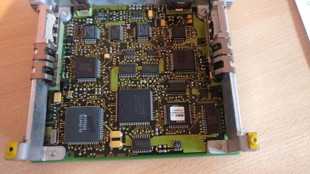

So, dumb question here, is this the engine ECU or the gearbox?
Engine ECU. With the manual swap the gearbox ECU will go away

Turns out the eprom is a surface-mount 27C1024 so I'm not messing with that - I don't have the gear to remove and re-fit it. Bottom right with the sticker on it.

I do have the tools to remove it and put it back on and I'll be passing by your workshop next week, you are welcome to borrow them or I can do it for you.
If the board has conformal coating on it it will be a pain to do it.

I may take you up on that if the ebay ECU doesn't work out, although I won't know that by next week. Its been a long time since I did surface mount work. There's no coating on the board
