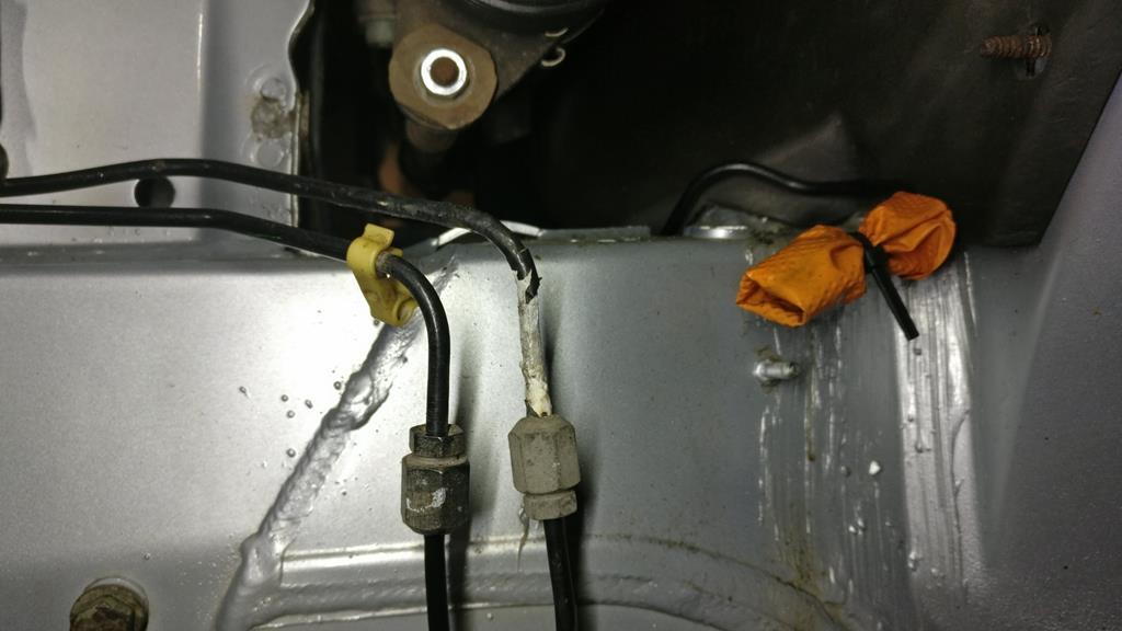

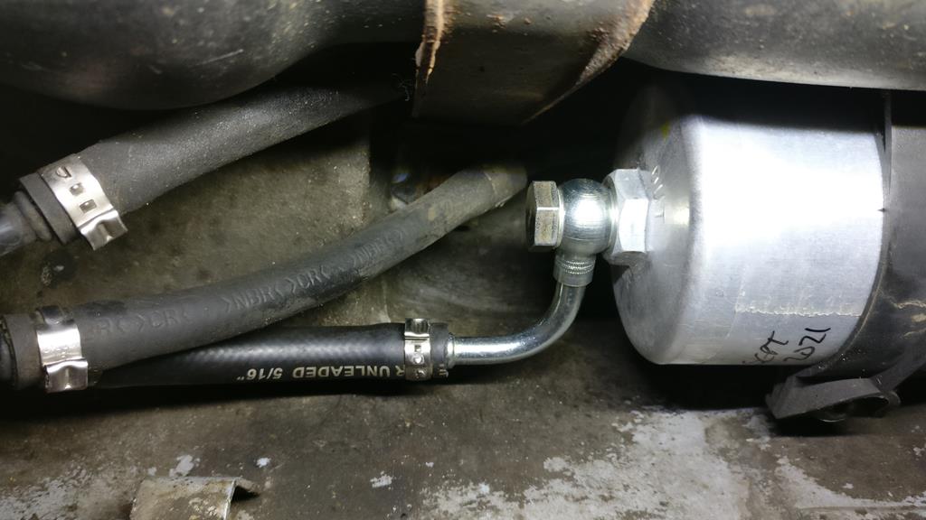

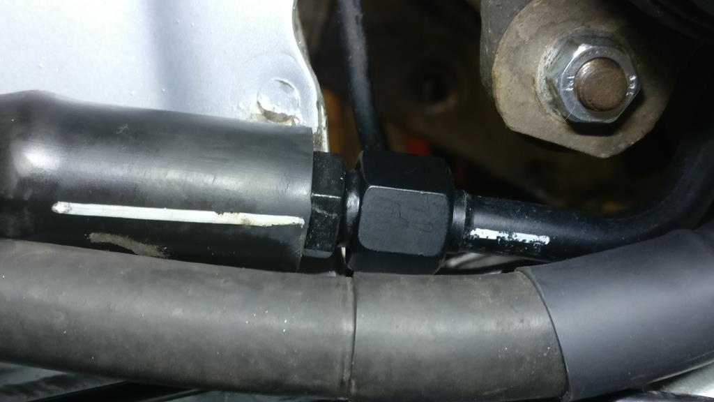

Fuel line clips all replaced
The fuel line from the filter was very crusty so I replaced the banjo fitting and hose, along with the filter of course.

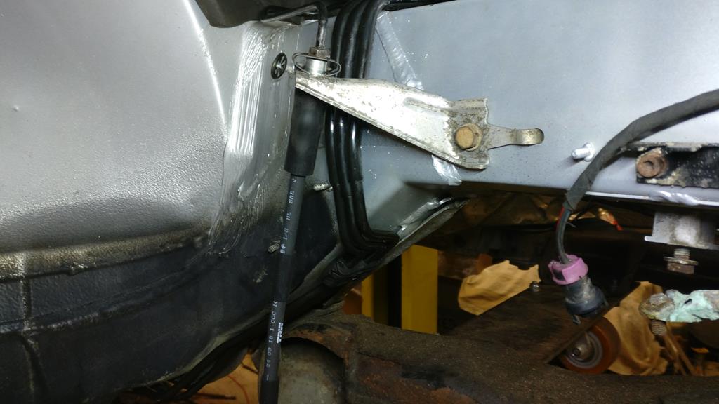

New TRW brake hoses

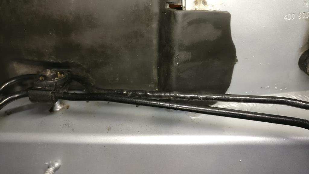

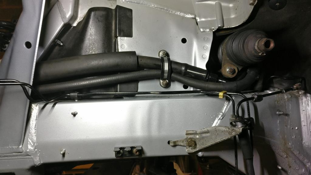

This rear brake line is very crusty so will also be replaced

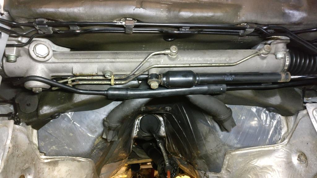

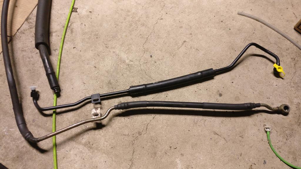

Brand new rack-side PS pressure hose, plus refurbished front pressure hose and return.
Fitted
Nice of Audi to put marks on pipes so they can be lined up

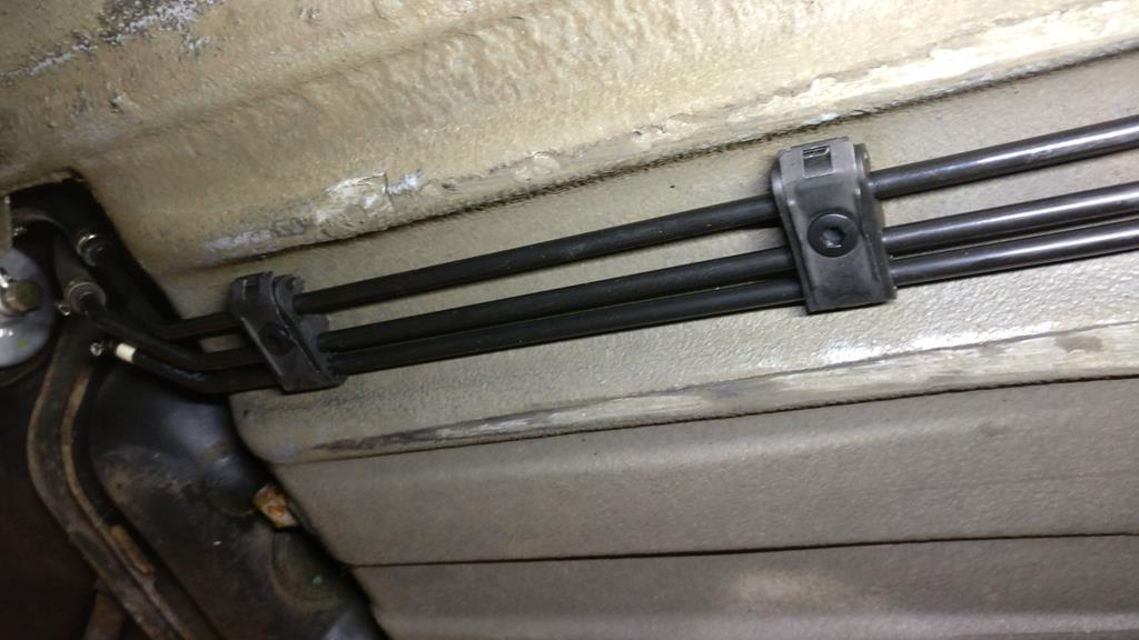

PS hoses fitted with a new clip, and the replacement brake line also in place.

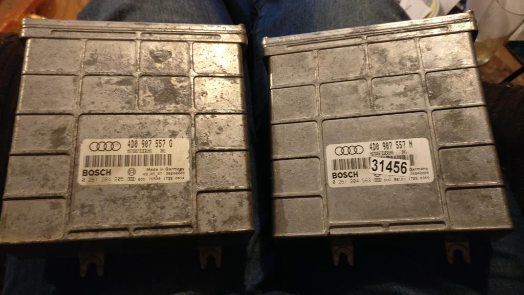

Manual ecu on the left, auto on the right...
