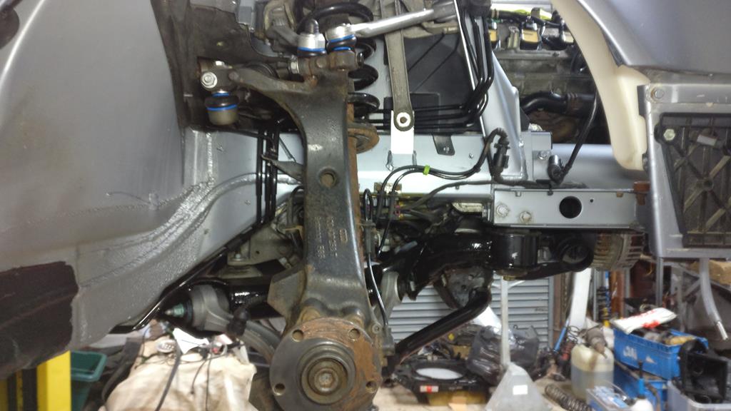

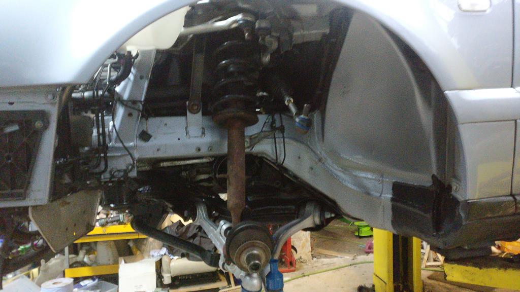

A vexing and unproductive day today. I started putting the suspension back on, and then discovered that the springs I was going to use are not in as good condition as my ailing memory thought they were, so they will need to go for powdercoating next week. I need to move the car off the lift next week though so its sitting on a spare set of struts for now and I'll swap them later.

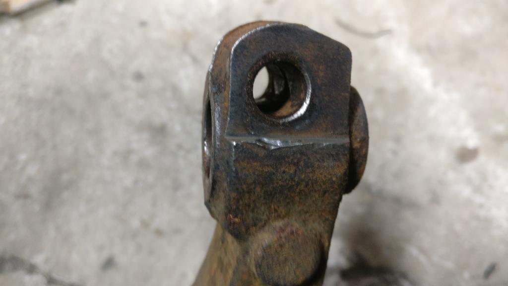

I had the upright mounted on this side right up until I tried to fit the tie rod bolt, whereupon I discovered the edge which holds the bolt head has been smushed in the past and no matter what I tried I couldn't get any torque on the nut This will be going to my local tig welding specialist tomorrow to get the edge built up again.
It took a little while to get the pinch bolt out of the other side and then I was at least able to assemble that
This is how the B5 arb link sits with the suspension on full droop, so its easy to see why the D2 links look ok when fitted.

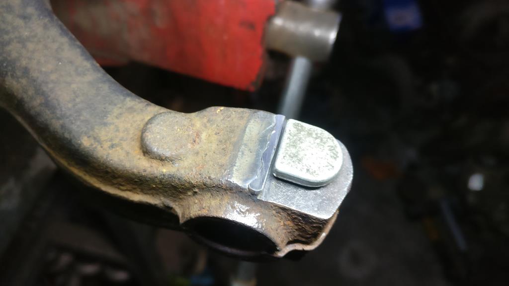

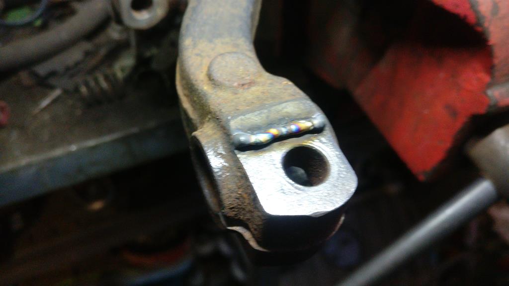

I got the strut back this afternoon with a tiny bead of weld on the formerly-smushed edge
A quick dress with the grinder and the bolt fits perfectly again

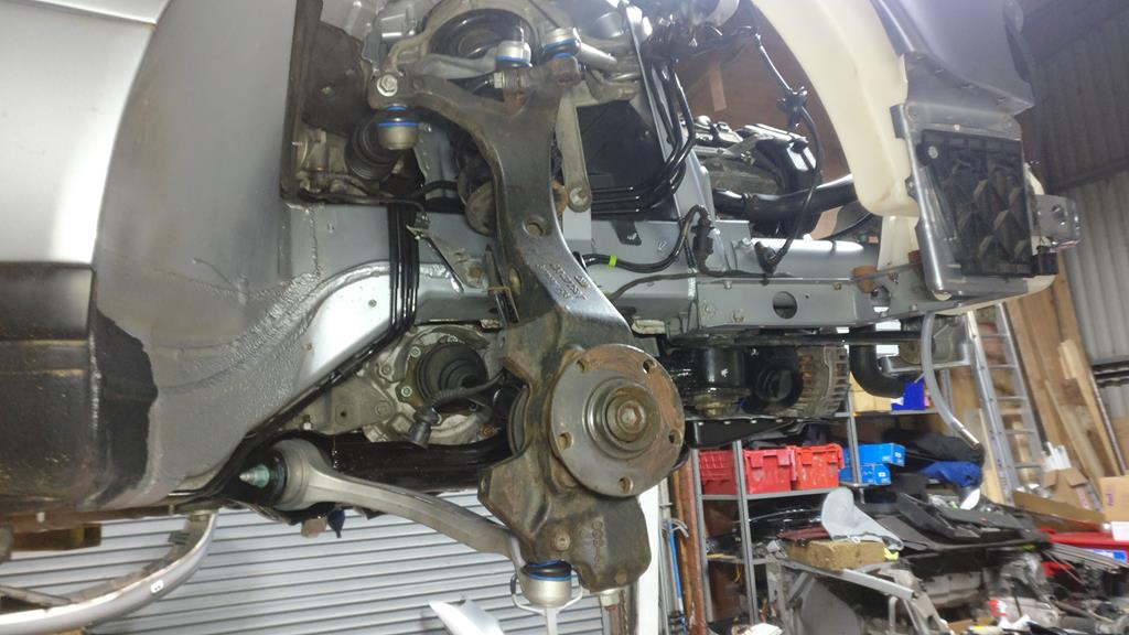

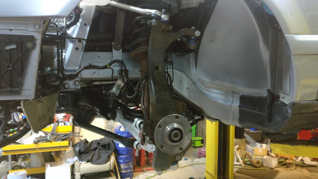

Mounted on the car again
I put a bunch more stuff back in but forgot to take any pictures. Hopefully brakes and front panel back on tomorrow and then I can fire it up

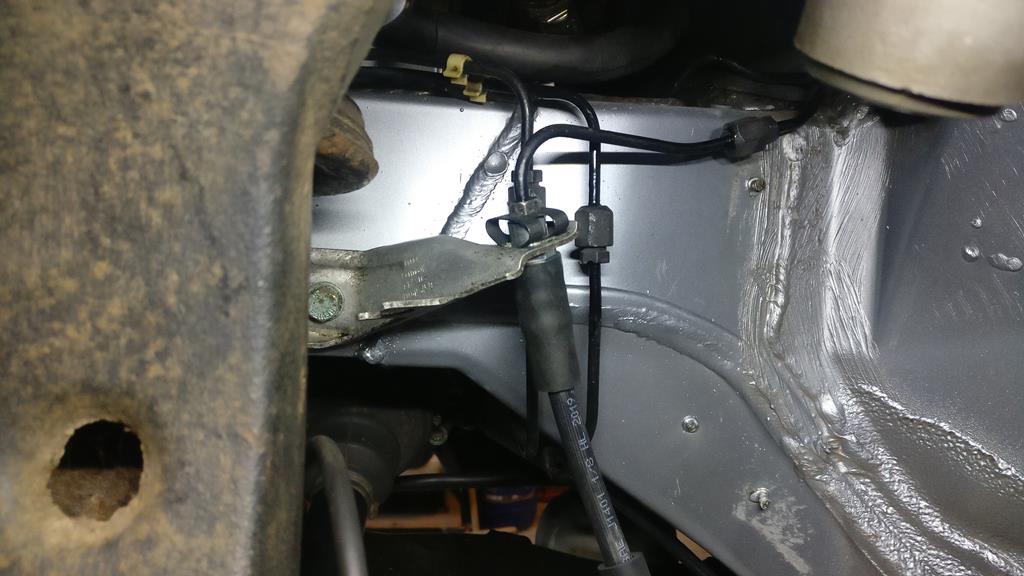

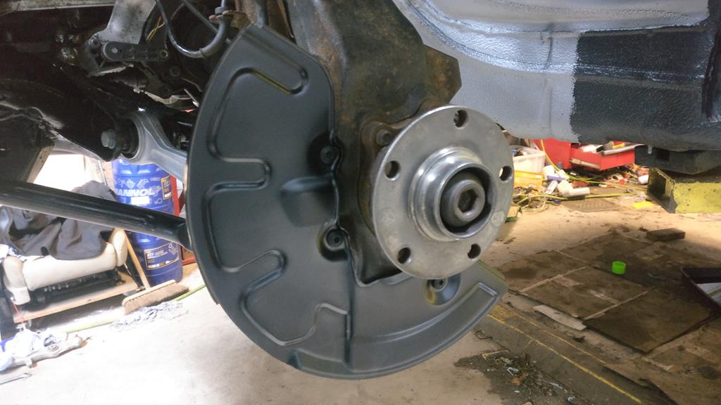

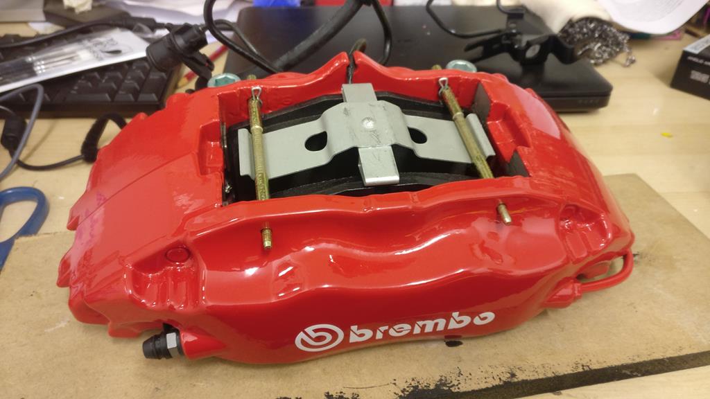

Pretty caliper
New splash plates and bolts. The D2 bolts are NLA, but later models use an identical bolt with a slightly different number, because of course they do N90598804 for future reference.

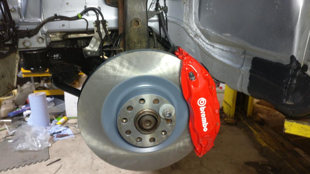

Febi brake disk and hose, TRW pads, Apec fitting kit
New hose and clips obviously
This would have gone a lot better if I remembered to bring the other caliper from home Never mind - that can go on tomorrow.
