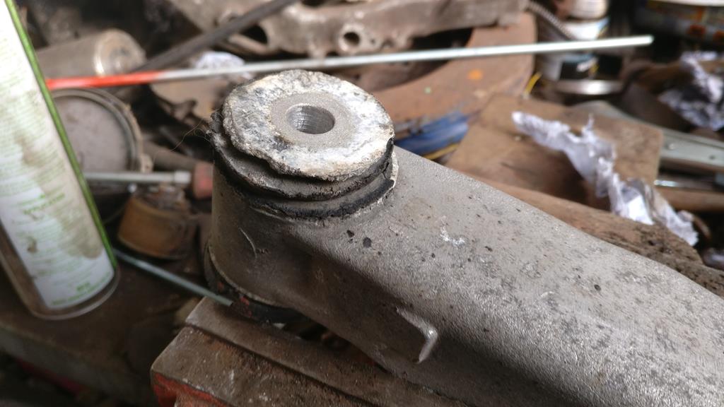

Is that bushing squished like that due to the removal process or like that when removed? If its like that when removed is it due to the arm being fully bolted prior to the car suspension sitting normally, therefore under stress?

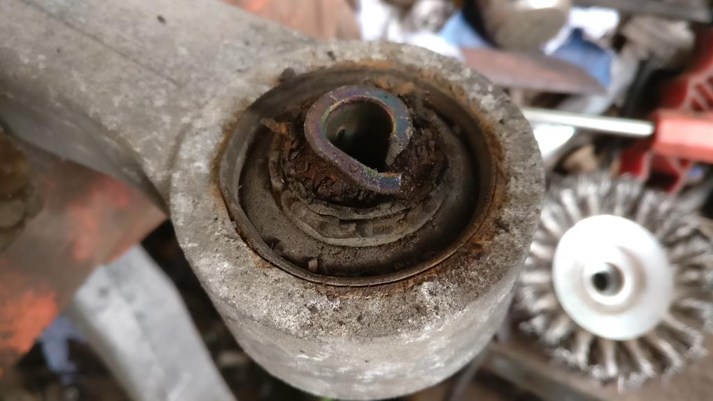

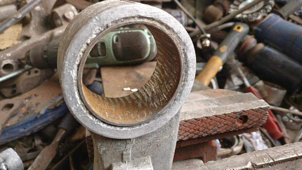

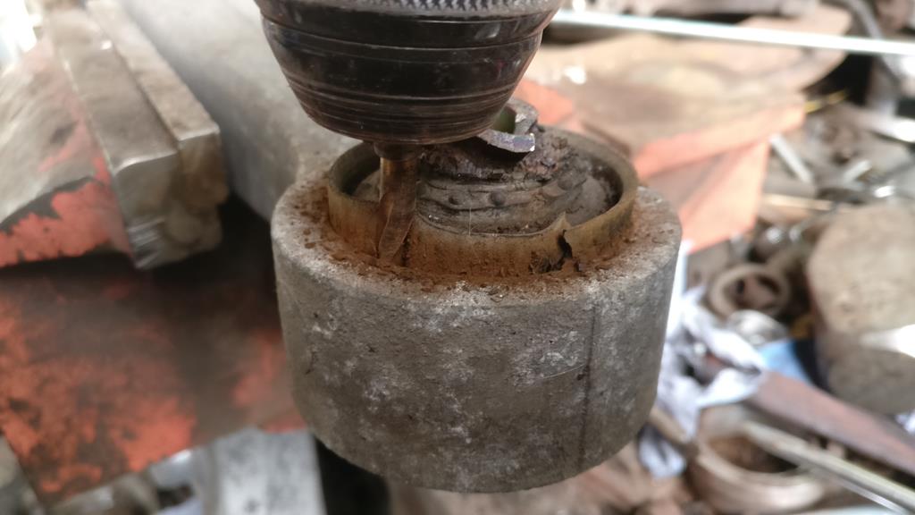

The outer edge being mangled is because I run a drill down it to separate the rubber from the metal sleeve. Usually they are already separated most of the way round, so the drill just finishes it off so it pops out. The small chunk missing from the sleeve at the top is from me trying to lever it out before releasing it with the drill.
I'm doing the opposite lower arm this evening so I'll get some more pics.

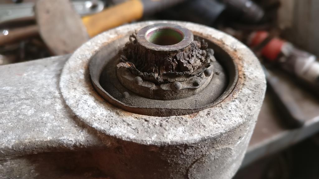

This is the other control arm. This is the split bushing, the centre of which just pops out with a screwdriver
This is the other one. You can see how the rubber is detached from the outer sleeve
Not detached enough to pop out though. The sleeve is so corroded that it just splits with the torque from the screwdriver
Drill round the edge - this was so bad it needed a single hole, and then the drill pulled itself all the way round
Removed
Sleeve left in place

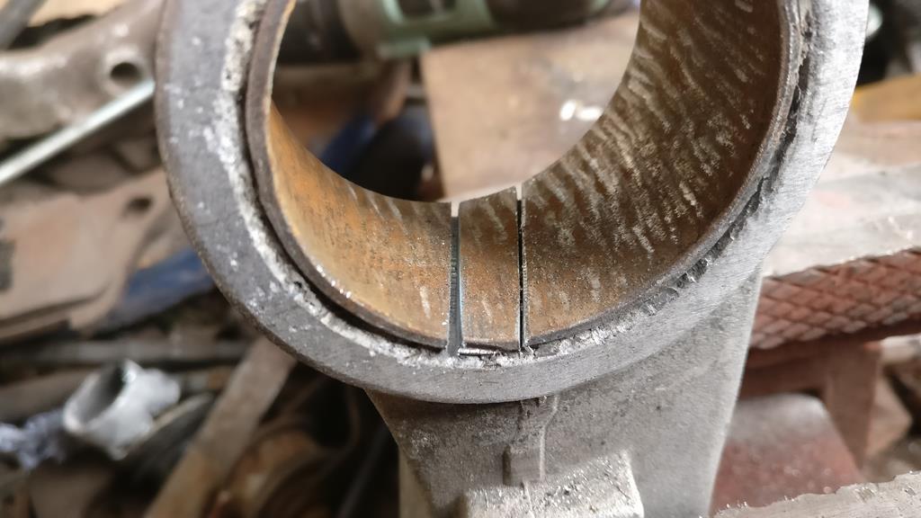

Saw through it to relieve the tension holding it in
Sometimes one cut is enough. In this case it wasn't so I made a second cut and then punched the middle bit out, then the sleeve came loose and popped out.

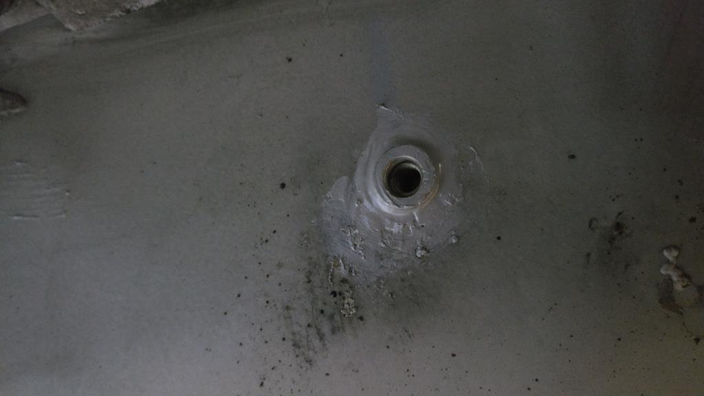

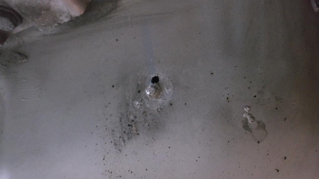

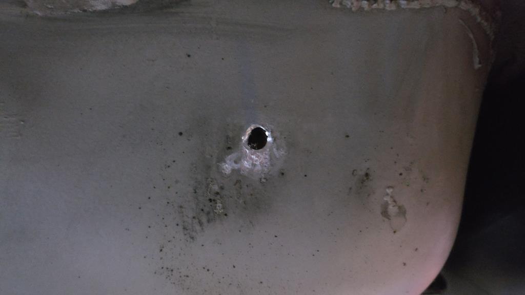

On to the floorpan, prepping for the subframe to go back in. This is one of the holes from the self tappers used to hold the heat shields on, now with a rivet and seam sealer
Water tight

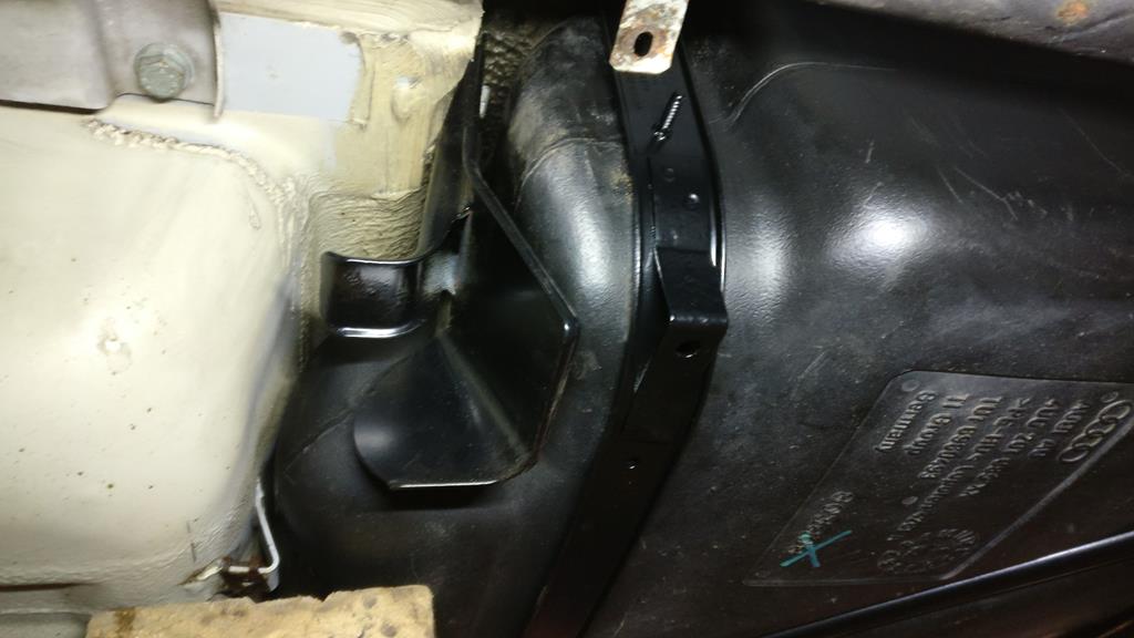

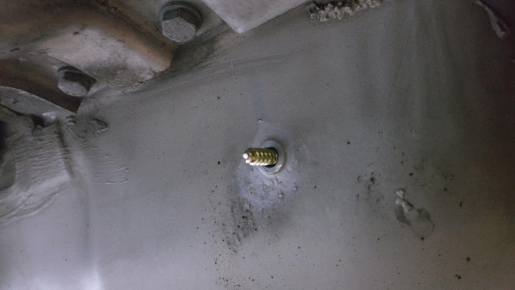

Same thing again but in the tunnel

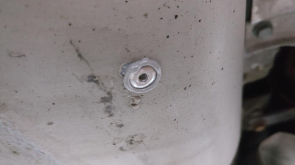

Grind off the stump of the stud, then open out the hole while pulling it down with the rotary tool
Blind rivnut inserted, again with seam sealer
and a bi-thread stud in the rivnut, held in place with blue loctite so it won't fall out, but could be removed in the future if nedessary. There were four more like this.

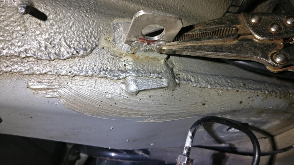

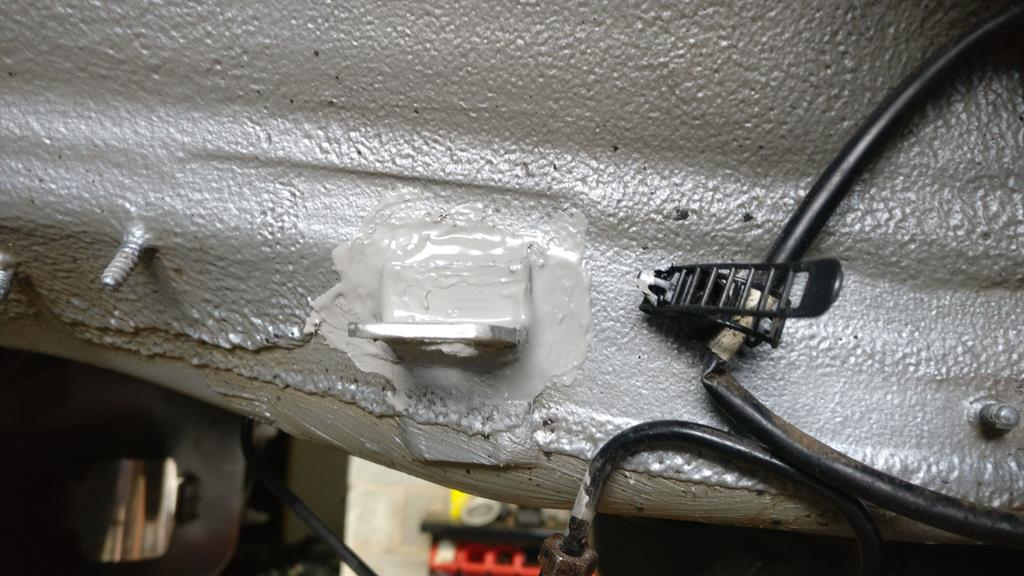

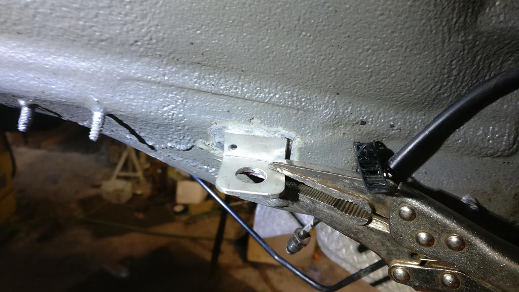

This is the new brake hose bracket which will be bonded in place. I've removed the seal sealer and e-coat behind it so its clean aluminium on both sides. The little hole is coincidental and just happened to be in the stock I was using. This piece was going to be the mockup, but it actually worked first time so the hole gets to stay and will provide extra surface area for the adhesive.

Subframe today, but I started by glueing the brake hose bracket on so that could be curing. The adhesive has a nominal strength on aluminium of 22N per mm˛. The bracket has an area of 616mm˛ which gives 13552N of holding force in ideal conditions, or 1.3 tons. I reckon that should hold a brake hose

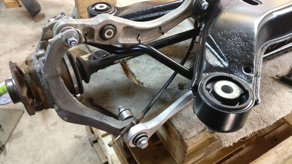

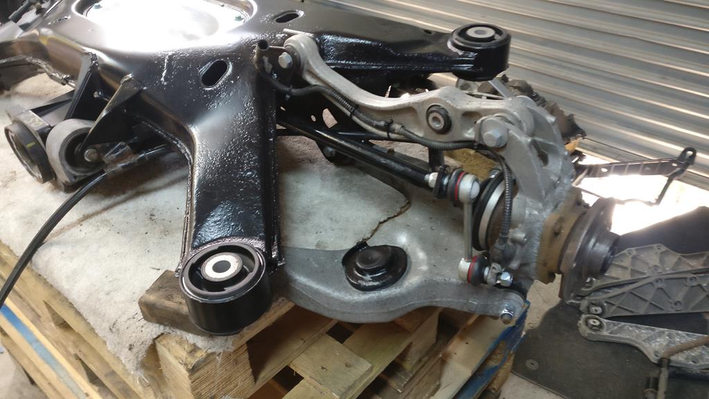

All assembled
It was about this point where my phone battery died, so no more pics unfortunately. I had to swap the headlight level sensor, and made a new arm for that at the same point. The rear dampers are painted and back in too.
There are a couple of jobs left before putting it back in the car - the diff mount bolts were on back order so those need swapping, new camber bolts as noted, and a few other bits of hardware. I'd also like to get the brakes assembled while its sitting on pallets and nice and easy to get to.
Finally, I need to make some alignment sleeves to line it up with the rear mounting holes, as the tool I made when I did Ricky D's doesn't work with the D3 bushes. Those are 20mm inner diameter, whereas the locating holes are 21mm diameter, so I'll print up some simple sleeves for these. There's no load on them as they are purely used to line it up, and being printed there's no issue leaving them in place.

I have aluminium rivnuts where they are appropriate, and considered one here but I don't have a reference for what's behind this sheet metal so adhesive was the way to go.

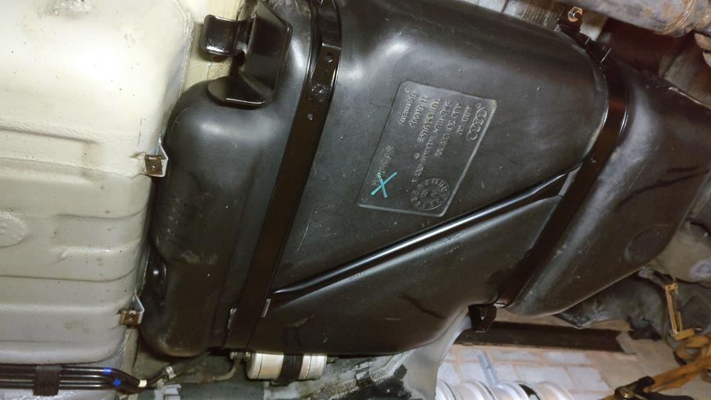

Now covered in seam sealer

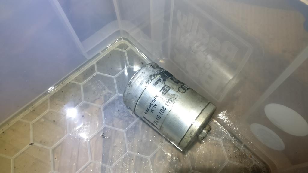

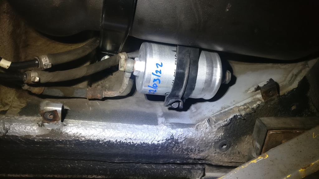

New fuel filter
The old one was dated 2002 so likely the original
This is the D3 camber bolt which is 10mm longer than it needs to be. Its ugly but it does the job.
Changed at recommended intervals
I wonder what it looks like inside?
