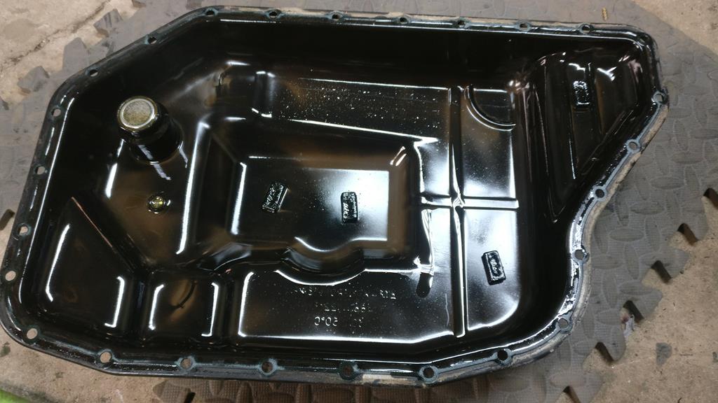

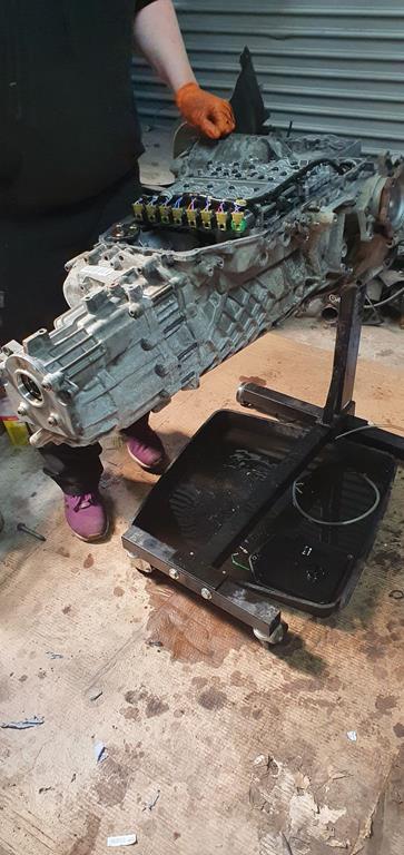

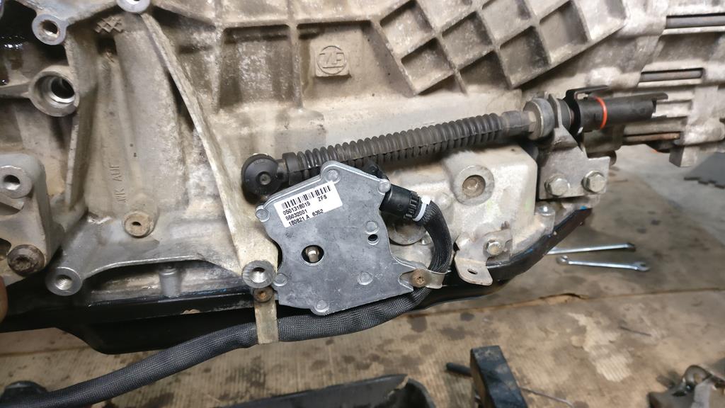

Sunday's update on Monday. Mike came over and we did the gearbox service and reseal.
Clean sump pan, although the magnets are in the wrong places.
Not much magnet fluff which is good.
Sump off and filter removed
Prime the oil pump inlet

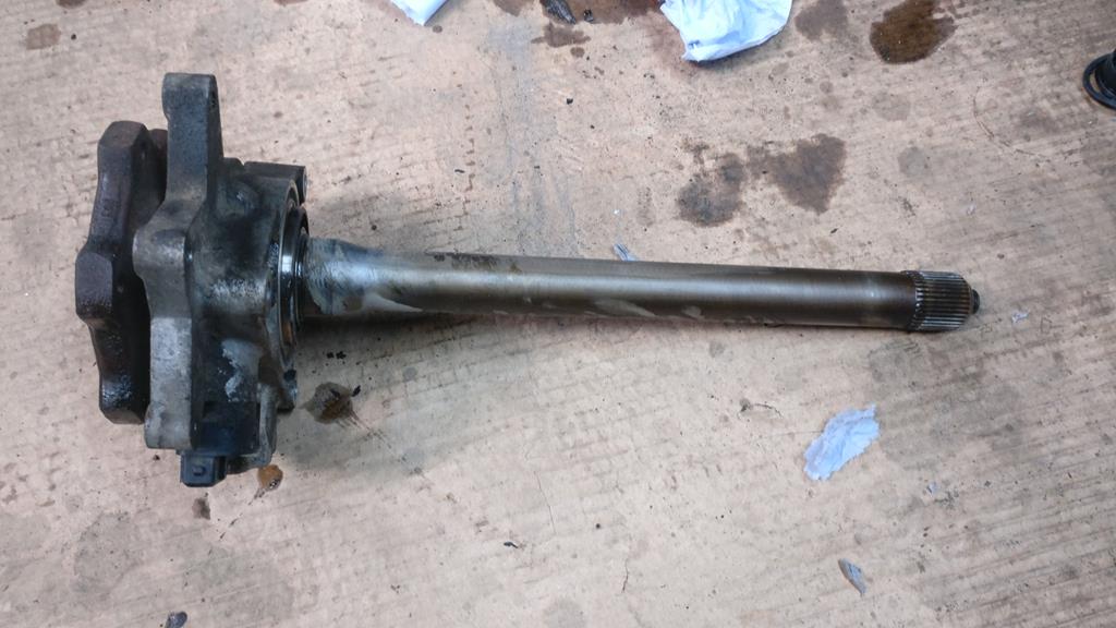

The left output flange was leaking badly

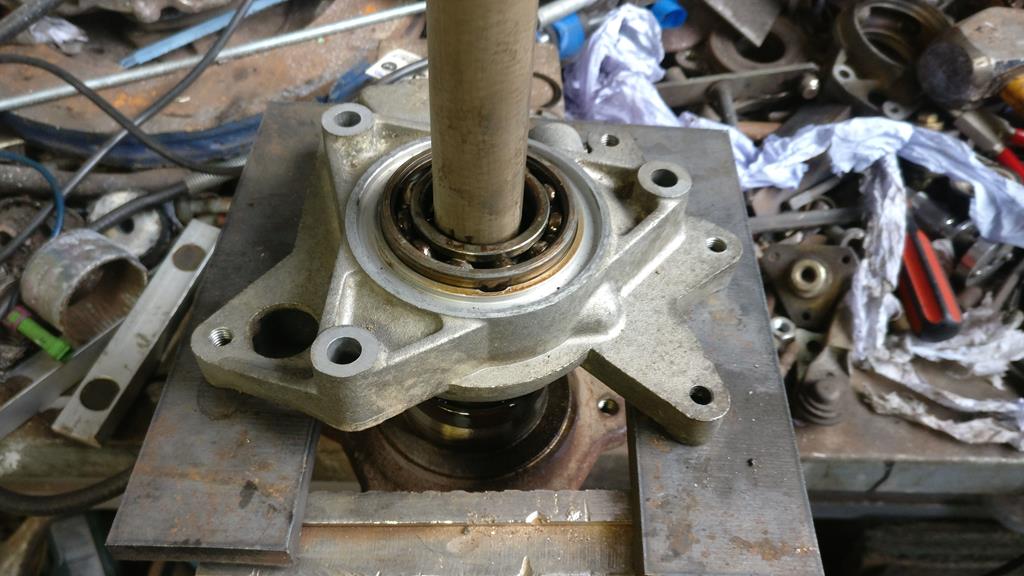

This is held in place with a bearing and circlip
Press tool to spread the load while pushing the shaft out
It sits in the vice like this
Pushed out. I can swap the seal and bearing, then put it back together
New F125

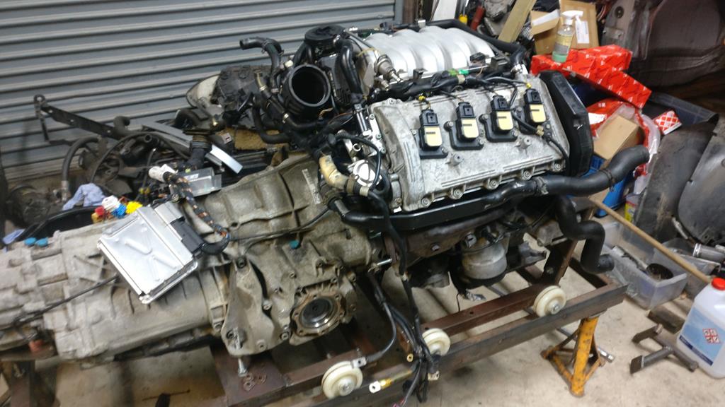

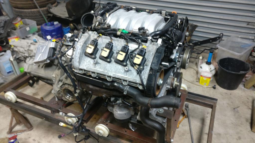

Engine and box back together
This evening I cleaned up and refitted the wiring harness and coolant hoses

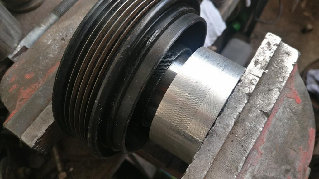

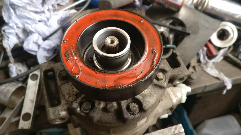

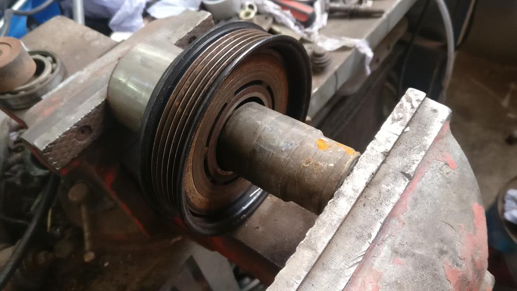

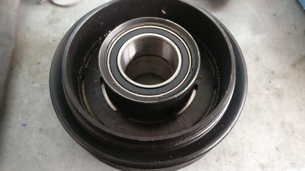

The aircon pump pulley bearing is worn out and grumbly but I've had enough of replacing compressors just for this, with all the faff around emptying and refilling the system. So, replace the bearing...
The pulley is just held on with a circlip so slides off easily enough

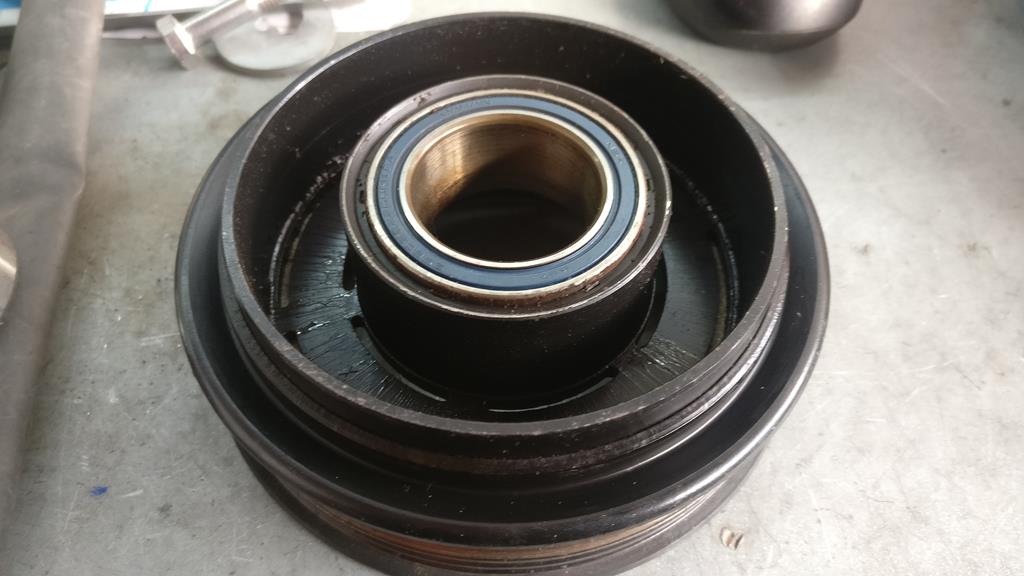

The bearing is pressed in and then staked to make sure it doesn't come out
The usual contrivance of round chunks to push the old bearing out
and to push the new one in
This can be swapped for the one on the car after the engine is back in

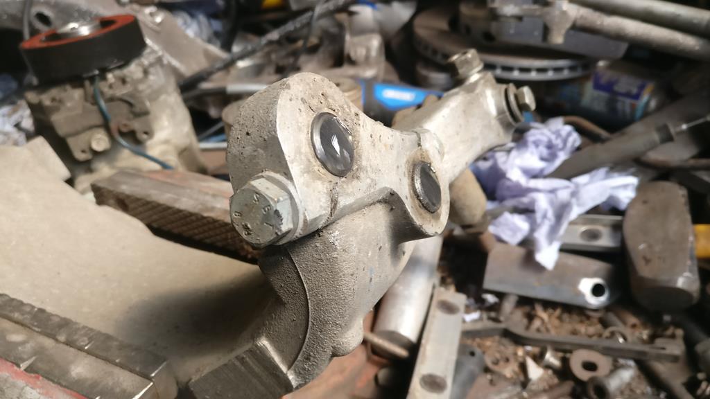

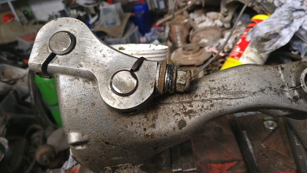

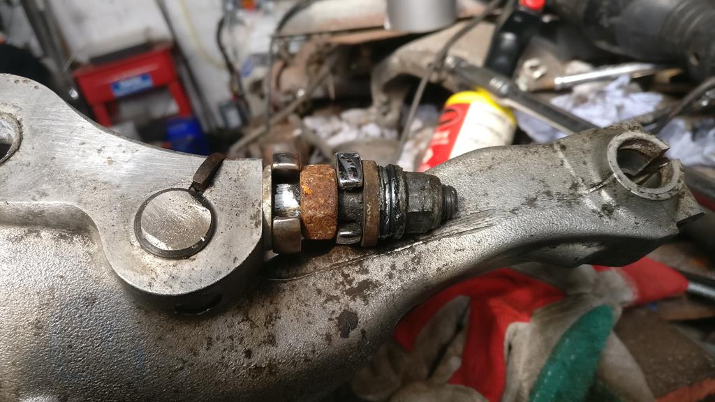

Working on the uprights today. Start by cutting the top arms and tie rod end off to make access easier.
The bolt was obviously seized so I snapped the head off and started jacking the stump out using the nut instead
Keep adding washes and spacers until its almost out
The remains

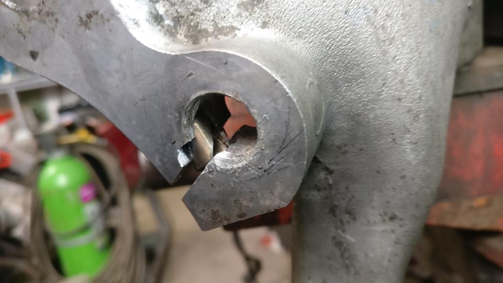

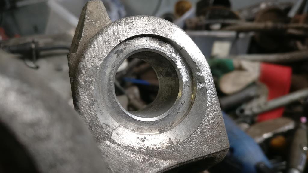

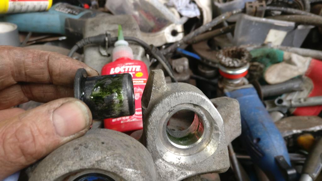

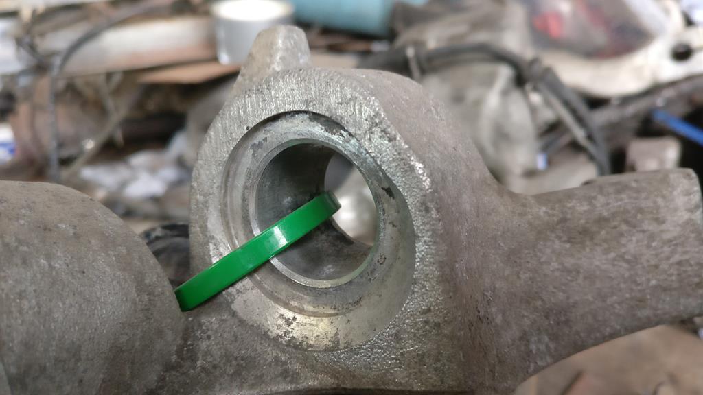

This is where the insert came out. Someone has attempted to break the taper by hitting it with a hammer, as is often the case, and bruised the aluminium housing which has distorted the hole slightly, loosening the pressed-in insert.
Cleaned up with the rotary tool
Loctite 638 to hold the insert in permanently
Bolted in place overnight while the loctite sets up
The other upright was not so cooperative and the bolt snapped at both ends, so I'm going to have to drill that out tomorrow

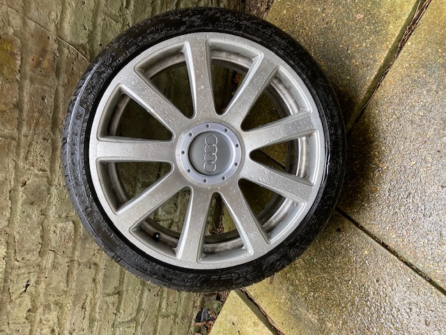

Little bit of trivia back at home. Had the old and cracking MPSS 20" spare tyre replaced with a newer part-worn MPS4s that I had "lying around".
It had a strange nick in the rubber near the bead caused when one of my wheels was damaged on maybe a kerb or rock (repaired long ago).
The tyre guy reckoned as long as it seated okay and held pressure (it did) it will be fine, certainly as a spare.
The car went down to Devon on its 18" Avus winter wheels but carrying 4*20" FE wheels with MPS4s tyres on. (Two in the boot, two on the back seat)
They will be fitted, along with brand new OEM centre caps, for the final detailing. And for subsequent admiration ....

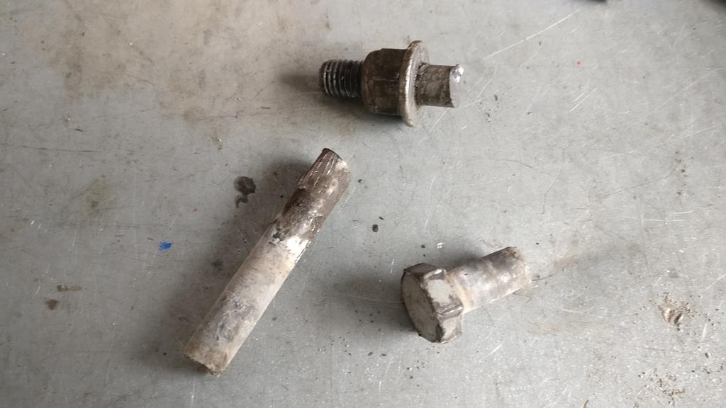

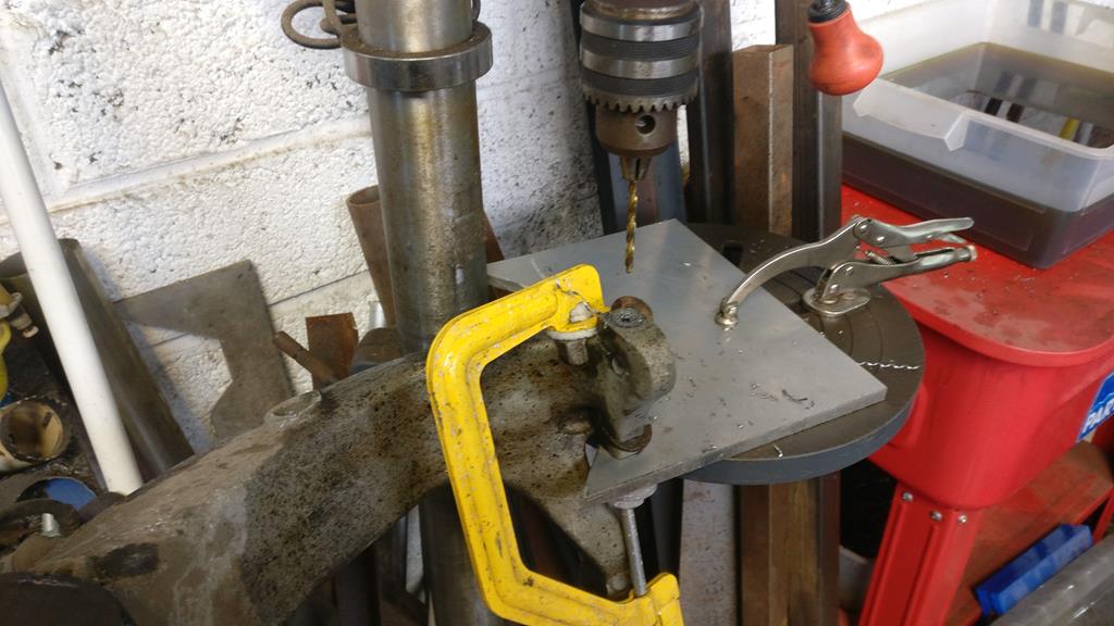

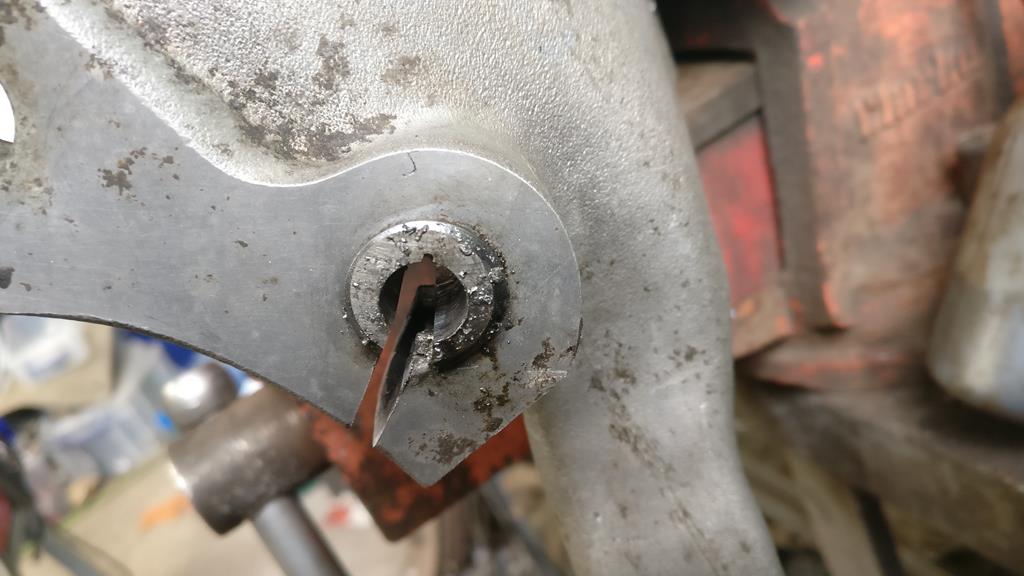

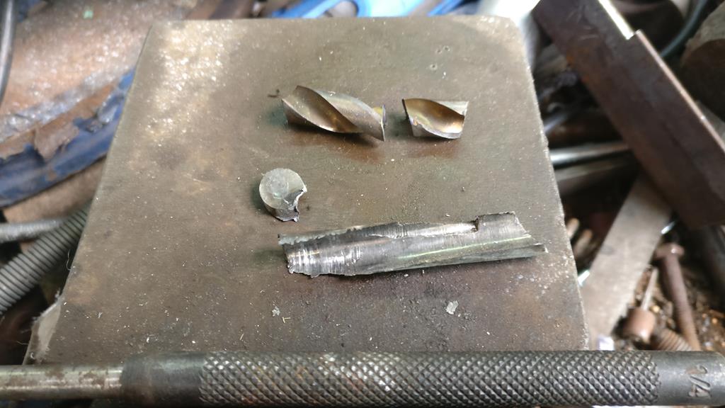

After a trying day with one pinch bolt yesterday, today went from bad to worse The bolt would not respond to the usual techniques so I had to drill it out
This was going reasonably well until the 9.5mm drill bit caught the hardened balljoint pin and snapped off deep in the hole

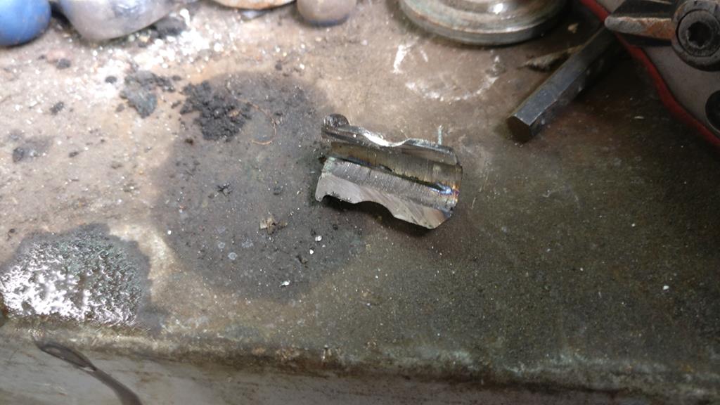

I had to get the balljoint pin out to go any further. Drilled down the centre of it
Then used a cutoff wheel through the slot to cut it in to pieces
It came out in chunks
I was able to free up the drill bit, although it took a small chunk out with it - that'll get welded up before it goes back together

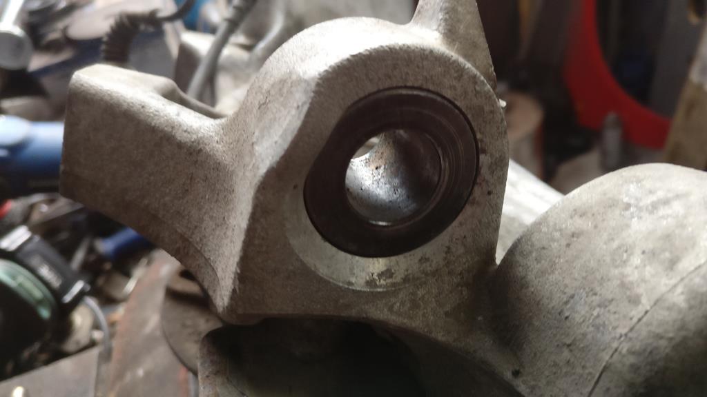

This upright is bruised around the lower arm inserts as well. So much so, in this case, that the sleeve is now captive

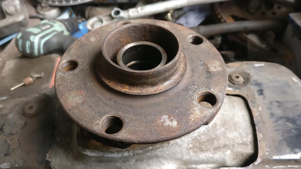

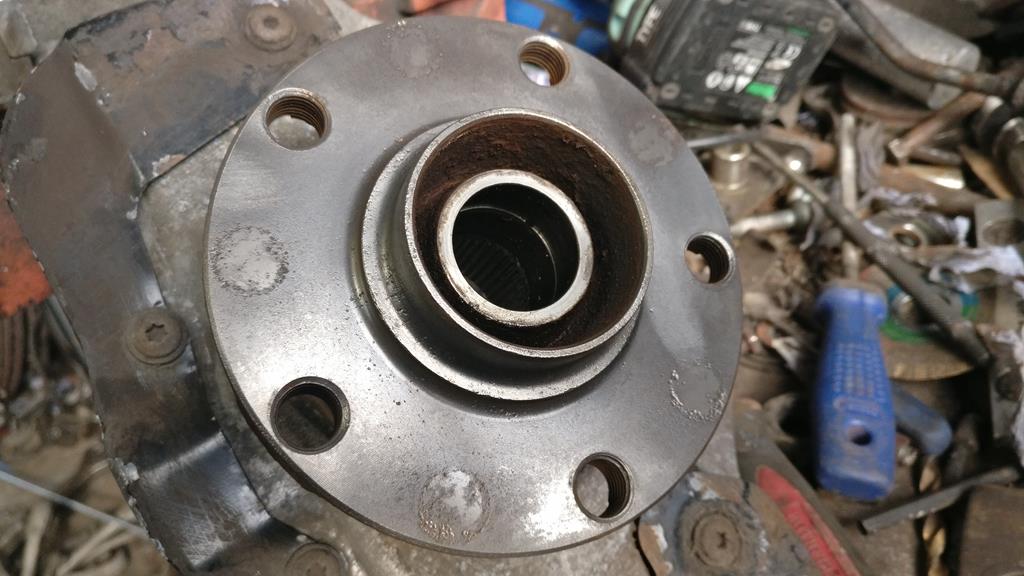

The hubs were quite rusty and rough which could cause wheel balance issues
Cleaned up
How on earth could that happen? I'm not aware of any work in that area on either side in my ownership!
  #49
Old 15th May 2022, 08:07 PM
Oh dear. It might be fighting back, but we know who will win.
Someone has attempted to remove the control arms without knowing about how the alloy uprights work. The traditional way to remove a taper from a steel housing is to give it a solid whack with a lump hammer. This briefly (in steel) distorts the taper and the pin pops free. The unworthy frequently try this on aluminium only to find it doesn't work as the pins are in the steel inserts, and from time to time simply pound away at them until they are smashed and then tell the customer its broken and they need a new upright (happened on FB recently).
The aluminium uprights must be dismantled with a special balljoint splitter when on the car. I take the whole corner off and then hit the nut with a hammer which pops the joint free, but you can't do that easily on the car .
