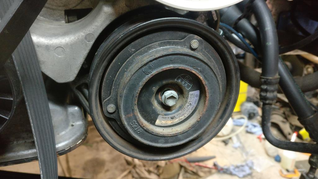

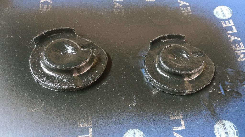

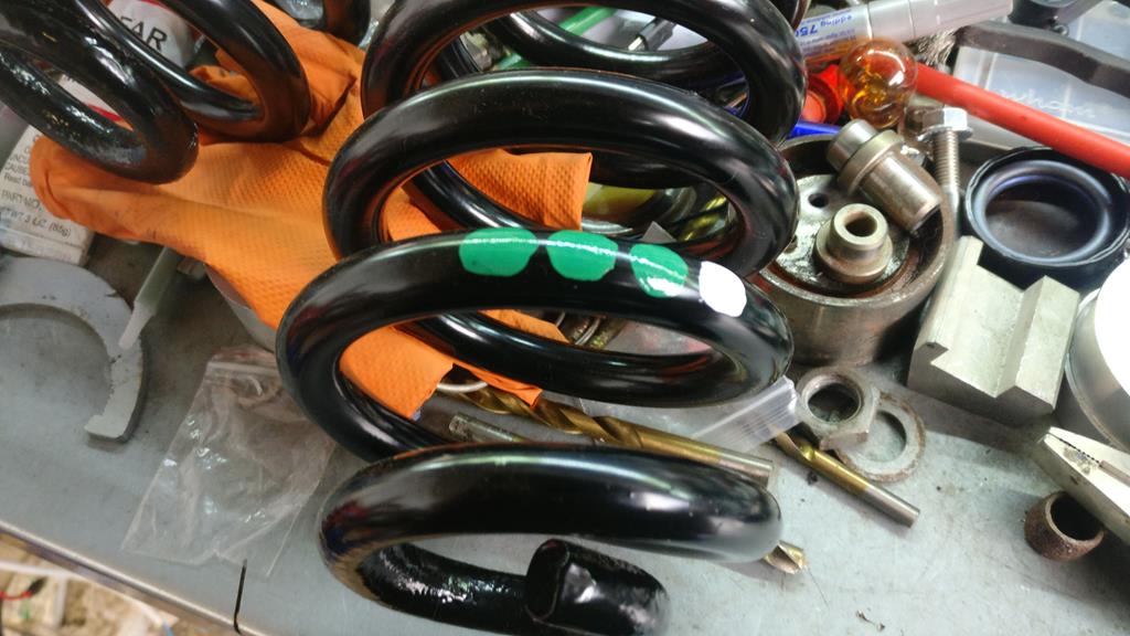

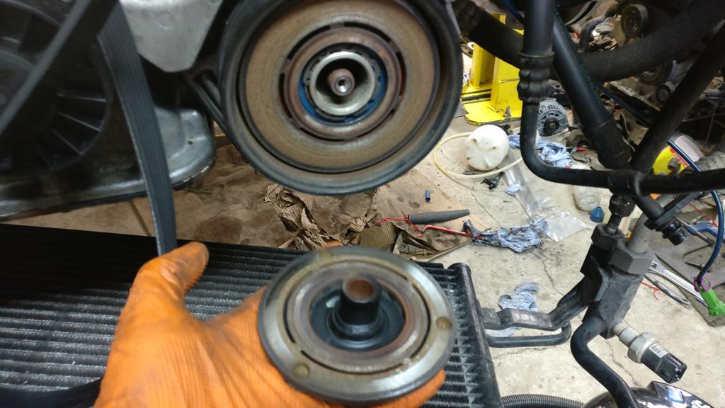

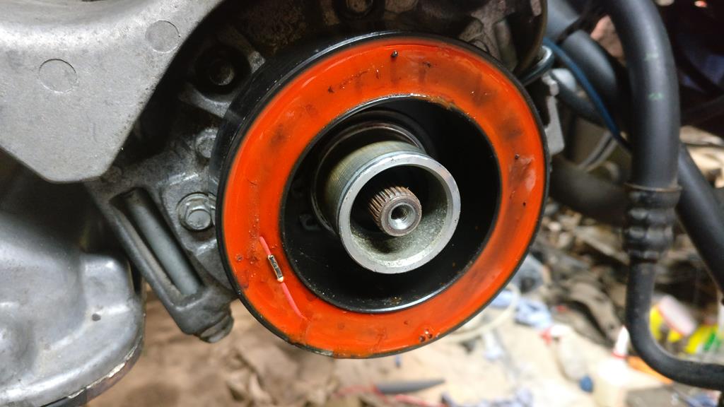

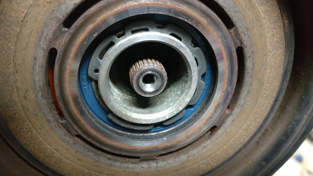

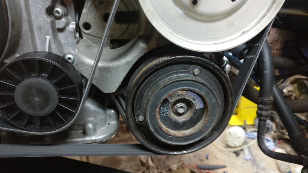

Slowly going back together, a pic dump of a few things.

that AC clutch is really like a small CC motorbike clutch
  #74
Old 27th May 2022, 07:28 PM
Except magnetic

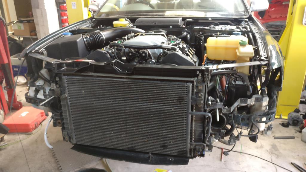

Ready for the front panel to go on in the morning:
Apologies for the potato-cam picture quality. I dropped my phone recently and cracked the lens on the camera so its having trouble focusing

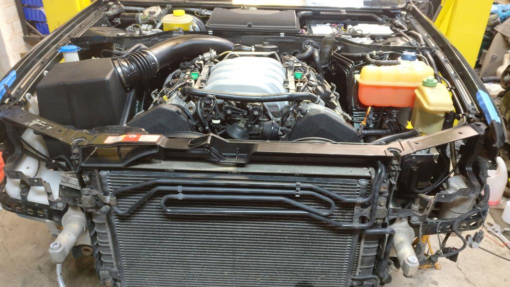

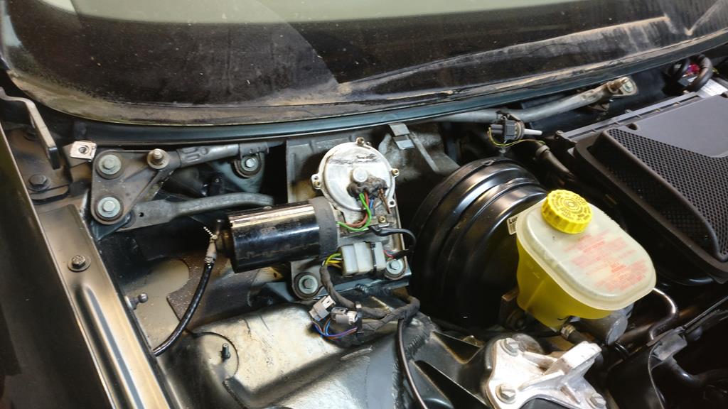

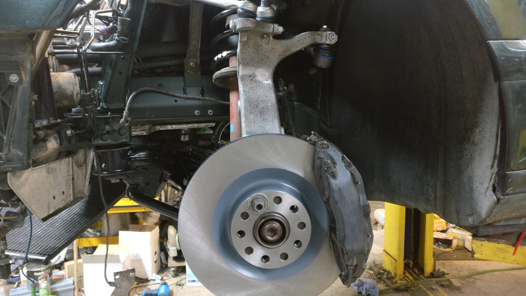

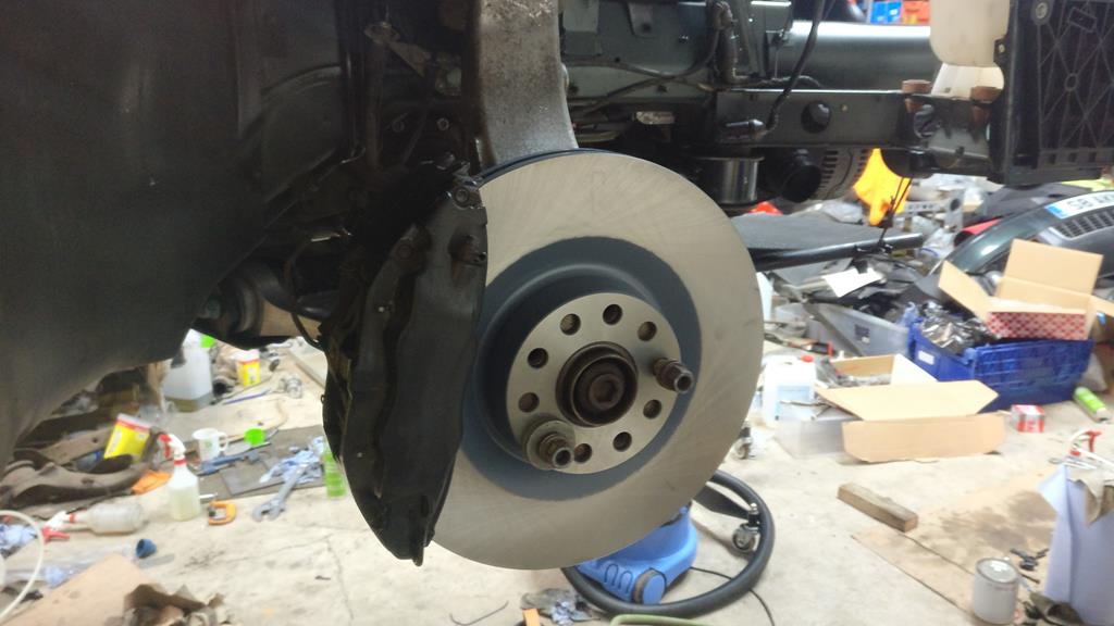

  #75
Old 28th May 2022, 07:36 PM

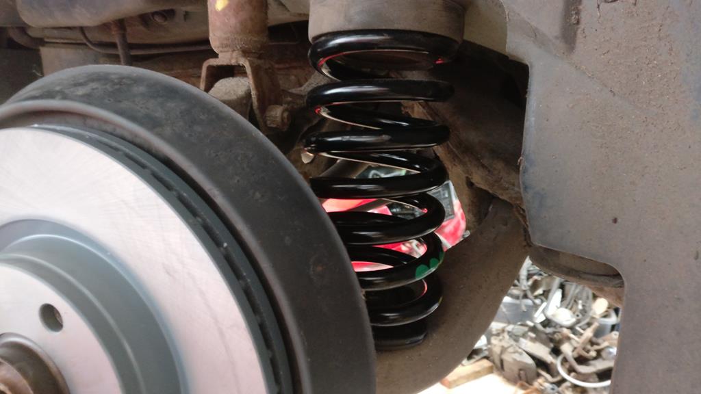

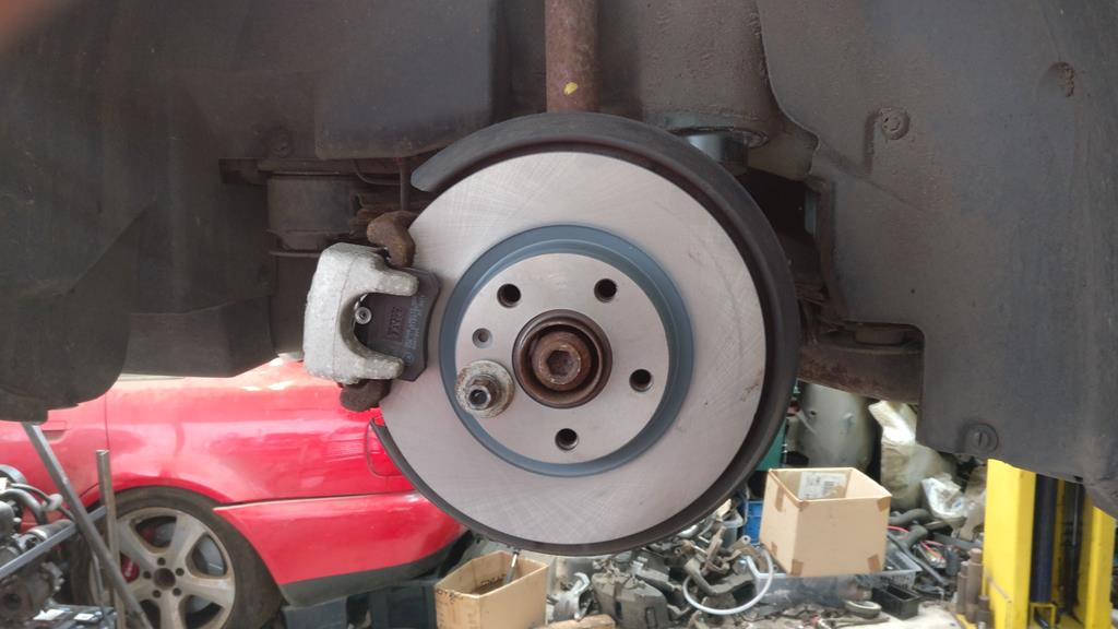

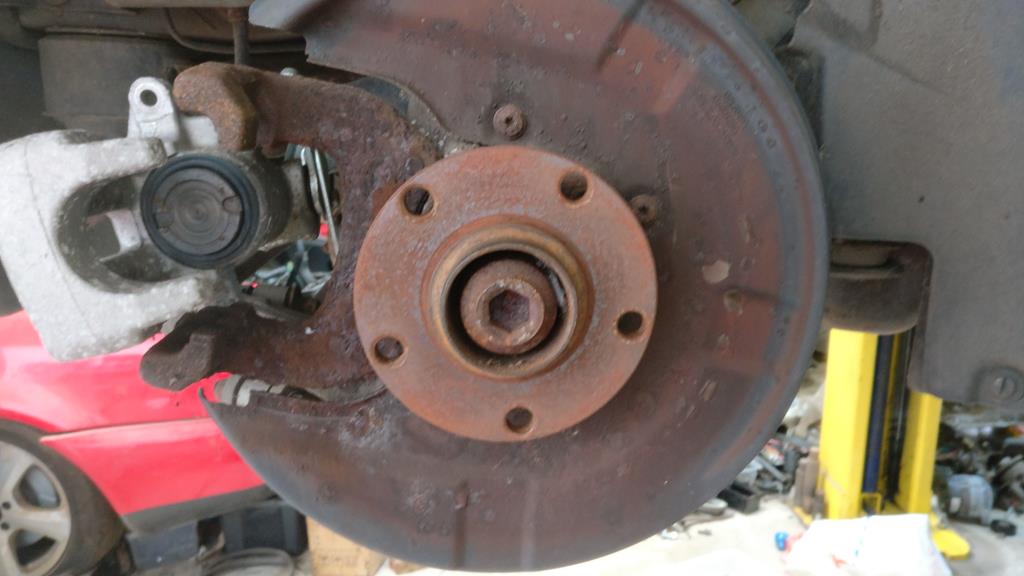

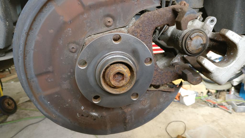

Front panel on
Filled with fluids and running again
The rear hubs are very rusty
Better
One of the handbrake cables is loose, which doesn't quite explain why the handbrake isn't working properly, but is probably having an impact
New Febi discs and TRW pads as per the front
The rear spring platforms cleaned up nicely
Springs back in place. I am planning on doing the rear bushes after it comes back from Nicola.
The centre wiper spindle is very badly worn, so much so that I can't even get it apart. I don't have a solution to this yet though so I just had to grease it thoroughly, along with all the other joints.
Back in the car - much easier with no bonnet!

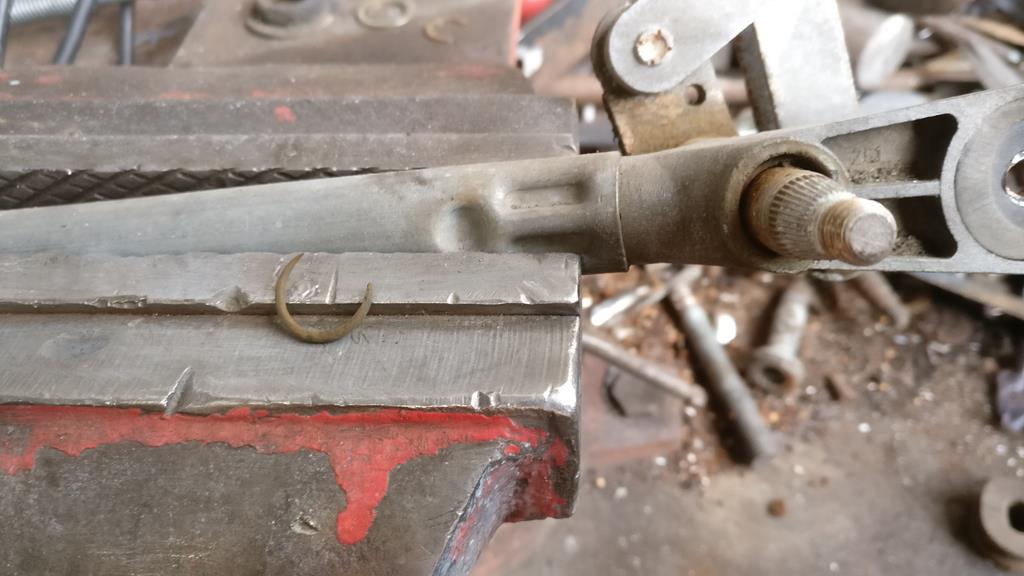

Very common problem on Tesla's that spindle bushings wear out, so much so that wiper arm rubs on bonnet. I bought a cheap worn out mechanism on eBay and replaced old worn out steel bushes with bronze bushes. Spindle it self was not worn too bad plus I used longer 14mm bushes instead of original 10-11mm long so they cover unworn area on spindle. With original bushes there was about 6-7mm space in the middle between them and with replacements there is only about 1-1.5mm between them. Had to drill out opening in mechanism from 17mm to 18mm for replacement bushes.
This is what I used https://simplybearings.co.uk/shop/p2...duct_info.html
  #79
Old 29th May 2022, 07:31 AM
Its surprising modern cars are still having issues with this.
Unfortunately the D2 spindles tend to wear very badly as they are chrome plated, which wears / rusts off, and then the spindles go oval The D3 spindles appear to be hardened and are longer than the D2 ones so I'm hoping to be able to put D2 arms on D3 spindles, replace the bushings, and fit balljoint linkages. When I get time...
