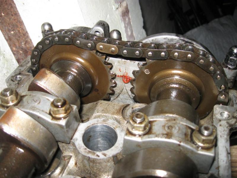

>> running idle it sounds like a diesel engine
Camshaft chain tension is maintained by oil pressure in our engines AFAIK.
If oil pressure is not that strong enough at idling, then chain starts to rattle. When RPM goes above idle, the oil pressure becomes strong enough to tension chain properly. Change oil pump and problem should disappear.
But it's a petrol engine so will be cambelt - yes?

Each bank of cylinders is driven by 2 camshafts (V8 has 4 camshafts) , the first camshaft is driven by the cambelt whereas the second camshaft is driven by a chain that connects both camshafts together inside the head.

Right. These two chains are located on the back side of the engine. So if engine sounds diesel when idling the first thing is to chech the sound of back top side of cylinder head, not the front side where all pulles and belts are.
If these are chains, than it's almost 100% low oil pressure at idling. Warning lamp still doesn't come on, but it is enough to hear the rattling sound. Can be further diagnosed by measuring oil pressure at idling by connecting manometer.
Subframe out, engine sump out, and check if oil pump is clogged with debris. If not, then change oil pump (plug and play operation).
His is 96 32V, no chain tensioners on 32V
