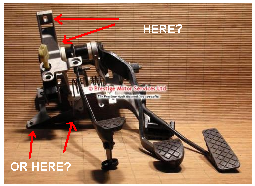

Does anyone know where the A6 brake booster attaches to the A6 C5 pedal box?
I have noticed 2 possible locations on a picture from A8 parts.
I'm trying to decide if its worth buying a A6 pedal box.
Thanks
Thanks
As I've stated earlier, the C5 A6 pedal box carries an 8D0 prefix, so it's the same as fitted to B5 A4. The brake booster on a C5 A6 attaches to the pedal box the same way it does on a B5 A4 and B5 Passat.
All completely alien to a D2.
