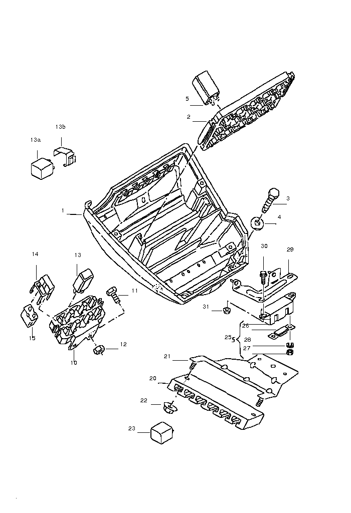

don't think its the wiring because it happened so fast. i started the engine, switched one the lights and hit the foglight switch. The green light came on for less then a second and haven't worked since.
Where can i find the relay?
Old 23rd July 2012, 10:18 PM
Its on the relay board (item 2 on the pic shown) which is under a wooden cover plate in the passenger footwell
Relay is part No 8D0907701A
control unit for fog lights and rear fog light / relay location/code no.:
3+8/397 /

found it, thanks
how do i check if its broken?

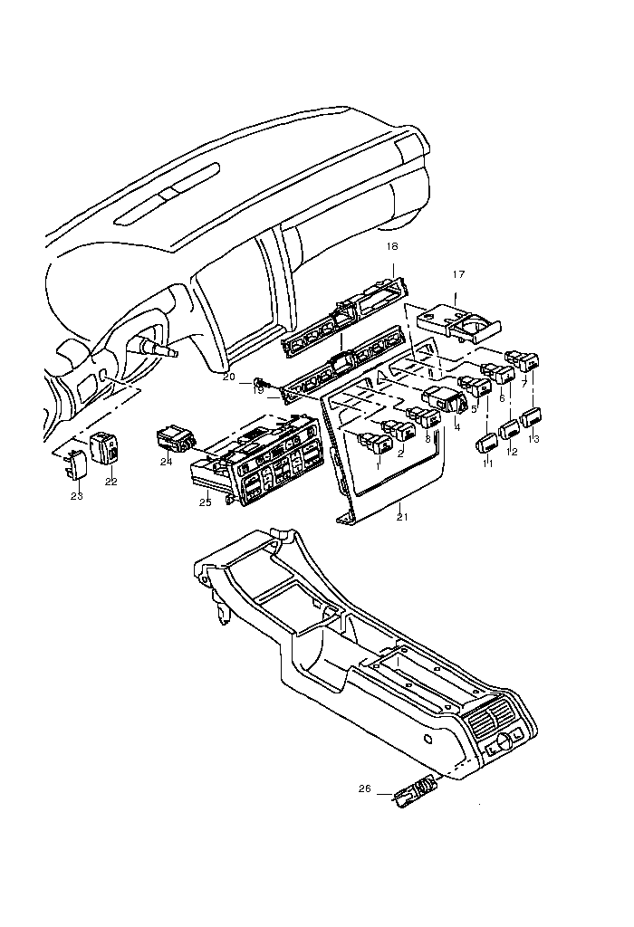

Does anyone know how to get the foglight switch out?
think the switch is broken since the rear foglight switch works.
Old 24th July 2012, 10:01 AM
its just a slow lever job with a trim tool or screwdriver to each side of the switch and it will pop out - but make sure you protect the wood carefully
Name:	Fog Light Switch.png
Old 24th July 2012, 10:09 AM
david@a8parts david@a8parts is offline
Director at A8 Parts
Posts: 133
You might find it easier to prise out the centre vent above - it is just pushed in so comes out easily without the need to undo anything - use a flat blade butter knife or similar and work it out a centimetre at a time at each end. Once you have it out there should be just enough cable on the vent to settle it upside down on the dashboard then you can simply push the switches out from behind the wood trim.
It might sound a long winded way but the switches arent that easy to get out from the front in our experience

i removed the vent and it was no problem, thanks.
Nothing wrong with the switch tho I'm all out of ideas now..
