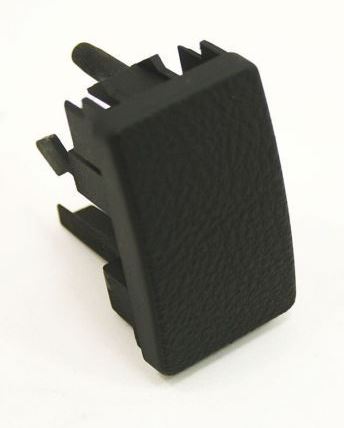

can you swap the tops over between them?
Swapping the button seems to be trivially easy, just a couple of small lugs to be pressed in to unlatch.
Funny thing is, the switch blanking plate has all the lugs on the back to connect to a wiring socket.
