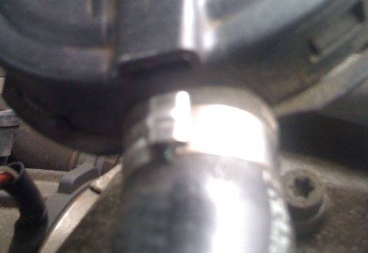

Well I've found it, but it's held in place by two, presumably original factory-fit, non-removable strong metal ties.
These will need cutting off and replacing by reusable ones, so maybe another day if I can source ones of an appropriate size. (I don't think the plastic cable ties I have will be adequate. )

You sure it's not the clips that squeeze together over a tang, if it is you can get them off with nail pliers or similar. There is a proper tool for them too, think what your looking at is the clic r hose clips. Just Google clic r pliers and you will see what I'm on about
Old 1st October 2013, 10:29 AM
Thanks, could be; I'll go and have another look. Never heard of Clic-R before.
Another tool for the collection I guess.
Edit: Yes, looks like a Clic-R, but the one underneath will be a swine to get at!

My Clic-R pliers arrived today and as the rain finally stopped I've been out to investigate the PCV valve.
Undid the clip for the side connection easily enough and eased the pipe off, then with wiggling and brute force with pliers managed to move the clip underneath round until it was accessible and undid that too.
Removed the PCV valve and finally, now I could access it, undid the idiotically-oriented jubilee clip fixing the short flexible tube underneath to the metal pipe below it.
Took the valve apart, which needs care and a bit of force - I used a large flat-bladed screwdriver to lever open the catches a tiny bit at a time, working round.
Took the diaphragm out carefully and checked it was in good condition.
It looked fine though a bit oily so I cleaned everything thoroughly with white spirit and isopropanol and reassembled carefully. I then checked (by sucking/blowing on the ports in turn while covering/uncovering the other one) that it was working OK and not leaking.
Put it all back on the car, ensuring that both Clic-R clips and the jubilee clip were oriented for easy access in future. . Ran car briefly to check it was OK.
Time will tell I guess whether the problem is still there.
