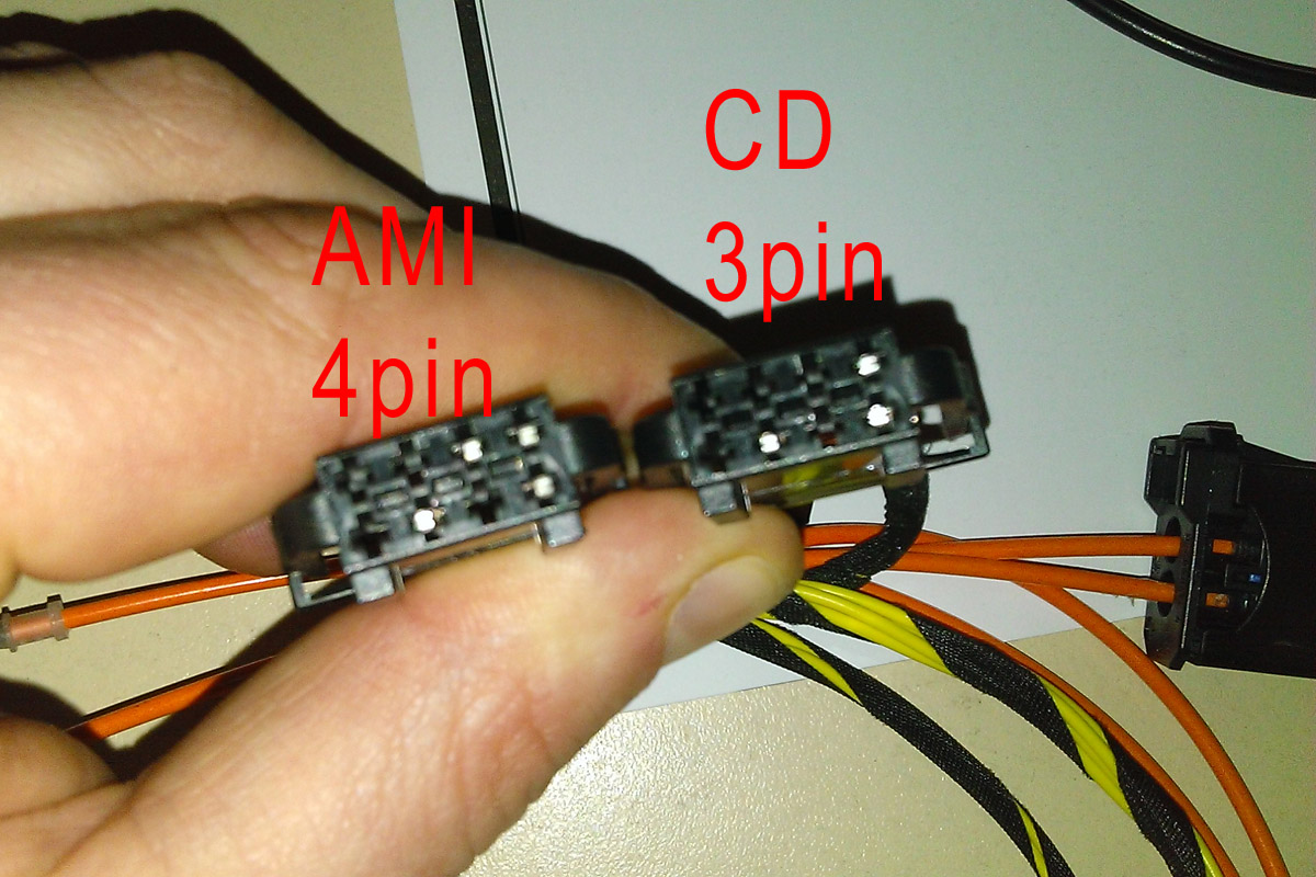

Looking back at previous posts the wiring loom may require some modification to enable it to be recognised as Mediaplayer 2 when retaining the CD Changer. I want to retain the changer, I know someone has done this before so looking for advice on which pins on which connectors need to be connected to enable this.
I know it should just work, but someone in the past had issues with VCDS alternating between the changer and AMI because they were both coming up as mediaplayer1.

That was me. When you get your retro fit kit check the wiring loom. If it's as below then it's good to go.
If both plugs are wired with 3 pins then you need to add a pin to location 4, which is a simple loop off pin 1.

Mine went in without modifications, just followed the instructions for which plug went where. The CD changer is still there and working alongside the AMI

I followed Matty's instructions because I had read somewhere that someone was having problems selecting AMI positively. The loop connection to pin 4 resolves this.
Ii seems that the correct kit comes with the extra pin in the plug marked AMI.
From IT's experience it seems that we are maybe overworking this.
Final upshot is that mine worked first go and continues to do so.

I'll check the loom, but if the loop to pin 4 is missing, I'll need to try and source the pin and short length of wire locally.
