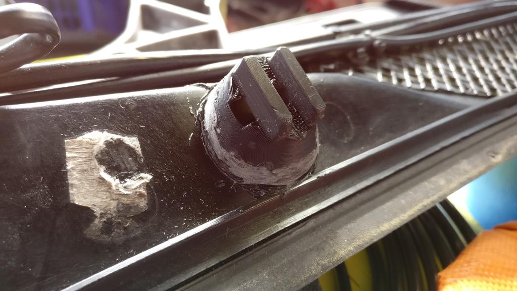

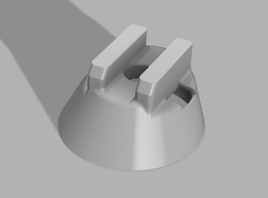

seeing the slightly conical shape, does it replace the old spring mount on the rear control arm?

Much smaller

Last try:
Some tool to press in the windscreen trim?

Morning challenge - who knows what this does?
Makes you scream in the morning when you step on it

Is it a 3D-printed solution to fixing my abused scuttle cover back in place?
Technically correct

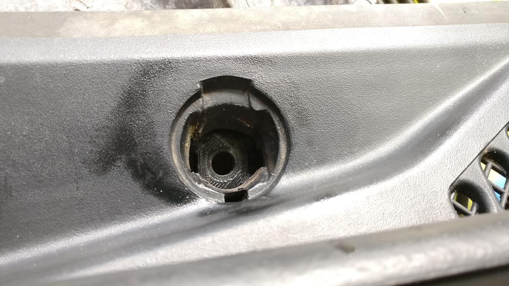

Well done The original is in better condition than the replacement, barring this centre support, so I'm going to repair it rather than replace. This printed part is bonded on underneath in place of the chunk which is missing (using methacrylate structural adhesive), and will function the same as the original

Excellent stuff! Insider knowledge helps here obviously.

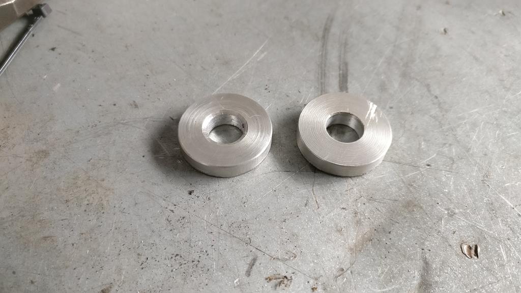

Turned a couple of bushings for the front C-links on the lathe - the links now sit vertically when the car is on the ground, the same as the A4 links did on the FE. This should make the links last much longer

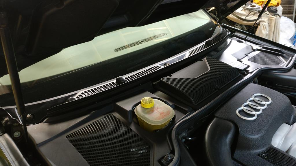

This is the printed repair piece bonded to the scuttle trim
Fits perfectly

Fits perfectly
Of course it does.

Ahhh! so thats what it was
