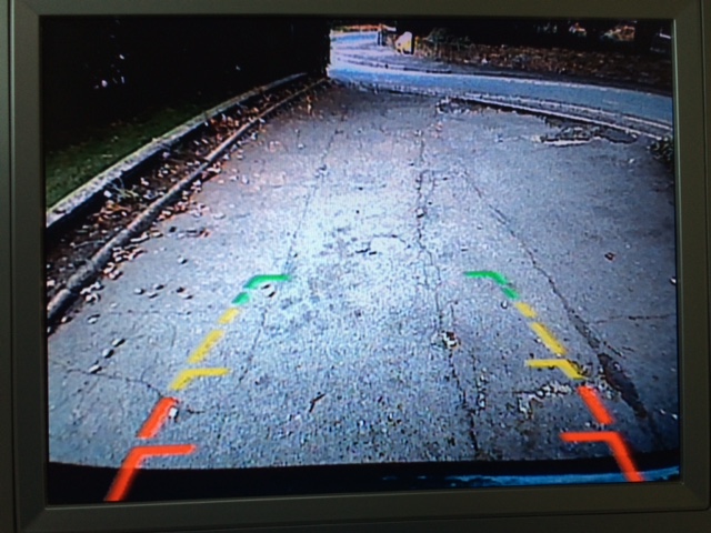

Old 12th October 2016, 07:09 PM
Just tested it to see how it performs at night, seems fine. Near illumination is the LED reversing lights, distant is a street light.

  #44
Old 13th October 2016, 11:07 AM
Very nice. Can you see bumper edge at the bottom of the picture?
  #45
Old 13th October 2016, 11:09 AM
Of course, see the pictures earlier in the thread. That's the bumper at the bottom.

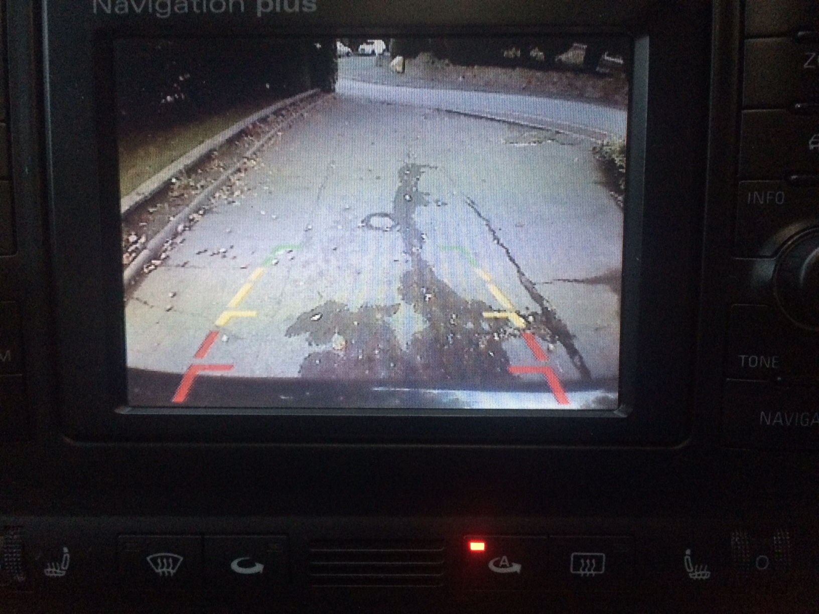

  #50
Old 13th October 2016, 05:00 PM
Fixed and working.
Ugly soldering buried under certoplast. Just need to tidy up all the wiring now, a rather big job in fact. Then find a final location for the interface box, currently in the glovebox.
The LED reversing lamps are much brighter but use much less current than the originals so taking power for both camera and video converter/interface from there makes good sense.
