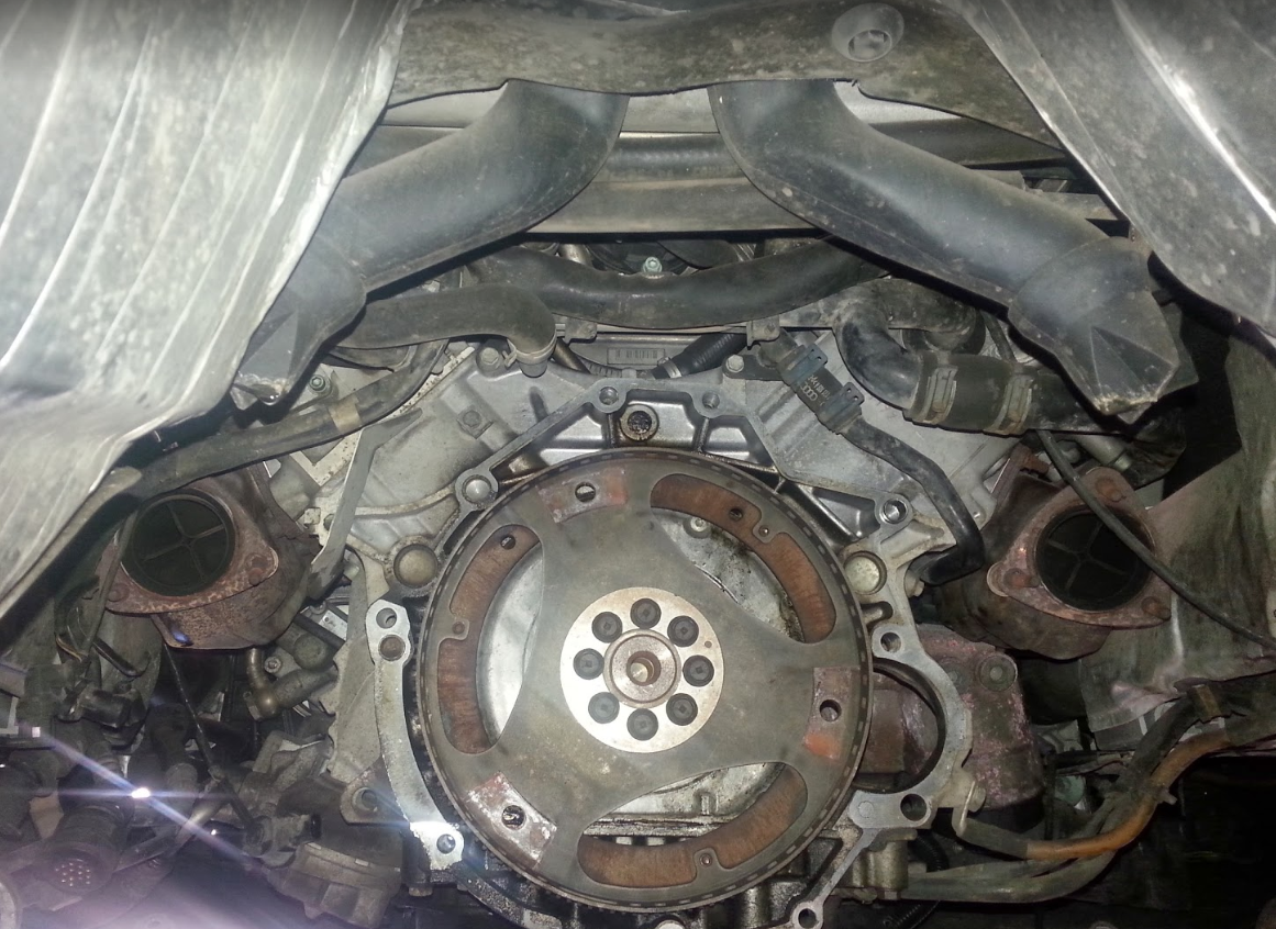

Here's a photo of the plenum drains, which was taken when my gearbox was 'poorly'. It seems rather popular on Google Photos for some reason.

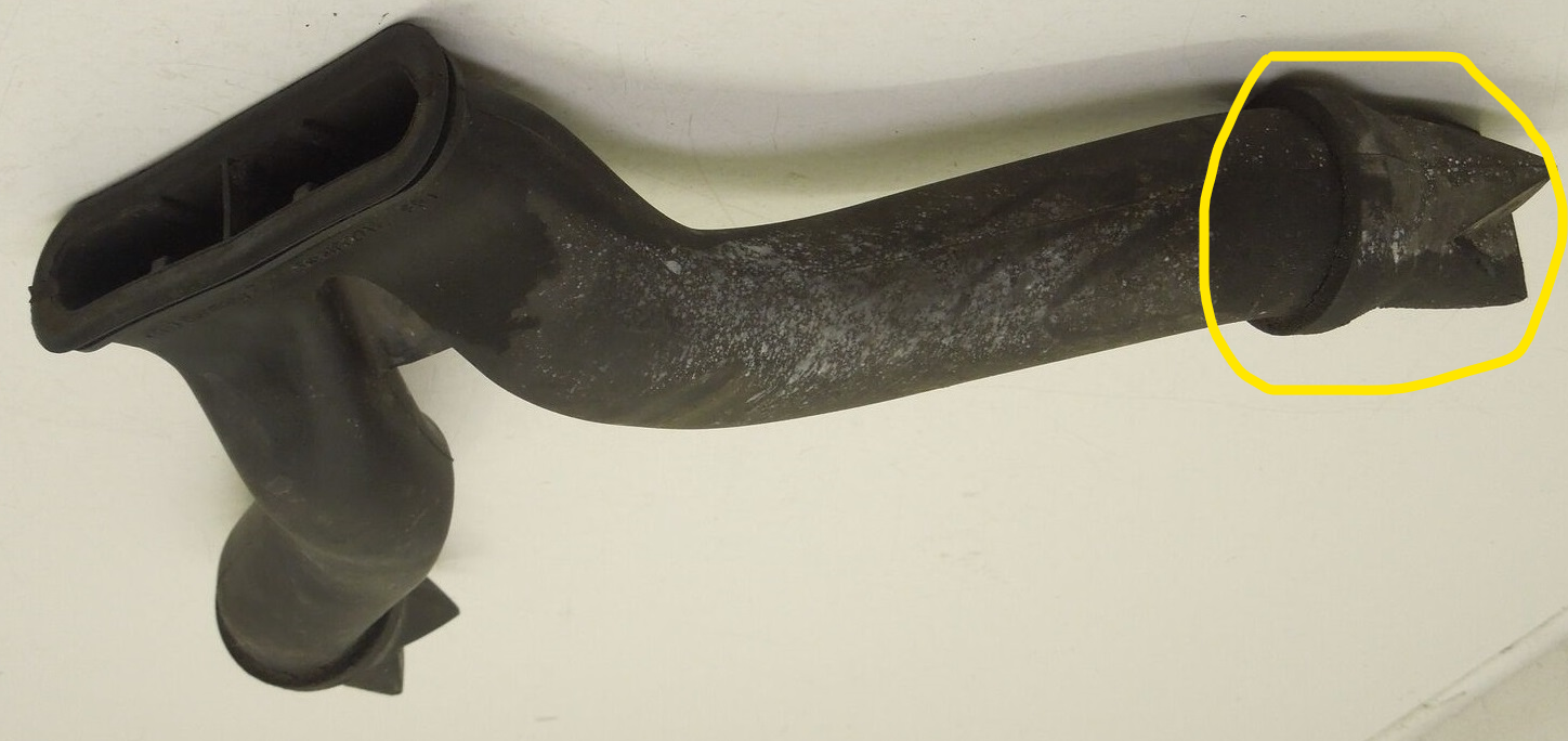

7. Small drains under bonnet, either side close to the wing panels.
- About two inches long and exit at the back of the wheel arch. Location and image as follows:
Where exactly are these? I just can’t see them
Do I have to remove anything to see them?
I just wanna grab them and pull them out!!
Incidentally, i have the car back and supposedly the drains are all clear now.
But i wanna AT LEAST be able to see where those rubber teats above are because i sure as hell can’t find them...
Old 12th December 2020, 11:09 AM
They are high up in the wheel arch, towards the rear of the arch. If you put the car on full lock and get a decent torch, you’ll see them easily. Unless, of course, they’ve already been removed - but then you can see the hole. No need to remove anything.
