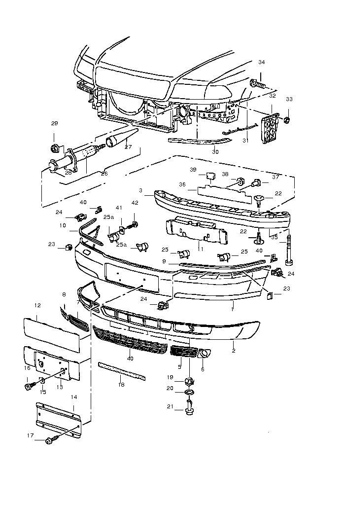

Now time to fine the plastic doohicky thingy that sits on top of the washer jets and connects it to the coloured bit on the bumper.

Old 3rd March 2013, 10:37 AM
Originally Posted by Sir WIll View Post
Ahhhhh that's why the side of the bumper pokes out a few mm now by the wheel arch!
I was looking at that yesterday and pushing it to see if it clipped back in.
All makes sense now!
Its item 32 on the above diagram
Retainer - 4D0807253L for the left one and
Retainer - 4D0807254L for the right one
Should be about £7.50 each
Basically it adjusts in both directions so that you can align the edges of the bumper correctly and there is a small upstand top and bottom that the bumper slides behind (which is what breaks off if the bumper gets pushed back)
