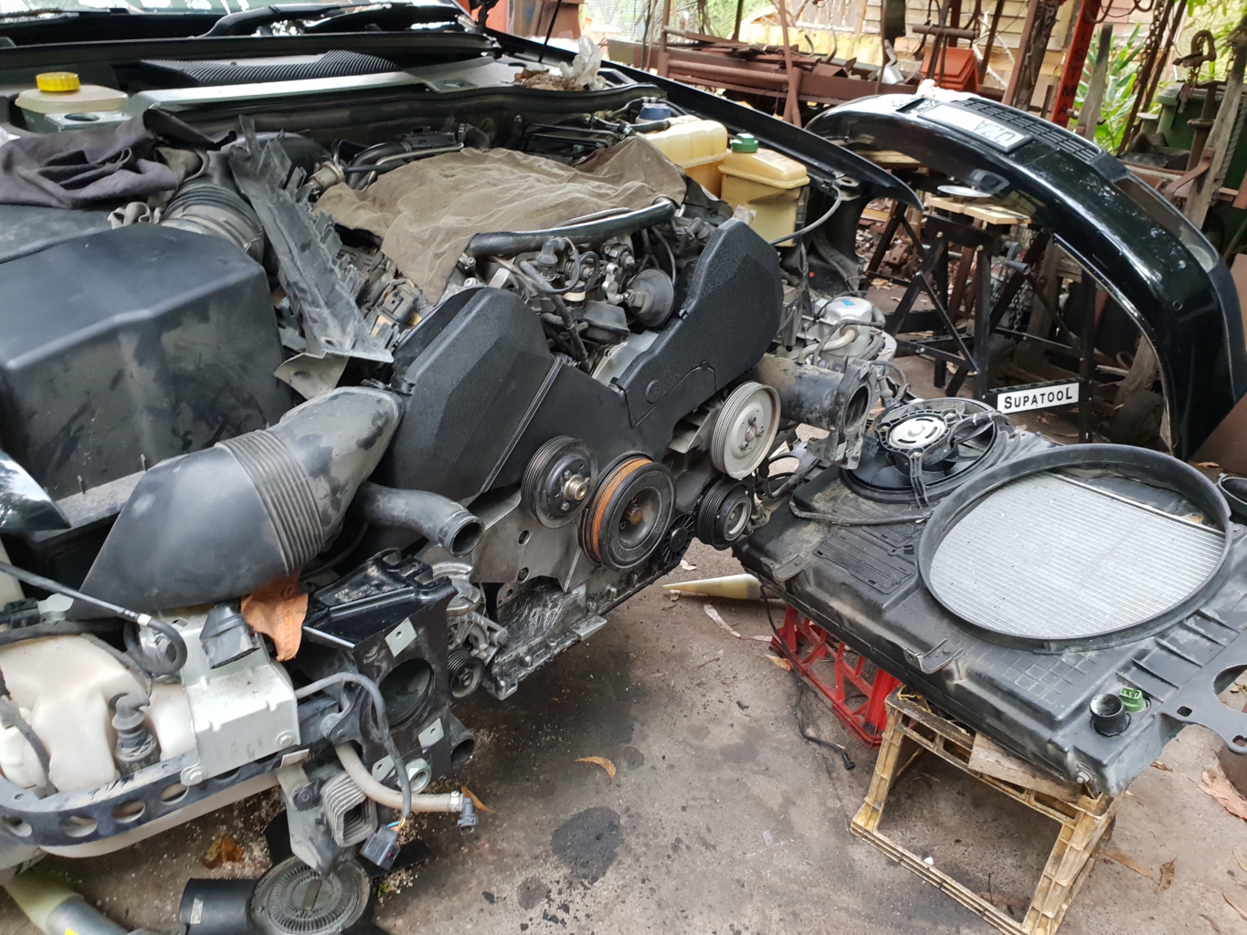

To get to this point took me most of the day at my mates place (he has a hoist, which makes easy work of most car maintenance). I work slow and steady with plentiful tea breaks!
The radiator is still attached to the support and the whole assembly is resting on milk crates and blocks of wood in such a manner as to not put the transmission hoses or aircon hoses under any stress. I might take the whole thing off next time, you only lose about 300ml of trans fluid out of the cooler removing the radiator, and you can swing the aircon radiator out of the way by itself, which is much lighter!

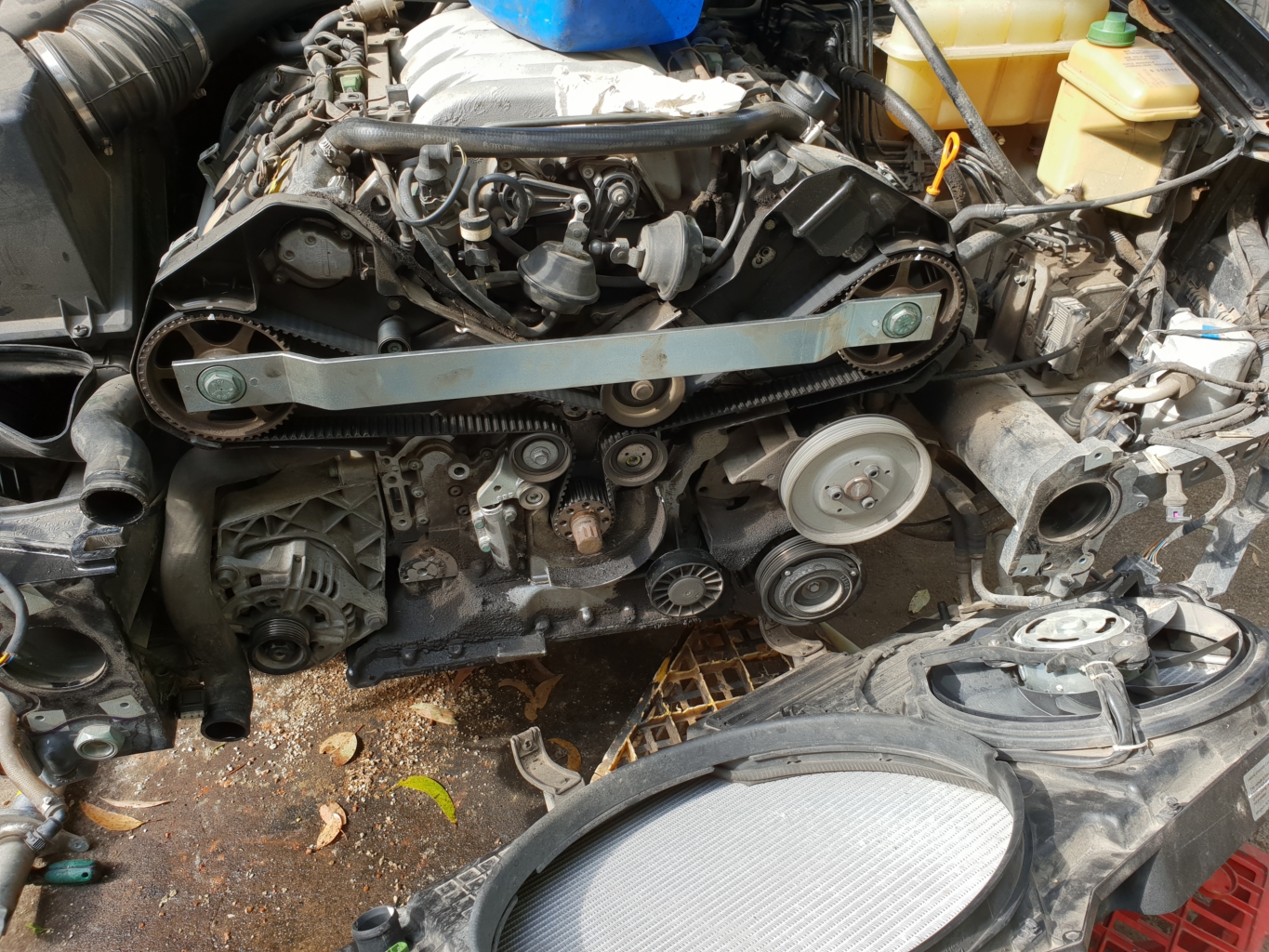

At this point the engine is timed on the timing mark, with the cams aligned the correct way around (big holes facing inwards), and the crankshaft locking pin has been inserted.

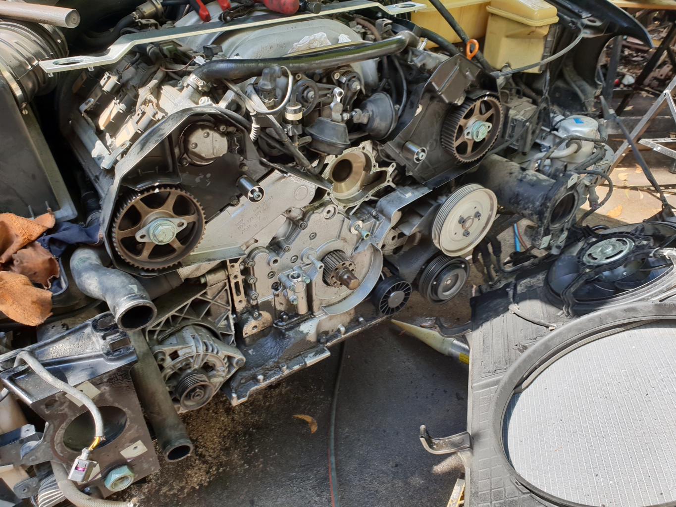

Timing belt and water pump removed. I think I had replaced the thermostat at this point too, as the cover is suspiciously clean!
I'm a big one for parts cleaning, which is time consuming - just as well I don't do this for a living!

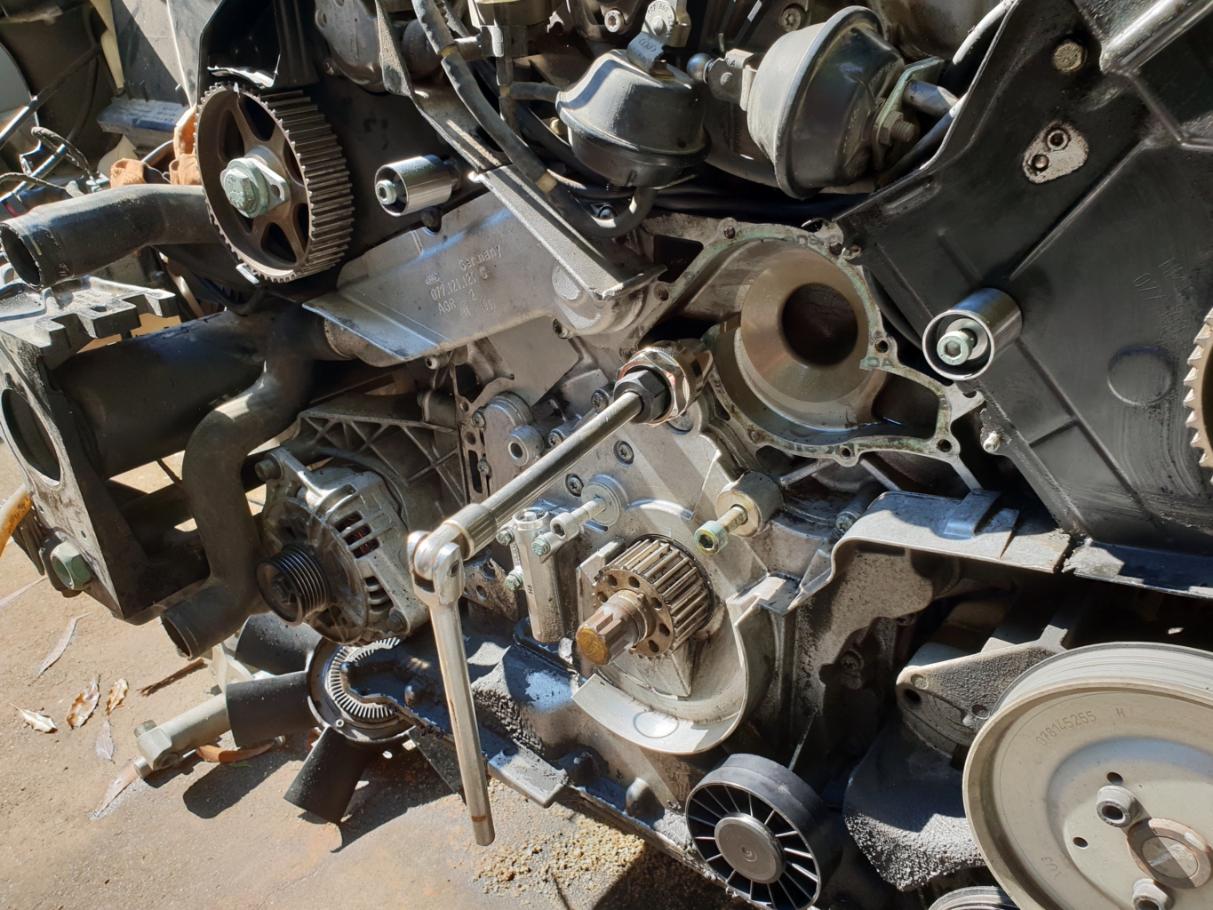

Oh dear... When removing the water pump, one of the bolts felt a bit odd. The head sheared off. By the feel of it, I suspect it had already yeilded when last replaced in 2012.
Several attempts to remove it using vice grips, oxy-acetylene heating, and freeze spray culminated in this expensive little stud removal chuck. That cracked the thread and got the bolt moving 1/4 turn, but wouldn't pull it out.
Finally my mate said he was going to weld a nut on!
Alloy gasket surface cast into the block... I was a bit nervous about this!
Yay!!!

If you look at the first pic of the thread (see below), you will see the front engine torque mount ('the egg') in two pieces (just in front of the right hand front tyre)
I replaced this while the front end was apart too.
I removed both shims from beneath the top chassis mount (these are visible still sitting on the top mount just under the Harmonic Balancer in front of the wheel too), and still had about 1mm of clearance on the new mount. The instructions say it should be a good fit (or words to that effect), neither stretched or compressed.
So I shimmed the lower mount using a washer and needed to be careful how I tightened the nut to prevent adding any twist to the mount (which has locating tabs).
Makes a difference to the smoothness of power delivery I must say. Good item to repair.
