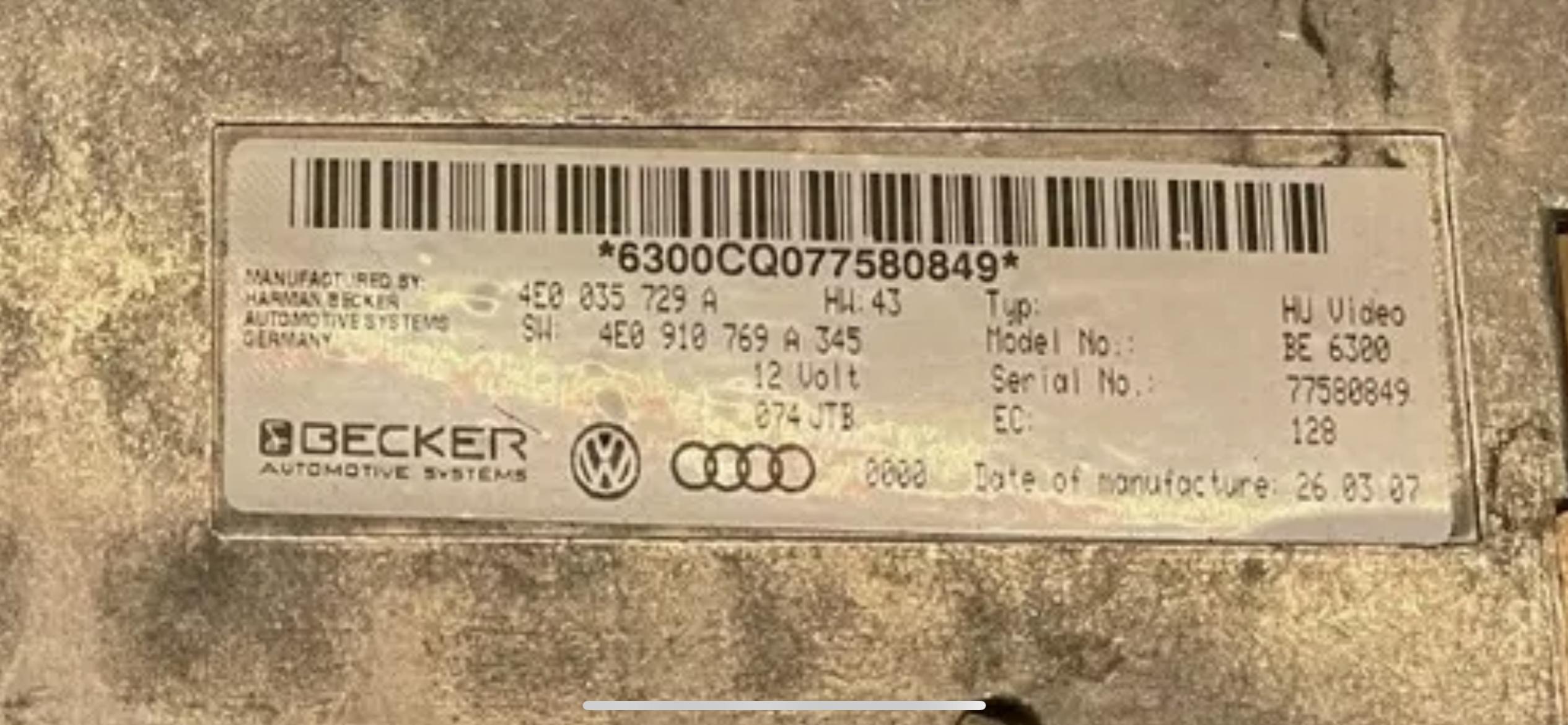

Hi mate. I’ve ordered one from eBay too, and fear I may be descending down the very same EPROM, component protection rabbit hole!
The thing is I’ve used my car lots the last few days and it hasn’t put a foot wrong. Which leads me to think the cause could need more investigation. (I’m having audio drop outs) I’ve bought this, see attachment. Purportedly from an A8 with the FBAS.
I just don’t want to spend time and money and make it worse and then be stuck needing a trip to the stealers with a CP issue.
