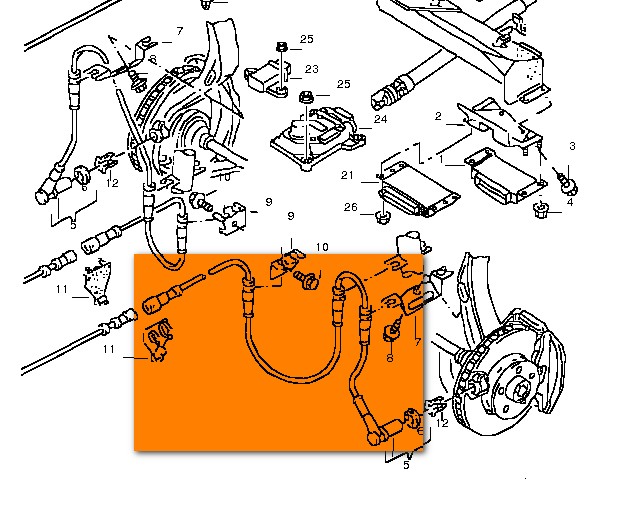

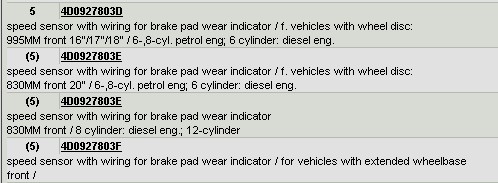

Hi,
I'm starting my search for a replacement OSF ABS sensor - but which part number am i looking for ? Vagcat seems to be showing a number of different ones...
Oli

Old 22nd February 2010, 08:15 AM
I'd check with our David - Seem to recall Frank was one of the early facelifts that still had the Preface style steel hubs, so likely his ABS sensors will be the pre facelift independent ones with no built in connections for the brake pad wearing etc, but I'm not 100% - I'm pretty sure he'll remember....

Posts: 1,066
Thanks Ian - i will give Dave a shout...i think you're right though...i assume this is the old style version?...

Old 22nd February 2010, 05:24 PM
That's exactly what the one on my PF A8 looked like, not sure what the FL ones look like as thankfully not had to change them on my S8.
Old 7th March 2010, 10:08 PM
Hi,
Oli
its either the first one or the 2nd one Oli dependant on your wheel/disc size (see the detail) the last 2 are for the diesel and the LWB
