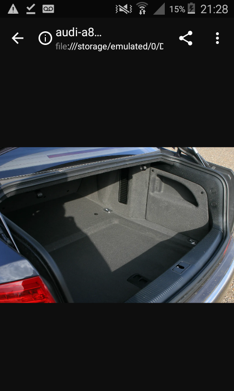

Thants gents the picture is stock from when I googled them, the circular covers I'm looking for are the ones in this photo to the right near the boot seal, I'll be checking the seals tomorrow. Nie on impossible to find the caps/covers on the internet

They are just a screw covers, nothing to do with water ingress.
Also there are no seals for wing lights other than grommet on the cable and paper on the nuts. More likely to be something on the boot lid letting water in
It won't help with the water ingress issue, but the part number for the covers is 4E0863283. However, the price is £7 and that might be 'each'.
