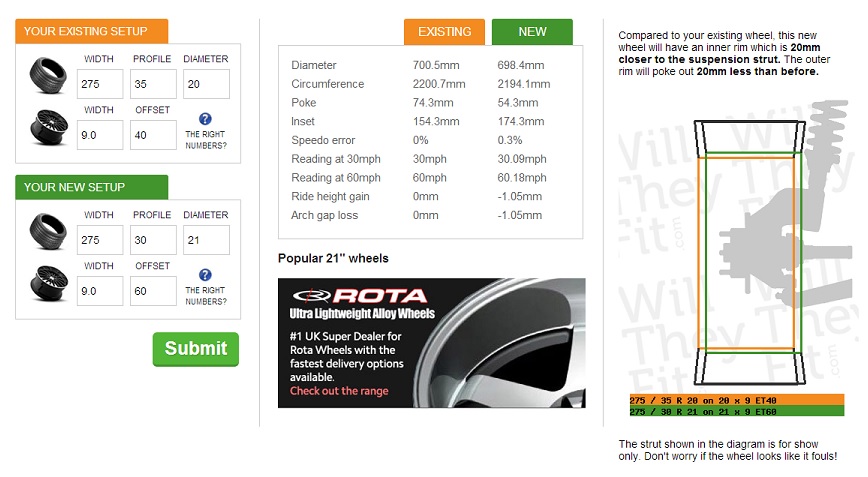

Hi Oli
If you look at the following chart your best fit for those would be 275 30 21 tyres instead of 35's on the FE wheels. I believe the FE wheels are ET40 offset so as you will see there is very little difference between rolling radius on the above suggestion, but you may need to space the wheel back out slightly again as the new ones will sit further in slightly but you could always try it and see and space them back out again. There is generally loads of clearance on a D3 compared to a D2 so shouldnt be a great problem to shift to 21's

Old 12th July 2014, 10:09 AM
60 offset is not going to work very well without spacers and I am not the fan of spacers.
On the other hand Q7 wheels have PCD of 130mm instead of 112mm so would need adapters anyway. Original wheels have ET 44-46 so you would need 14-16mm thick adapters for wheels to be in the same space. Any thicker and they will work as spacers as well bringing wheels more out.

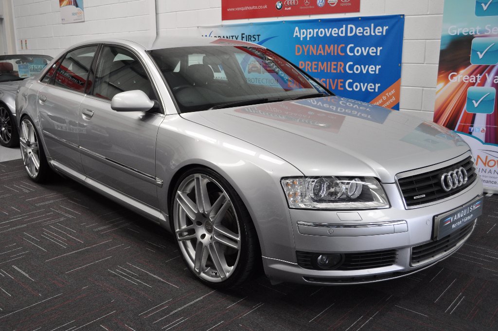

Location: Norwich & L'viv
Posts: 1,679
There is a D3 with 22's on Autotrader today, and they look immense!

Old 12th July 2014, 10:52 AM
Bit of a scrape on the OSR wheel arch and looks lowered as well?
But it also has LPG which isn't mentioned in the advert (or a MASSIVE fire extinguisher?).
Old 12th July 2014, 05:18 PM
It also has acc,
A lot of car for small money
