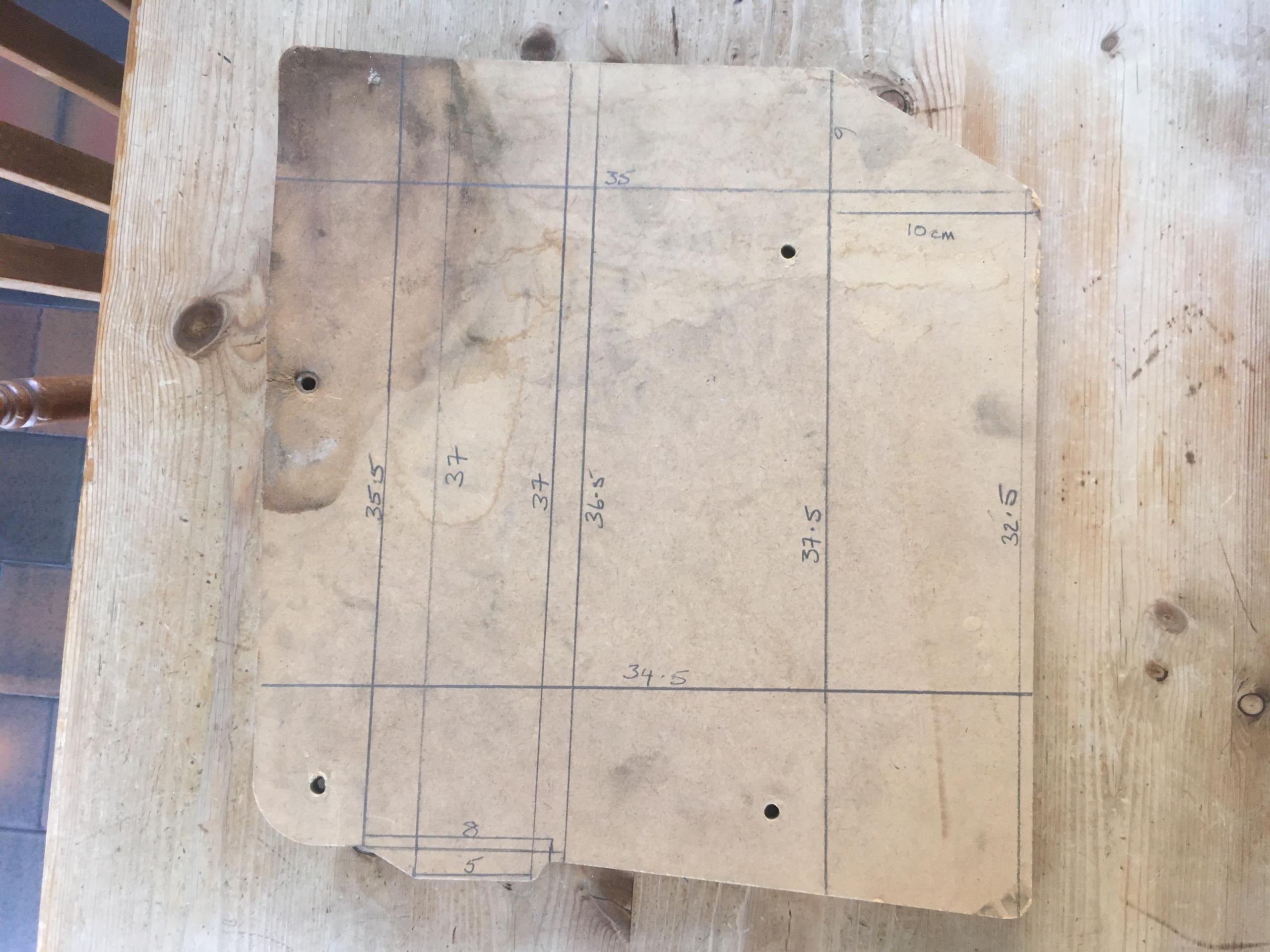

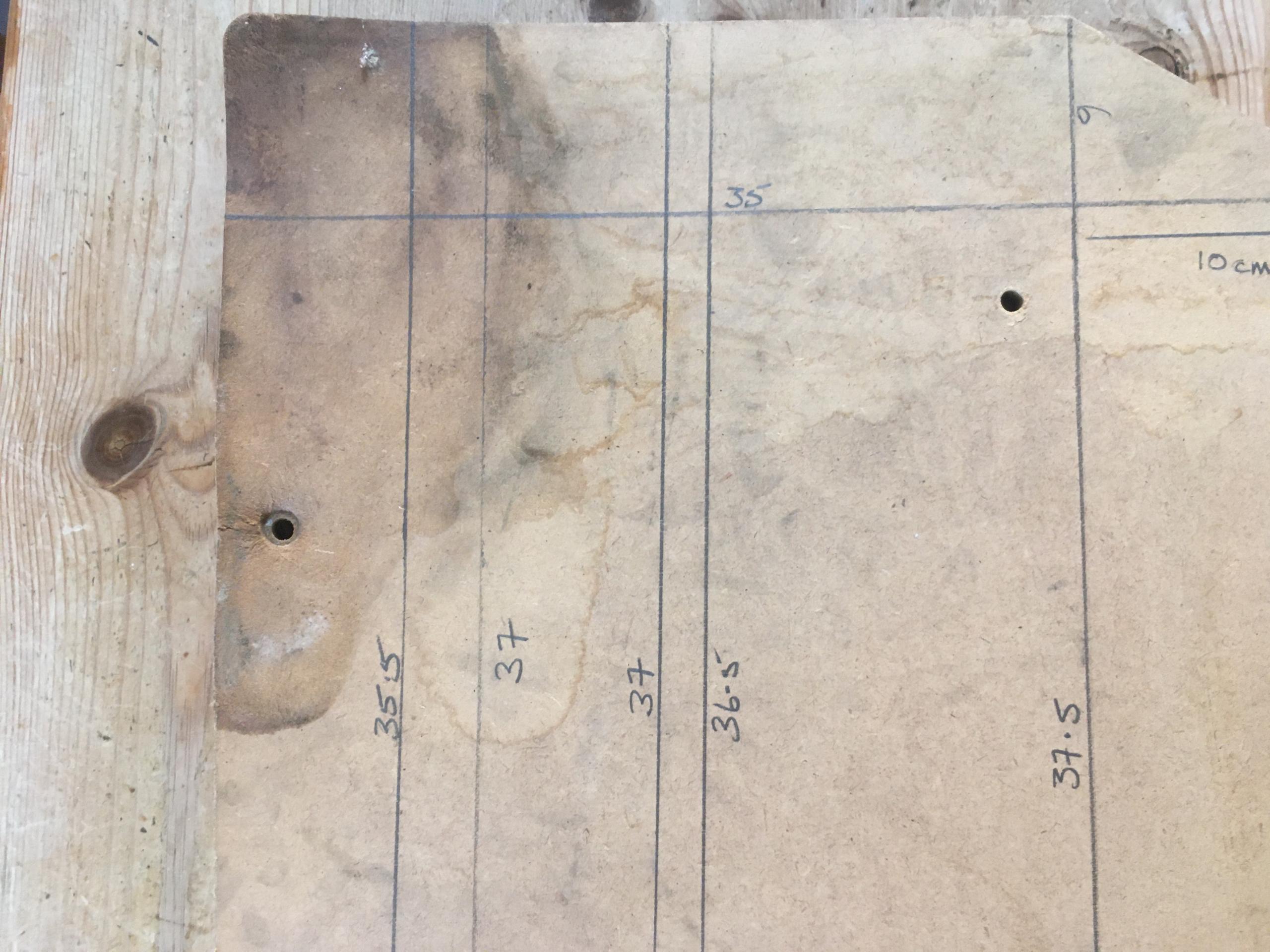

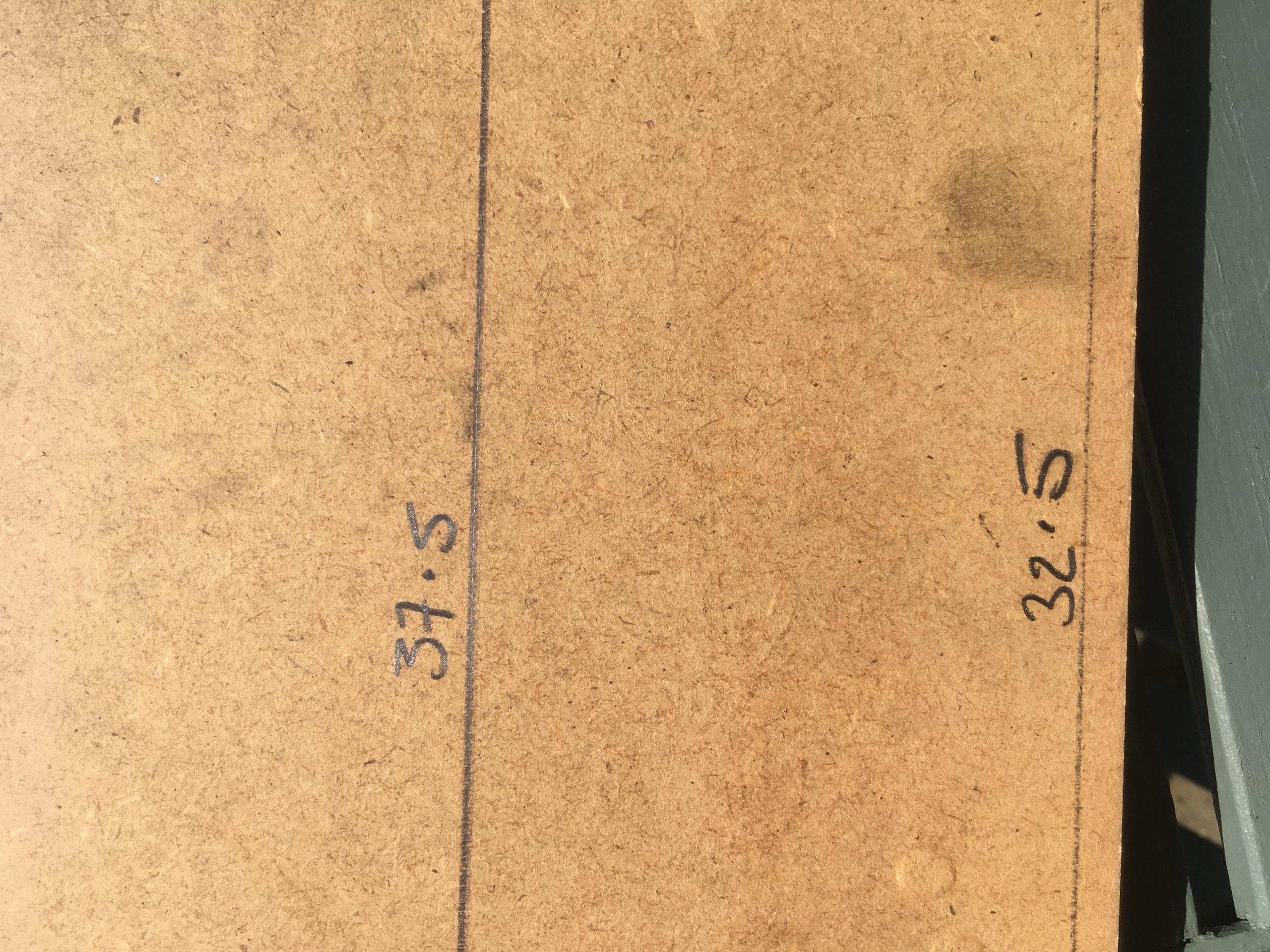

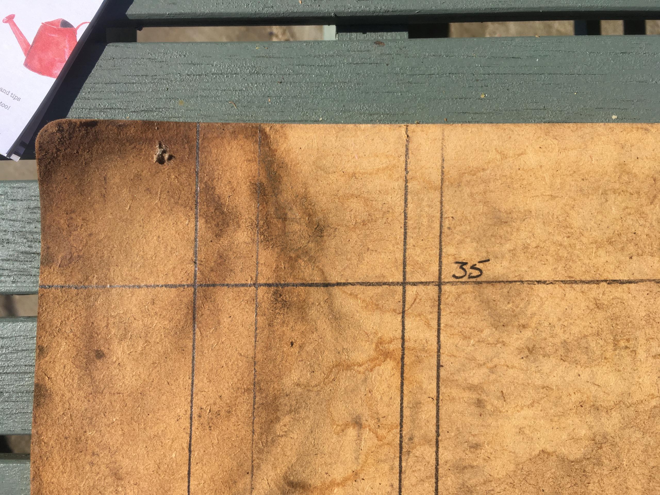

I know this is a bit low tech, but I took mine out and measured it! Attached are photos with dimensions written on the cover itself (in cm), taken in two different lights, so I hope enough of them are clear to be helpful.
PLEASE NOTE: the photos are rotated 90 degrees relative to the orientation in the car! The 35.5cm line is the bottom of the cover.
Let me know if there's a measurement that's missing.
