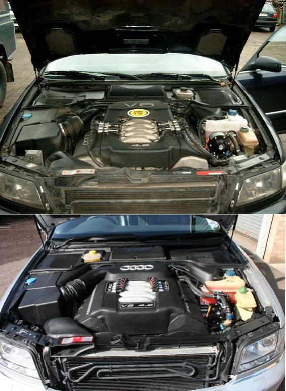

The bonnet on my A8 PF D2 from 1997 is damaged, so I have bought a bonnet from a facelifted 1999 model. Does anyone know if it can fit on my car or have I made a mistake buying this?!

Unfortunately, they are 2 different shapes as the headlights are different on the pre-facelift vs the facelift as you can see in the picture above.

I can see what you mean, but I have (by mistake) bought the hood. Soo I thought it would be fine if it could fit. I have studied the two pictures, for me it seems like the dimensions on the two hoods are the same, but the only difference is the grill, that is a bit smaller on the facelifted model!!
Could I be right or am I completely wrong??

I'm afraid your new hood will not fit as the wings are slightly different and the headlights also.
To get your hood to fit you will have to change the wings, headlights and front bumper. Talk to A8parts and they will be all to happy to help. The bonnet is by far the most expesive part and the job is not that difficult to do.

And for me the shape of the wings seems to be different only near the lights at the sides. The rest seems identical. Look at the picture of the two cars here.
