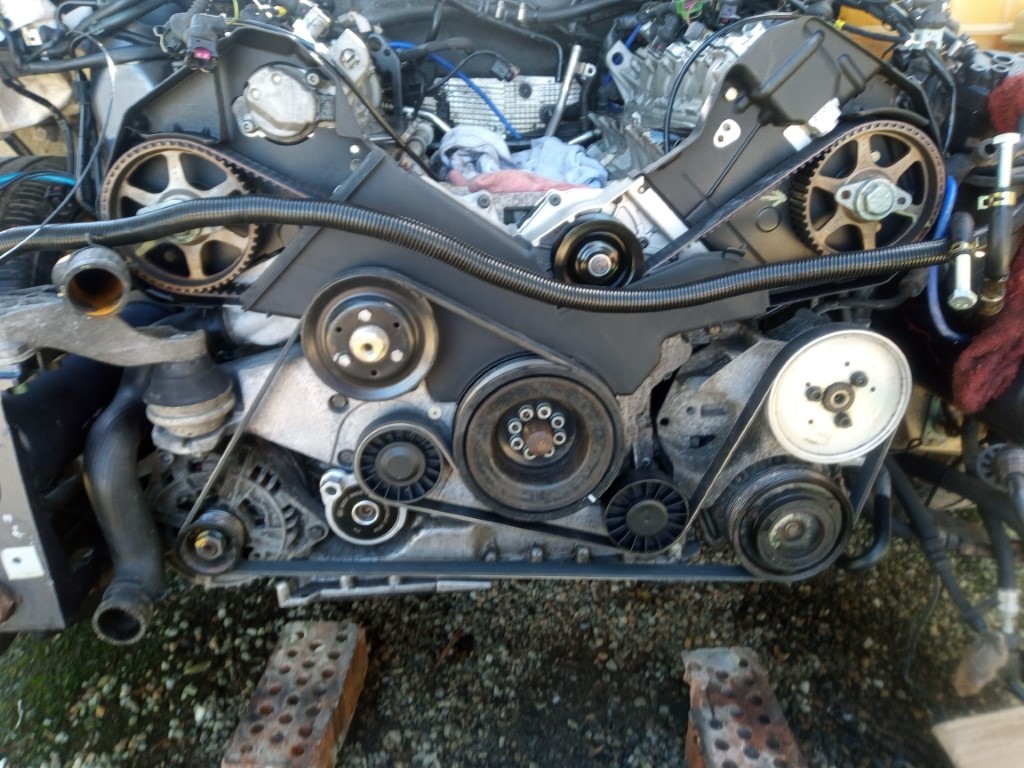

Originally Posted by donp38 View Post
Is the thermostat a timing belt off job?
From the work I've done on the car, I would say a definite yes, but I do recall seeing a post somewhere where they said they could do it without removing it, by just prising it forward, which I reckon would be very tight and need multiple hands.
If you look at image 688, I've highlighted where the thermostat is, behind that metal pipework. Image 423 shows what's in front of 688, and image 680 shows what's in front of 423. Take into account that I also had the entire front end off the car, but I needed to do that. This is a 3.7 engine, but the 4.2 has a very similar layout.
EDIT: Found the link, with video, but the engine is out of the car!
https://www.audiworld.com/forums/a8-...-belt-2909229/

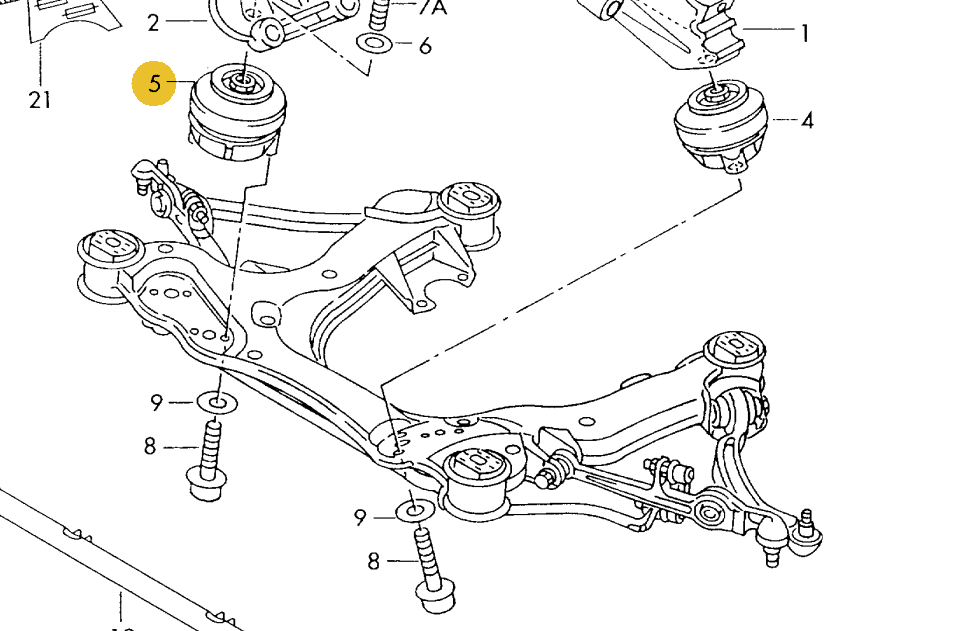

Now also found as you look at the engine it needs left (so drivers side) front engine mount. Looks as though I can't get one from Audi any thoughts?
Old 25th January 2024, 07:04 PM
Posts: 3,237
Part numbers for the drivers side, which ETKA classes as the right side (for engine stuff - #5 in the attached image), is 4D0199381AH, superseded with 4D0199381AT. There are a couple of new ones one eBay, both listed as genuine, but please take note that the seller only has a feedback of '3'. The listings are as follows:
https://www.ebay.co.uk/itm/145012897517
https://www.ebay.co.uk/itm/145159198886
Audi Tradition in Germany have the AT version:
https://shops.audi.com/en_GB/web/tra...rm=4D0199381AT

Old 26th January 2024, 06:25 AM
This is the correct designation of ‘right side’. For all ‘side’ references, the viewpoint should be from the driver’s seat. Hence ‘left hand drive’, for example. This also avoids any confusion in using terms like ‘driver’s side’, which obviously varies by country, as some countries still persist in driving on the wrong side of the road!
