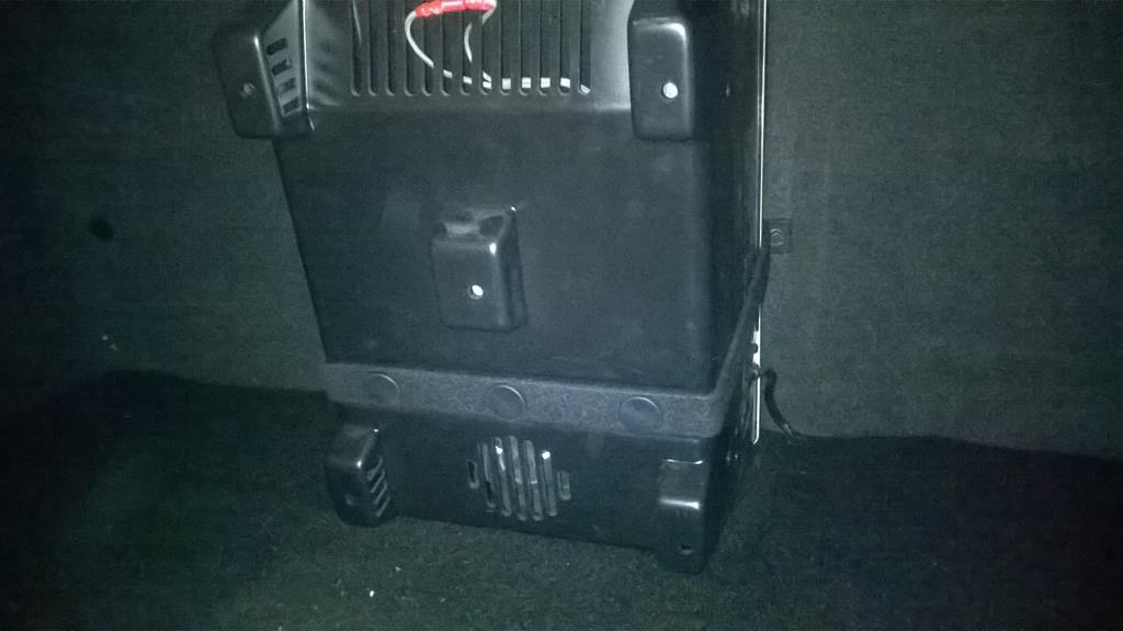

Because of the LPG tank, the boot carpet doesn't fit any more. This is a, most uncomfortable when working in the boot, and b, a most excellent tool-trap when things fall under the tank! I should imagine its also quite vexing if you want to use the boot too!

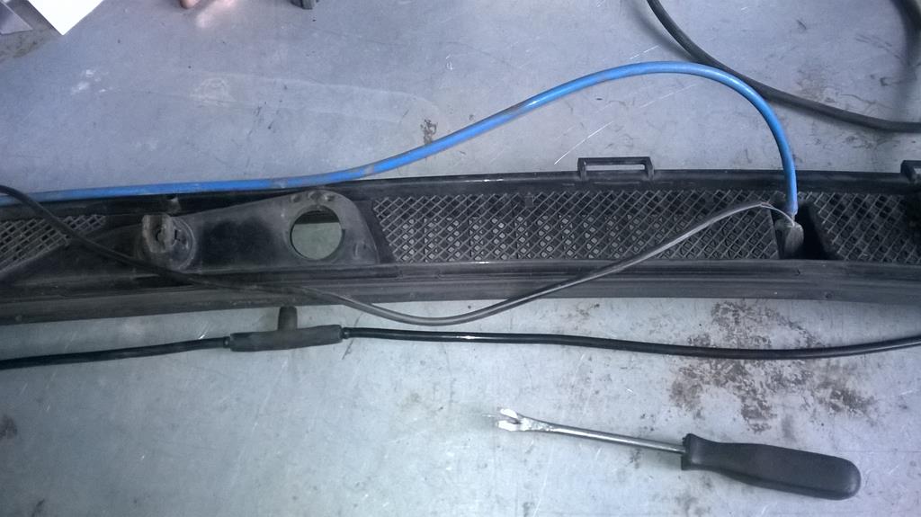

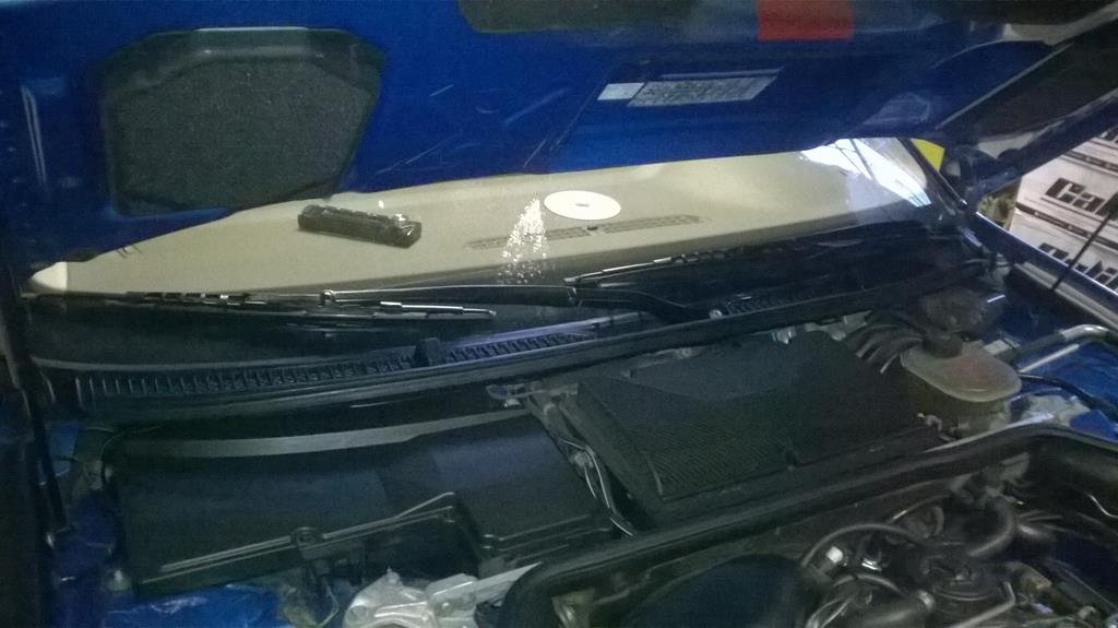

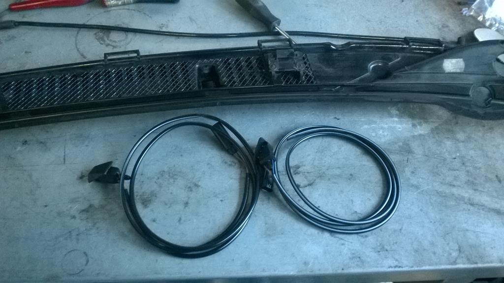

Scuttle panel and windscreen washers tonight.

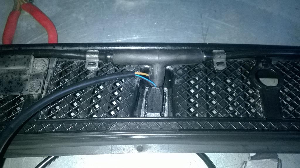

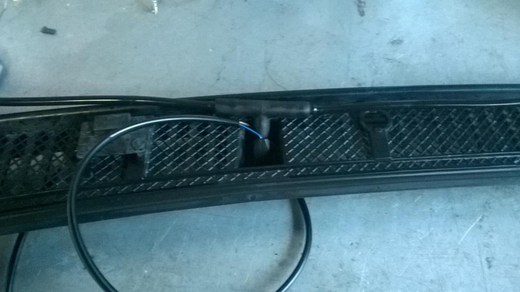

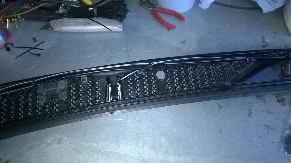

When I took the e-box lid off I discovered the wires and pipes were hanging down, and it turned out it had a random piece of pipe in there which didn't fit very well so stripped it down and started again
New washer jets since the heaters didn't work in the old ones
Jets installed
New clips to hold the pipes down
Pipes fixed in place
Wires nice and neat
Installed and wipers back on
Covers back on and we're done under the bonnet

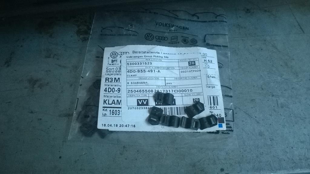

I'll probably be doing something similar fairly soon; where did you get the 4D0955491A clips from, I might need a few?
  #146
Old 30th April 2018, 09:36 PM
TPS. I bought a bag of 20 since they were on back order. 7 per car so I can do the next one too.

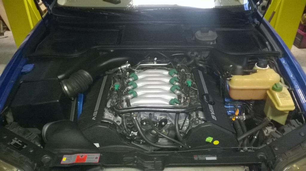

The LPG is by Zavoli. It is an Italian make with a master slave system. Both my Vento 2.0E and the A6 3.2 FSI run flawlessly on Zavoli, too.
The LPG tank lets me fill up approx. 64,8 litres and it lasts for approx. 300 km. In average it's approx. 12 mpg. A loss of power cannot be denied so the LPG sometimes needs to be switched off depending on the circumstances.
S8 FL manual drive, 11/1999, pelican blue, customized by the Quattro GmbH, KAW 60/40, Supersport silencer, 19" from the S8 D3.
LPG & 385mm front brakes (D3).

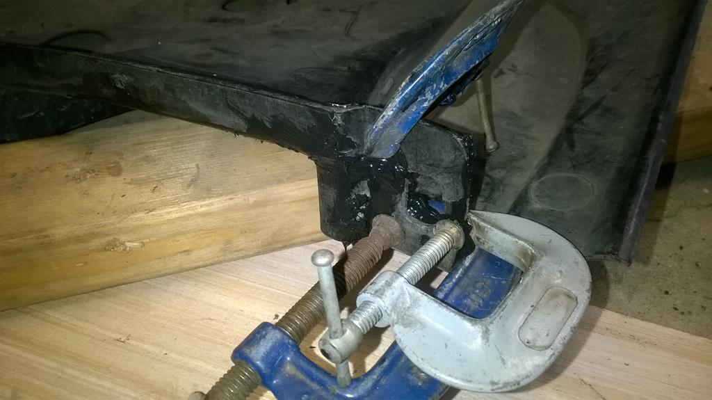

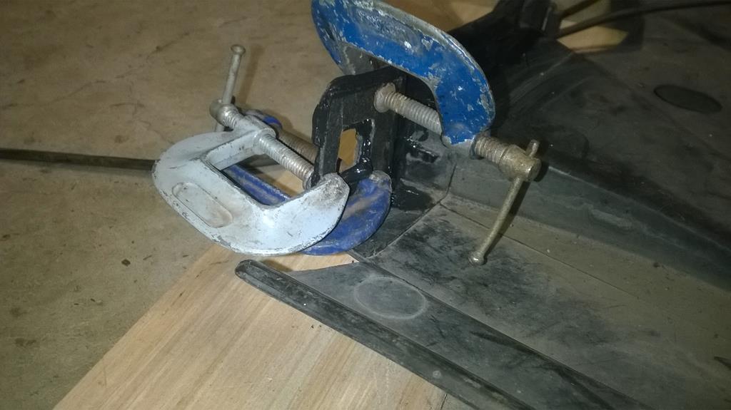

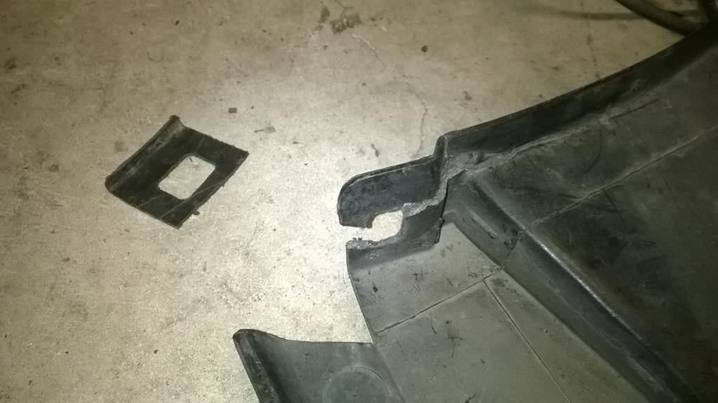

One of the mounting points on the undertray was broken. I've cut a chunk out of an old broken tray to use as a repair piece.
Stuck the repair piece on using panel-bond. This is a structural polyurethane for sticking bodykits on so it ought to stick the plastic quite well but still be flexible. This is rather experimental so we'll find out in a day or two if it works!

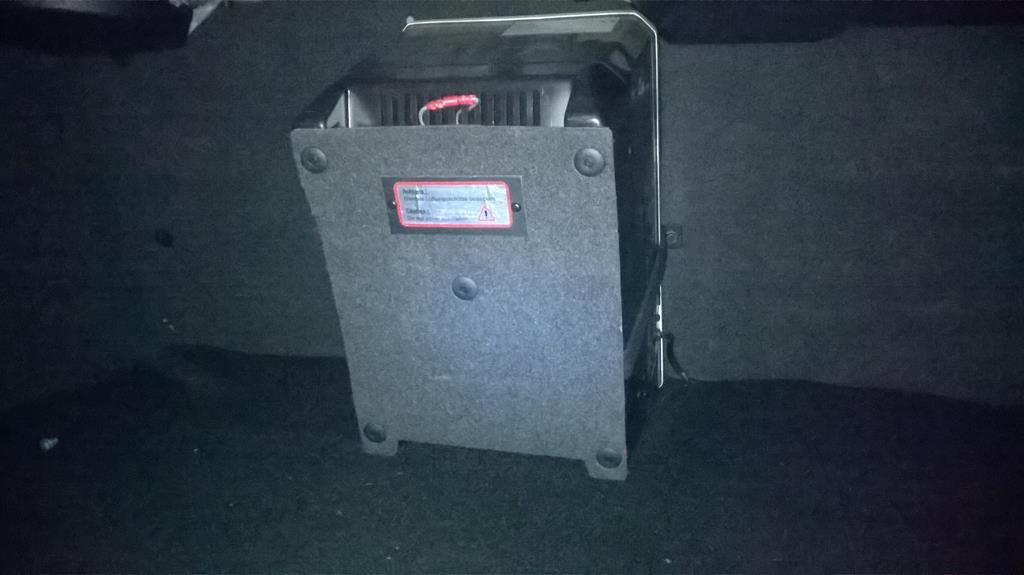

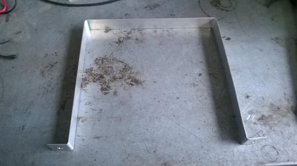

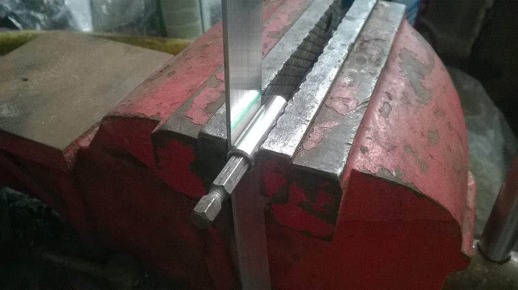

With that done, moved on to the missing fridge bracket. I made a new one from 25mm aluminium flat bar, bent to shape. Using a 'mandrel' to get a radius on the bends:
Rough shape

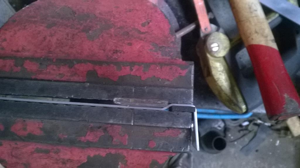

I needed to tuck the front of the bracket in round the shape of the fridge to get to the mounting holes so used a couple of bits of steel to form a kink

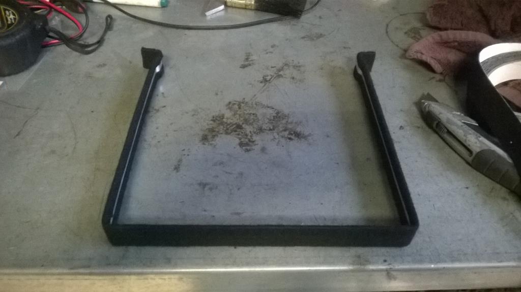

Wrapped the completed bracket in anti-rattle felt tape and its ready to fit

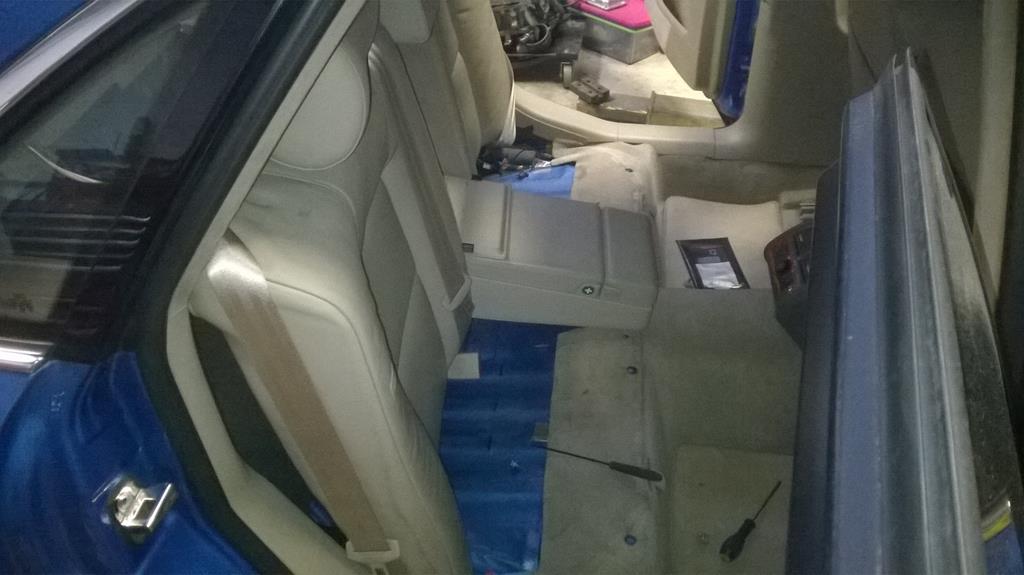

Here the car threw me another little challenge. I was expecting the sheet metal to have captive nuts of some sort, but it turned out they were just through-holes. Back seat out then, to get a nut on the bolts!
Employ Mr Tickle to hold the bolt in the boot and the nut in the cabin at the same time
Bracket bolted in place and secured to the fridge with plastic rivets
And finished with it's cover panel
Pretty happy with how that turned out
