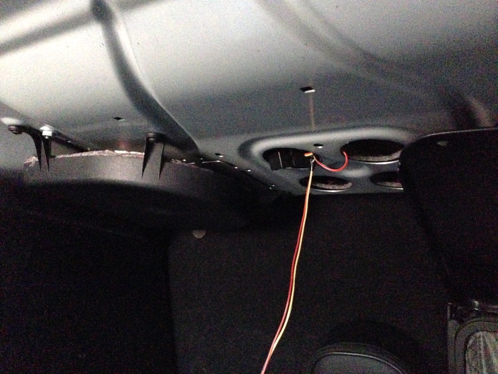

I finished testing under parcel shelf and everything works tip top there.
No signal losses, works fine in garage after a week of continuous parking.
There's plenty of room there and good access.
Snaking wires may require rear seats removal though.
Picture of test position:
