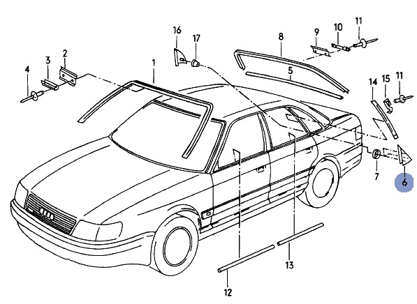

The picture from EKTA suggests its just a pop off item. You could always just pull it off and see what happens! If successful let us know as I am in the same boat.
