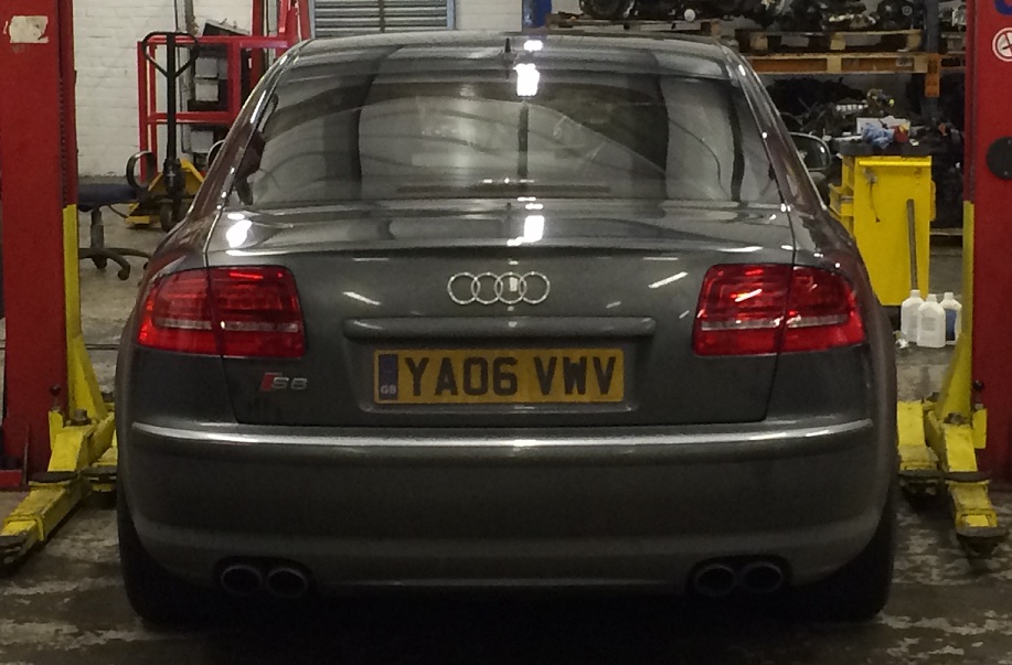

Old 23rd January 2014, 10:42 PM
10, 11 and 12 all done.
She feels far more fruity for having had a full service. Plugs were pretty poor, oil was black and filters were well past it. It really does go better now which I find astonishing.....
Gearbox is so much smoother now, and it does look way more modern with its facelift rear light clusters on
I should really be thinking about selling it by now but it is rather addictive....
