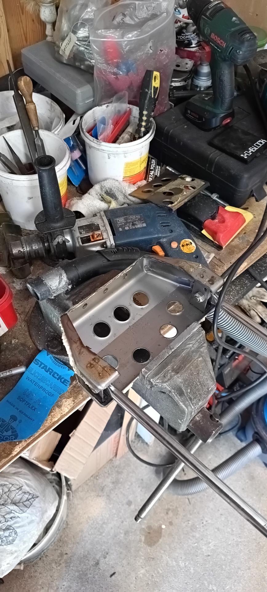

Here is what I've got so far in the bar compartment. The actual box is somewhat easy to make but the lid is a bit more complex so any tips are appreciated.

An amazing amount of work, and really jealous of the sports seats. From what you've shown so far, there will be very few members on here who can offer more tips. You'll have to provide photos when it's all complete.

Yes please do I'm interested in details of the actual hatch and how the inside looks where the holes for the glasses are. And even better if you have time to measure some things. I'm wondering about the diameter of the glasses. Hoping to find some that are quite close to original.
Also wondering about how deep the part where the glasses sit in is and how tall the glasses are
