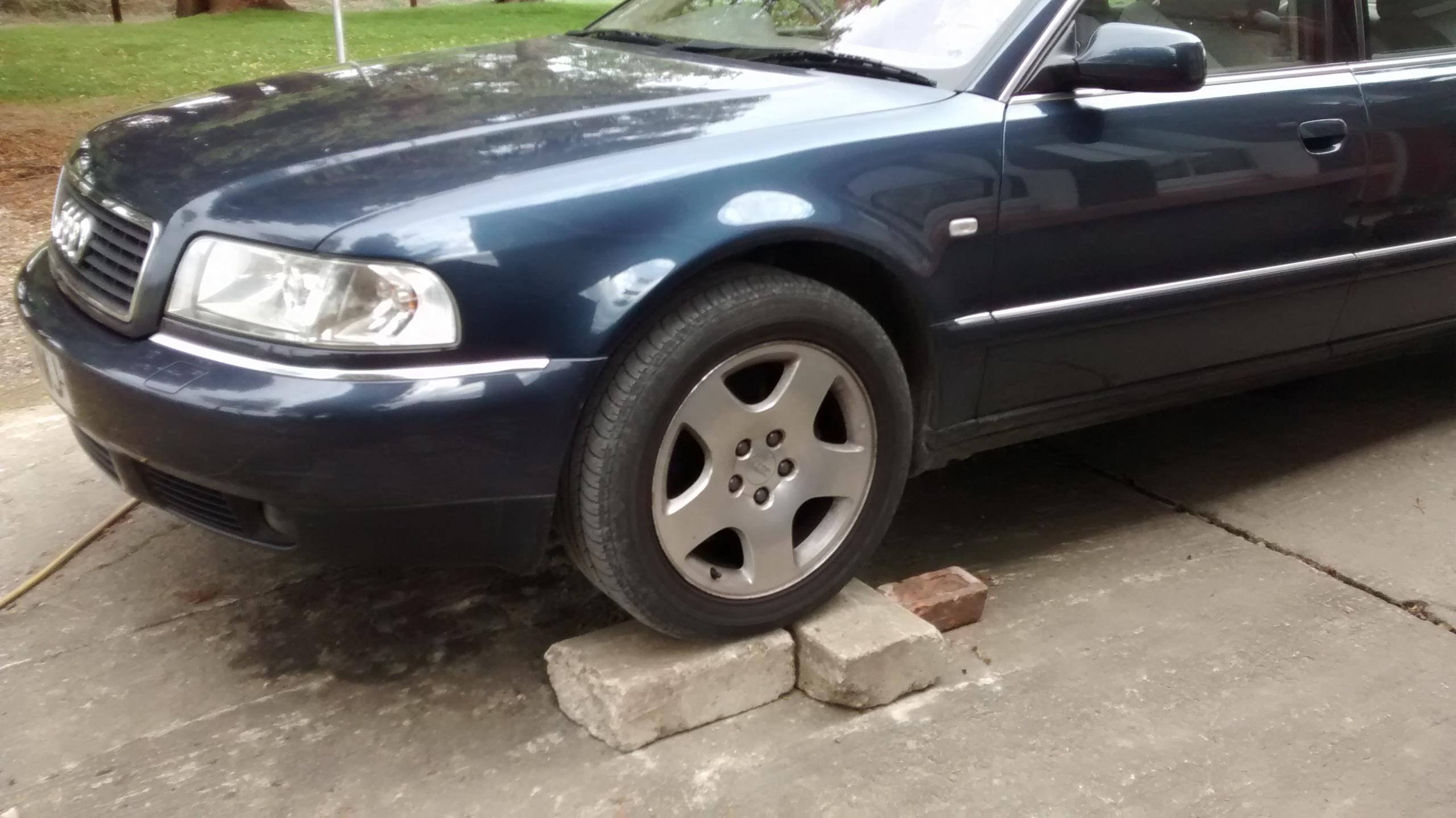

Cheers for that Sergey. Just posted a thread asking that very question. On mine, the undertray covers the plate, but I just took a snapshot with my mobile in one hand and a torch in the other.
And here's a snapshot of my 'ramps'.
