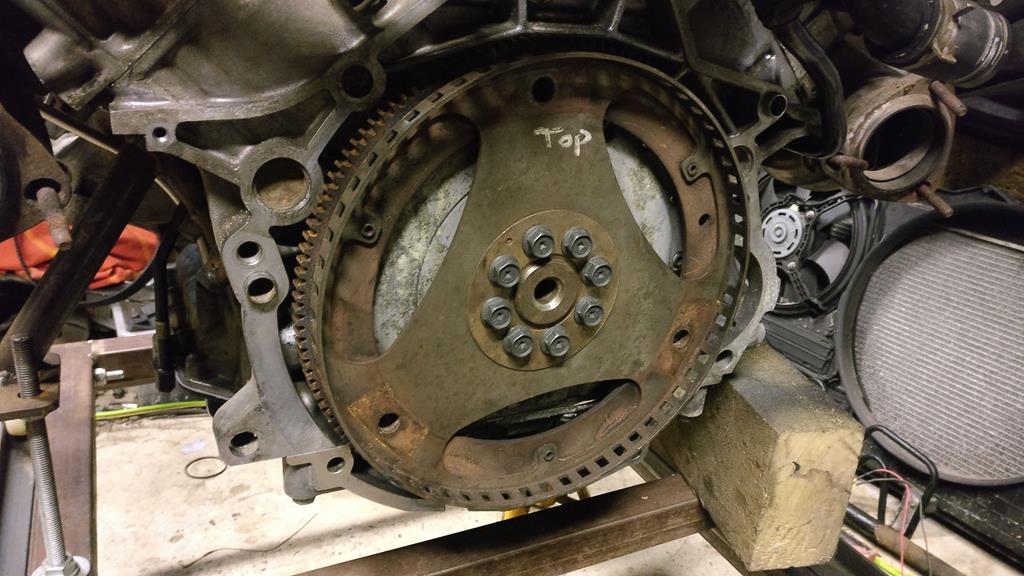

Literally the only thing anyone ever got right on this car
The only original parts left of the powertrain are the flywheel and, ironically, the F125 Kersteman's final bodge, fitting a used switch which was equally as broken as the original, is actually what saved the car from certain death.
I forgot to take any more photos, but the engine and box are now joined together again, fluids filled, and oil system primed. I'll clean up the subframe tomorrow and mount the engine and box back on it, and then I can move on to the engine bay.
