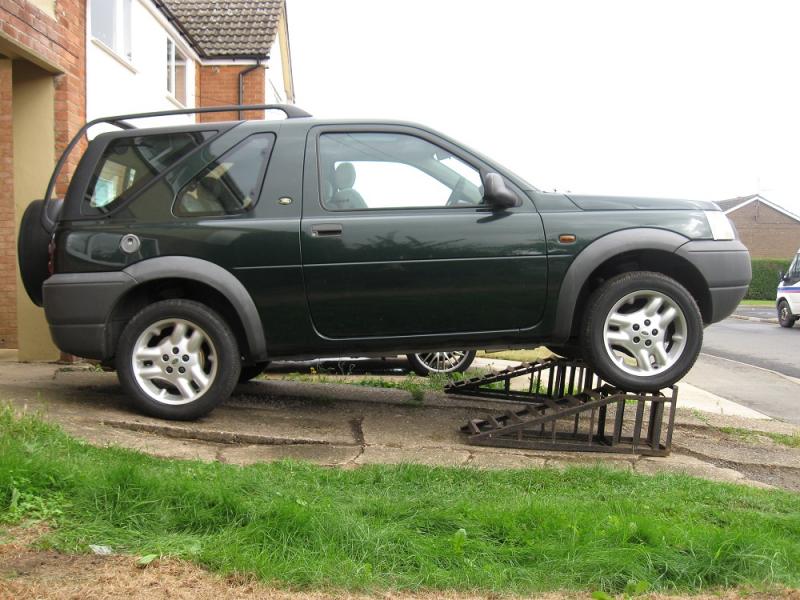

Old 1st October 2011, 05:27 AM
That's what I call ramps, £30 from e-bay

Old 1st October 2011, 08:40 AM
Nollywood's Avatar
Join Date: Aug 2011
Location: Aso Rock!
Posts: 1,000
I've got a set of those. I got mine gratis though, from my next door neighbour, when he was down sizing to a house without a garage or garden shed.
