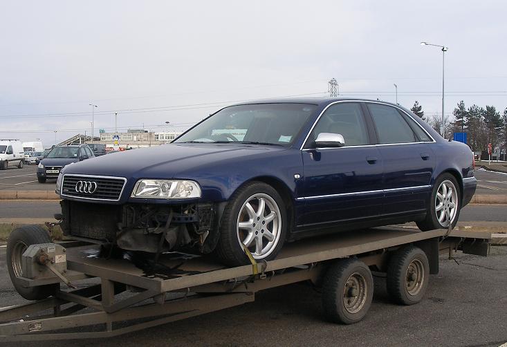

Well, we picked her up yesterday. Its quite sad picking up a motor that we know so well, its less than 4 months since we had it all apart fitting Bose, blinds etc.....
What a weird journey... We set off in Ice in Yorkshire, and by the time we were in South London I was cursing the blazing sunshine and lack of A/C... And today in Yorkshire, we're snowing again....
I'm a bit of a photo-aholic, so heres a shot of her at Toddington services on the M1 Northbound, finally out of the smoggy city for good
I dont think we've ever picked up a car that looks this clean......
