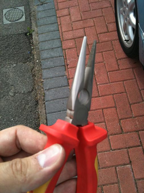

4. Most important part. Take narrow pliers and squeeze copper element at the top and at the bottom. This will help copper "lips" to grasp the male part firmly from both sides. Don't press pliers too hard, as this will create excessive pressure on the male element. As a side effect of excessive pressure motors may have difficulty moving the mirror or you'll notice judder when adjusting the mirror.
