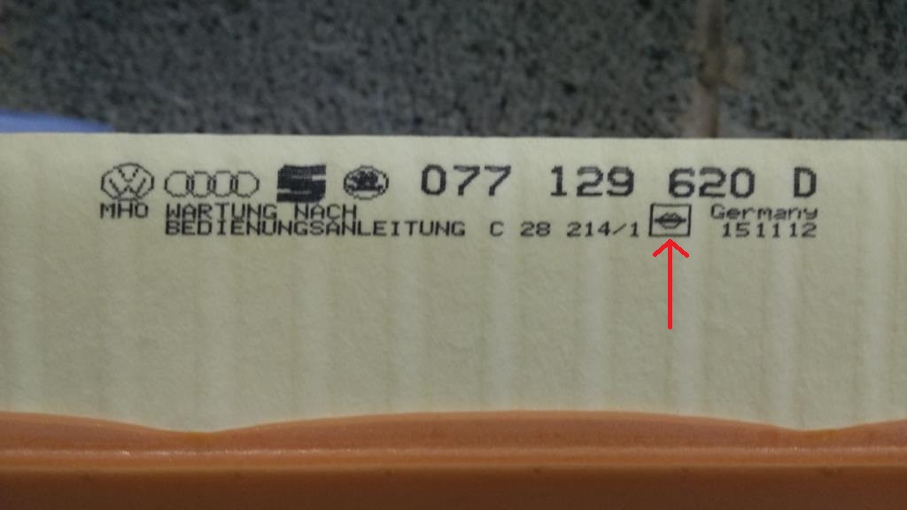

I think the logo is "do not bend" rather than "no Mick Jagger's Allowed"

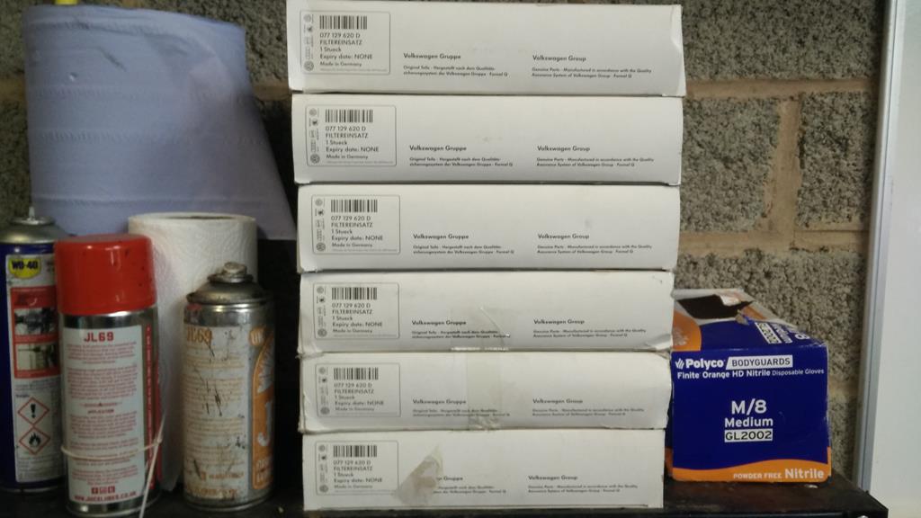

These are the last ever genuine D2 air filters
There's a couple on ebay if you want to hoover them up

They seem to be readily available in the USA also but surely a decent aftermarket like MANN would be just as good.
Old 24th April 2019, 09:19 PM
Yeah there are a few still in stock at various places, but now NLA from TPS. There are a few choices of aftermarket filters which I shall investigate before these are gone. The annoying thing is that the aftermarket ones are more expensive than genuine!
