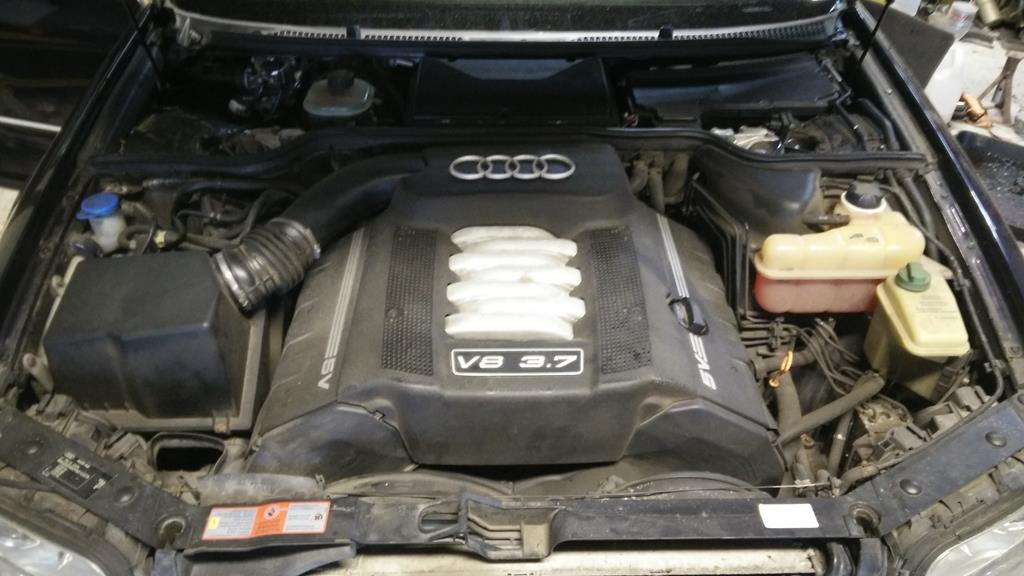

I'm going to stick him through an MoT and just drive him about while I decide his fate
The engine bay is the dirtiest I've ever seen

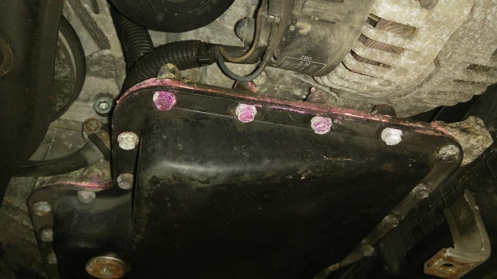

Ugh. We all know what this is That is not getting fixed before the MoT!

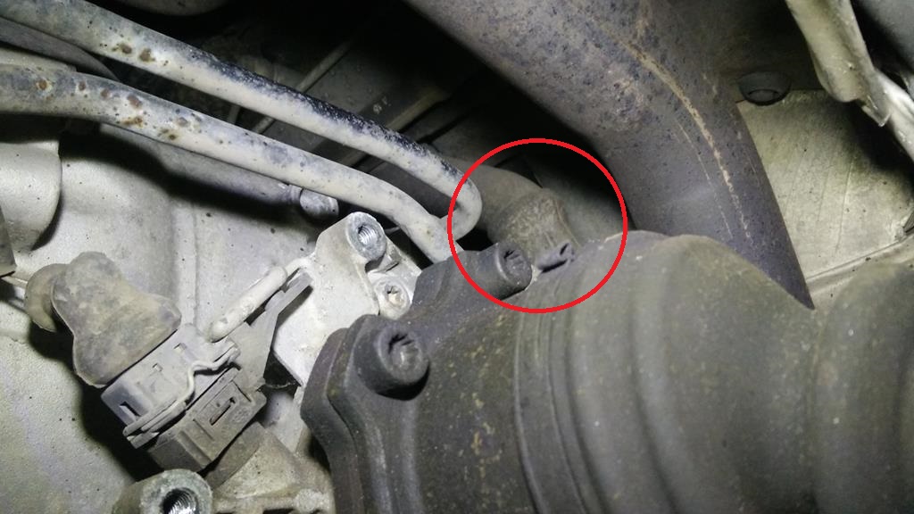

The 3.7 has an additional oil cooler for the gearbox, as well as the standard one in the radiator. Lots of silly plumbing in this corner because of this.

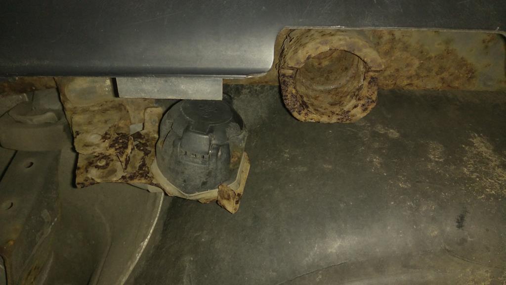

Factory towbar

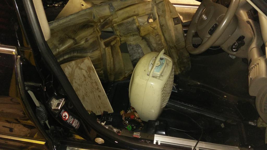

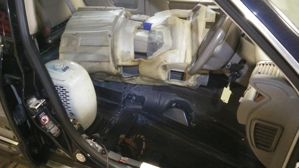

Well, this is the source of the dampness in the cabin The driver's side carpet is utterly soaked, despite being dry on the top
I spent quite a while squeezing the water out of the foam like a sponge, then mopping it up with a towel. Its amazing how much it can hold under the carpet
I got out as much as I could by hand and then left the dehumidifier running overnight. Its going to take a few days of this to dry it out.

I've taken 6 litres of water out of the interior so far

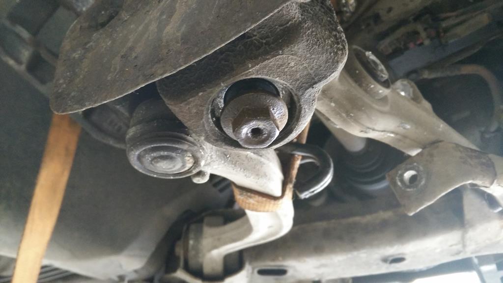

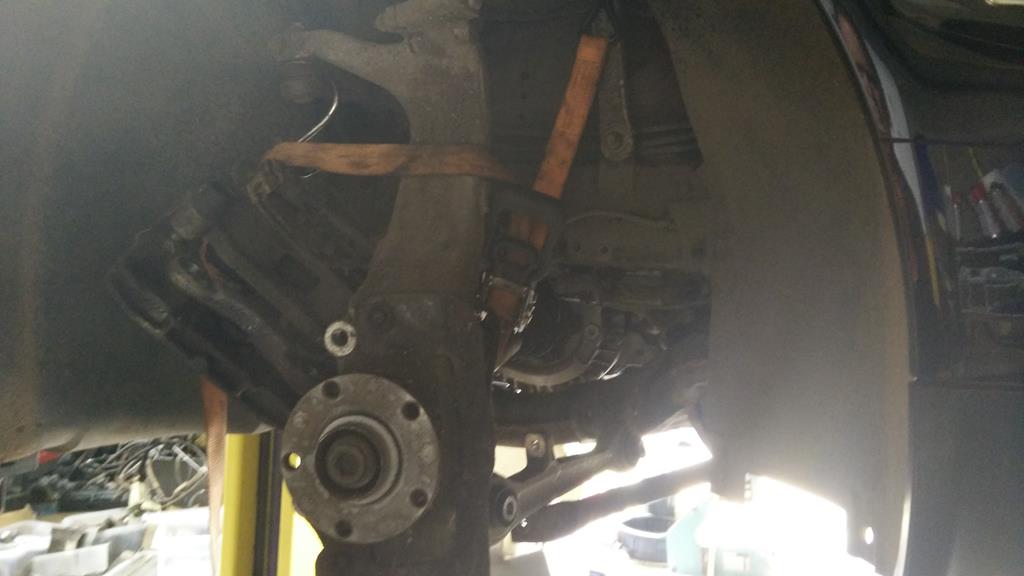

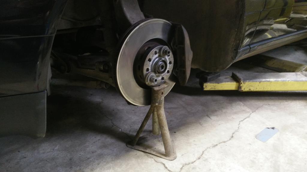

Supported the upright with a strap while I swapped the strut and lower arm over
I keep a spare flange nut to use as a drift in these occasions so I can hold a socket on it and give it a solid hit with the lump hammer to pop the taper loose
Boot deteriorated, and most definitely no longer 'preventing the ingress of dirt' I replaced it with a good used one for now.

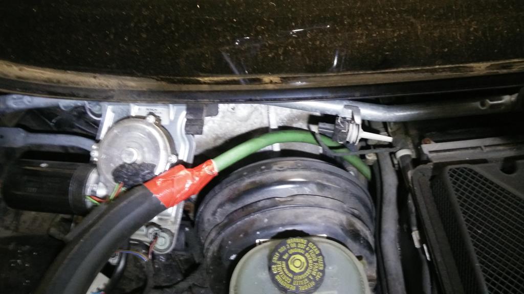

A hose on the end of the shop vac can reach underneath the heater to suck all the debris out of the drains
With the passenger side output flange heat shield removed I can just get my hand to the drain outlet. I use the same green hose but this time attached to the compressor so I can blow any remaining debris out of the drains.

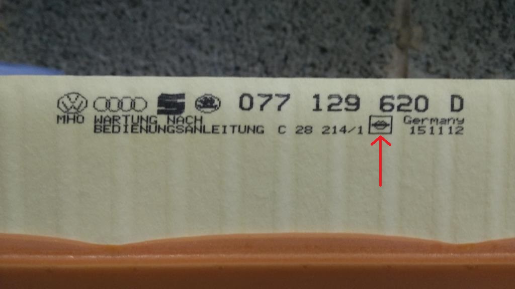

These are the last ever genuine D2 air filters
Does anyone recognise this logo?

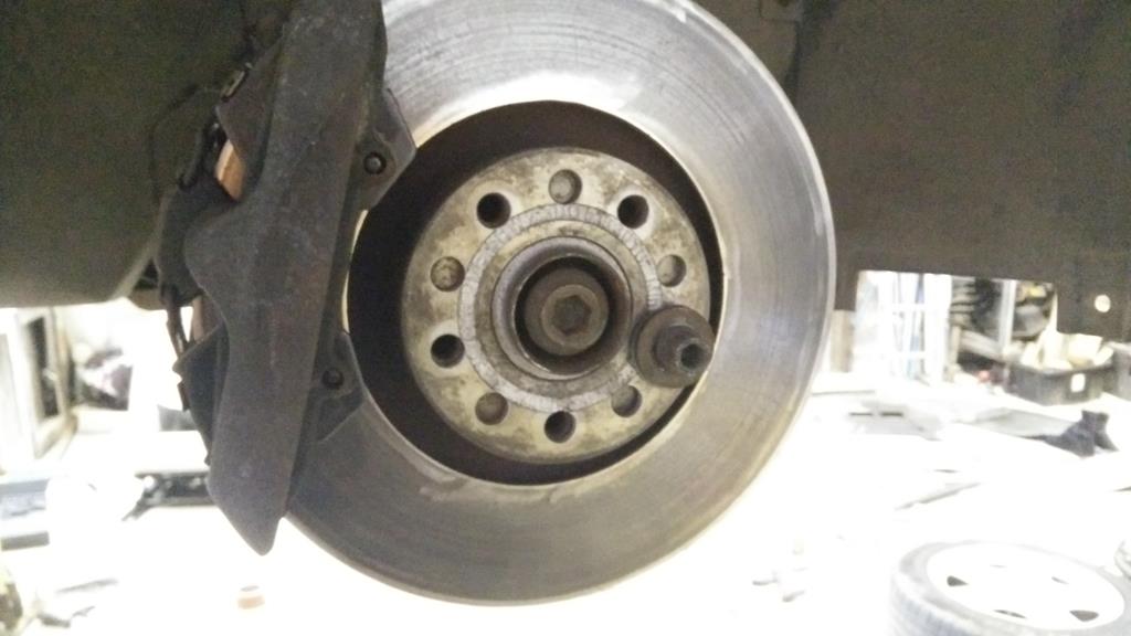

OE rear discs cleaned up enough to bed in some dirt cheap pads . These discs will be replaced if I keep the car
The front discs are also OE and in pretty good condition so I put some TRW pads on these

This is the extent to which you have to go to dry out wet carpets. I took about 3 litres out with towels, and the dehumidifier has taken a litre per night out and is still going.
I'm really hoping it can take the remaining water out overnight so I can put the interior back together tomorrow, since the MoT is 08:00 on Thursday...
The quantities are oh so familiar, but your methods are more brutal than mine.
I knew I had a real problem the first time with my wonderful old PF when water started spraying out of the rear vents behind the armrest...….
Since then I've just got more accepting of the inevitability of it all and "just deal with it" as necessary.
