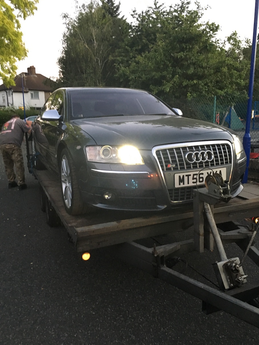

So after holidays I asked my mate if he fancy a 500miles trip there and back to Preston to pick up a car with me (he is S/RS maniac driving RS4 by the way) ? He asked what car? I said S8. He was like hell yeah!!! I said sweet and told him to give me two days to organise things.
I booked a truck to meet us at the destination for 1pm and considering I haven’t driven the new A3 much I though what the heck, lets take the little one for a road trip. Surprisingly the S-Line seats along with the sport suspension on the little car has been fantastic, we both came back kind of rested with no back pains whatsoever. Anyway...

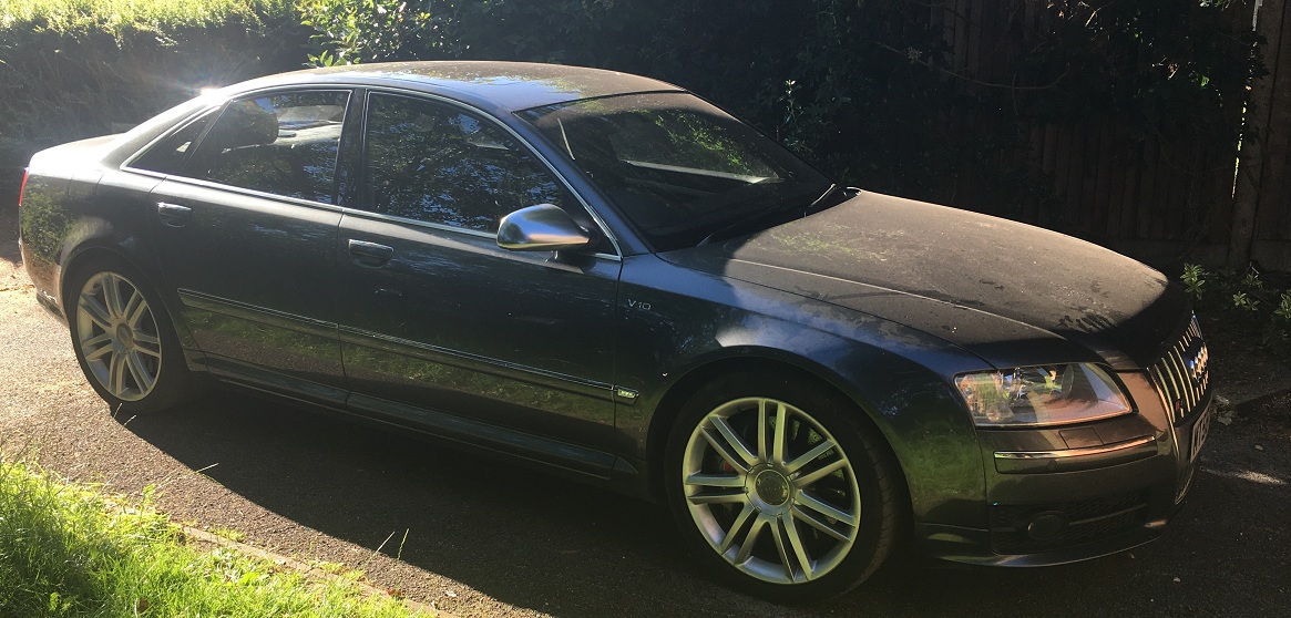

So, here it is, the first shot of her late evening that day on the back of the trailer and later on the driveway.

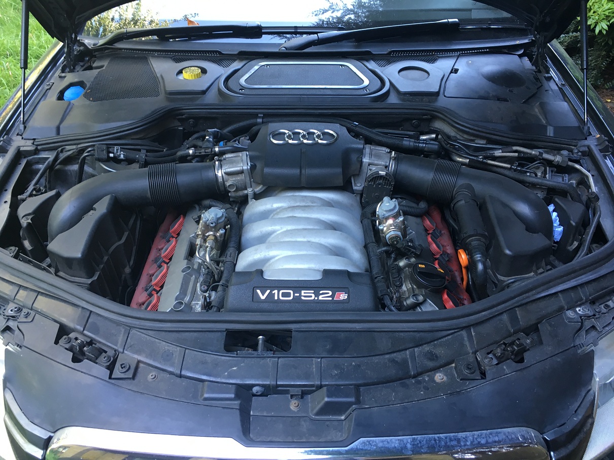

And the filthy engine bay which got me a bit emotional.

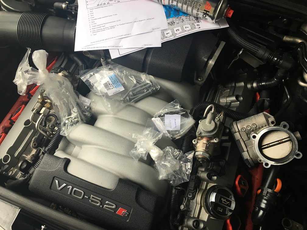

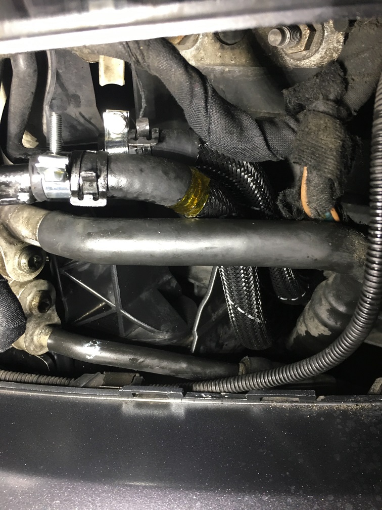

So, the feedback I got was that timing chains need doing along with the manifold and both were clearly audible, but... I wasn’t aware of the full spec when I was bidding on it so with some mental support from Del and Scott the idea of taking the engine out and sorting the chains was on the table very quickly, mainly because of everyone telling me to keep her after not getting D4 S8 earlier on in the year. So a list of all the specialist tools has been made along with the decision of taking the V10 out - some said two gambles on one car, you are crazy! The only one guy who had his pants dry throughout was Del

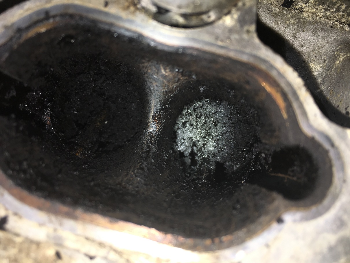

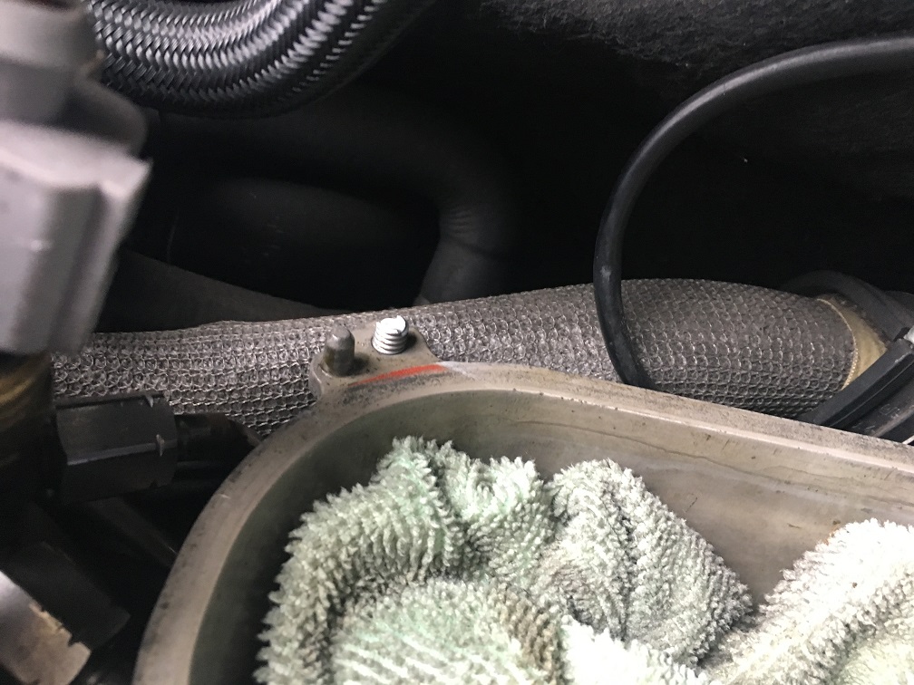

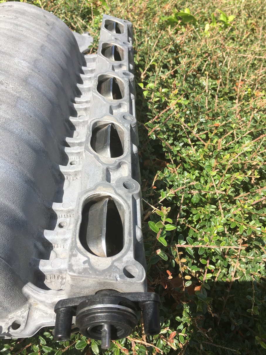

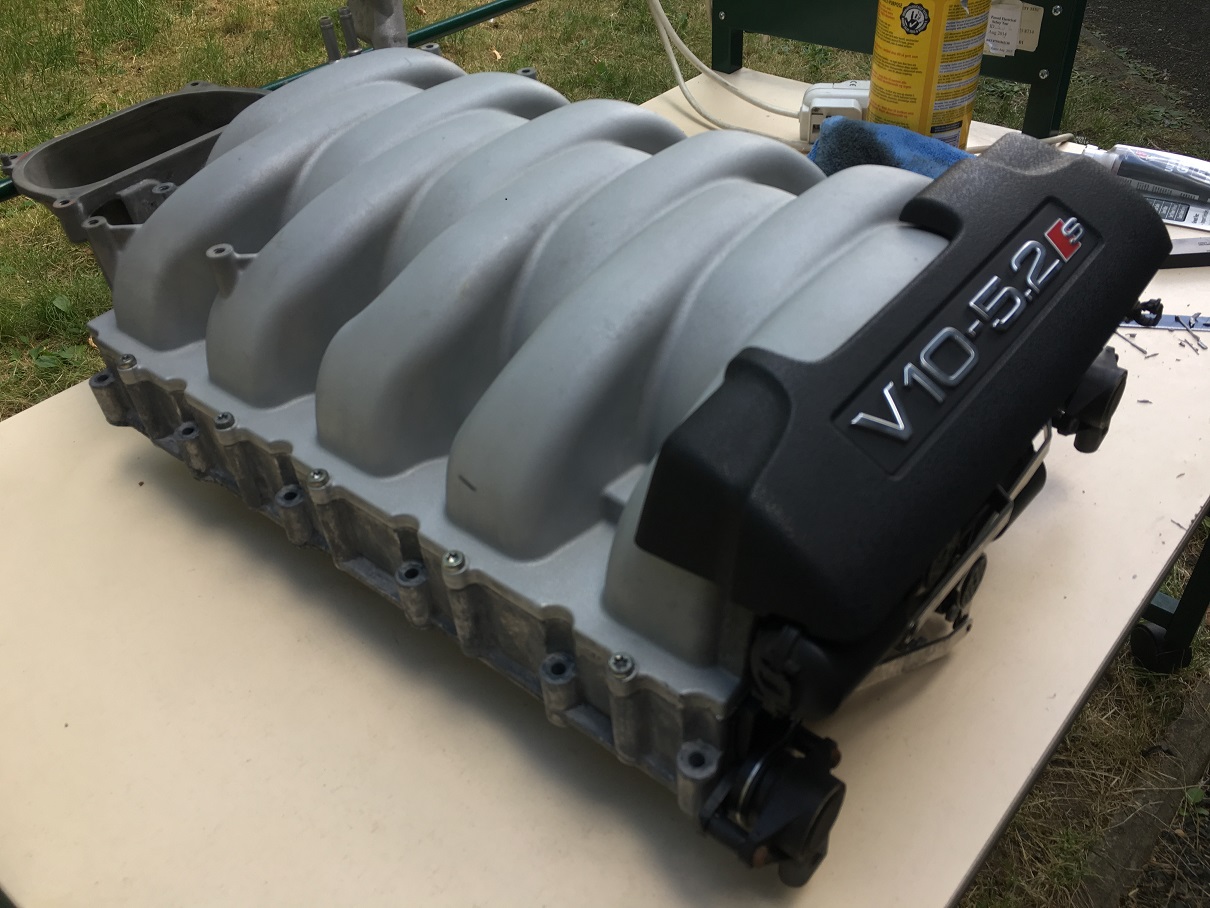

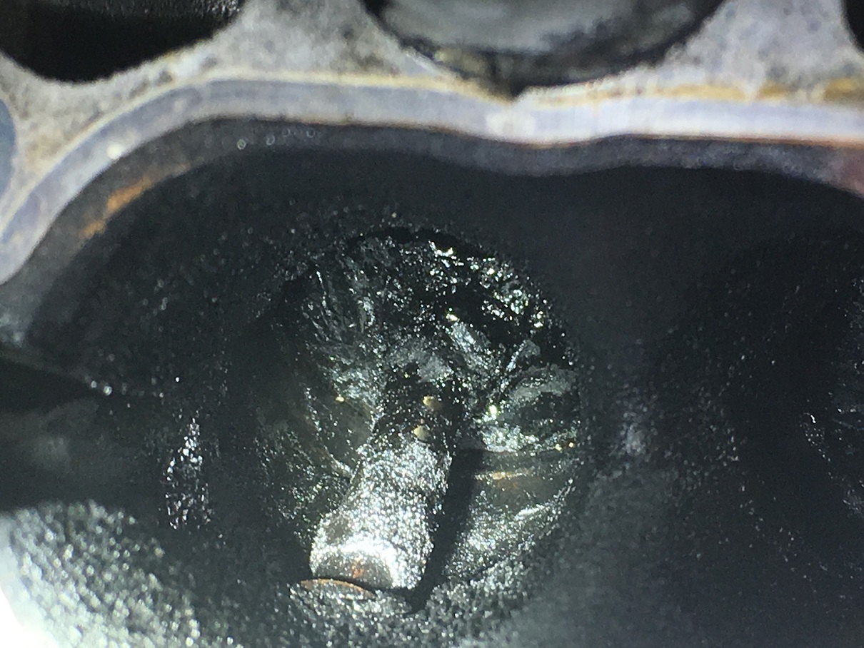

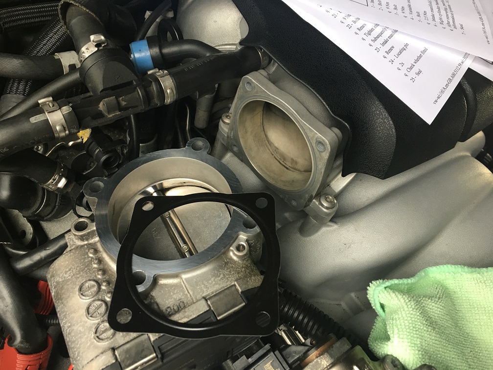

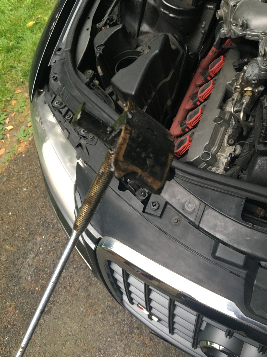

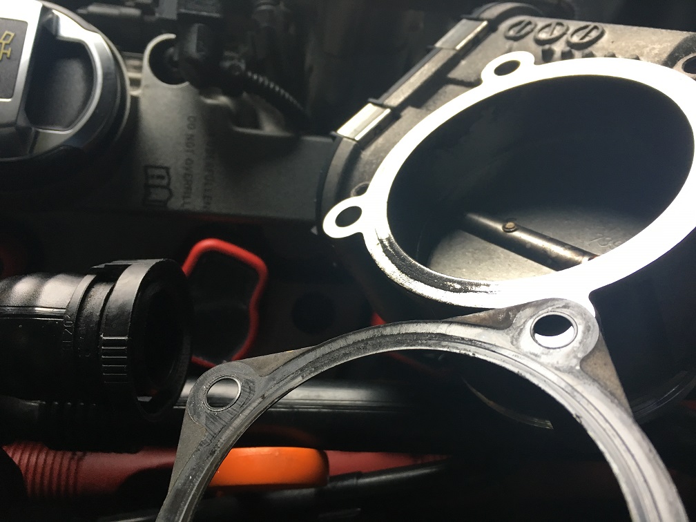

First item on the list was to take the T piece and have a look inside the manifold to see what’s cooking there and oh well, this is what I found...

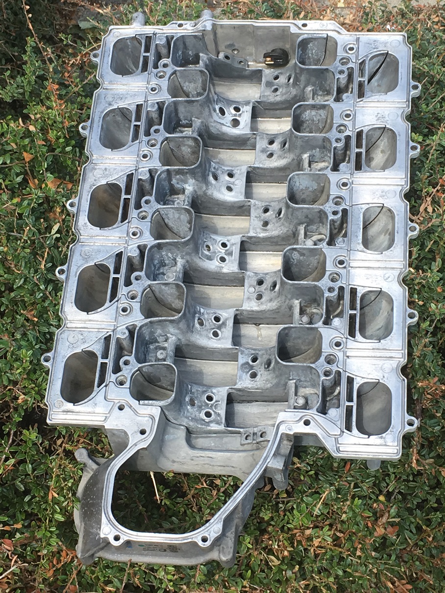

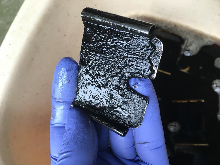

...a broken inlet manifold flap with others, one row only tho, in a poor state as well and on the edge of breaking off.
So very quickly this evolved to a full rebuild of the manifold and deleting the flaps.
Full info in this thread
http://forum.a8parts.co.uk/showthread.php?t=12128

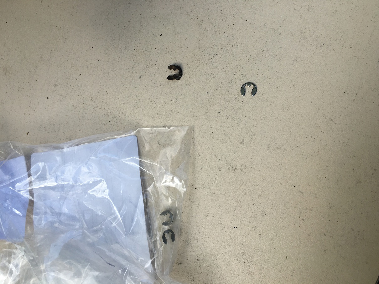

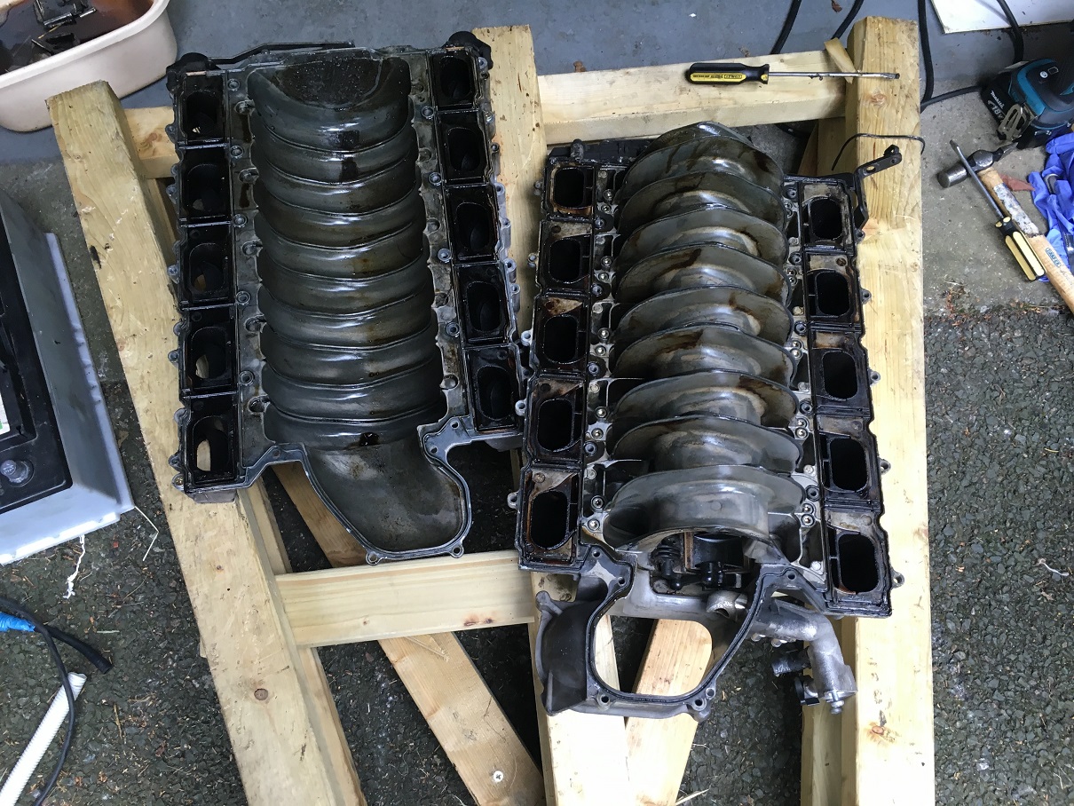

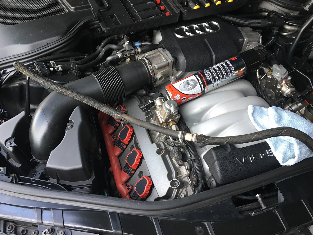

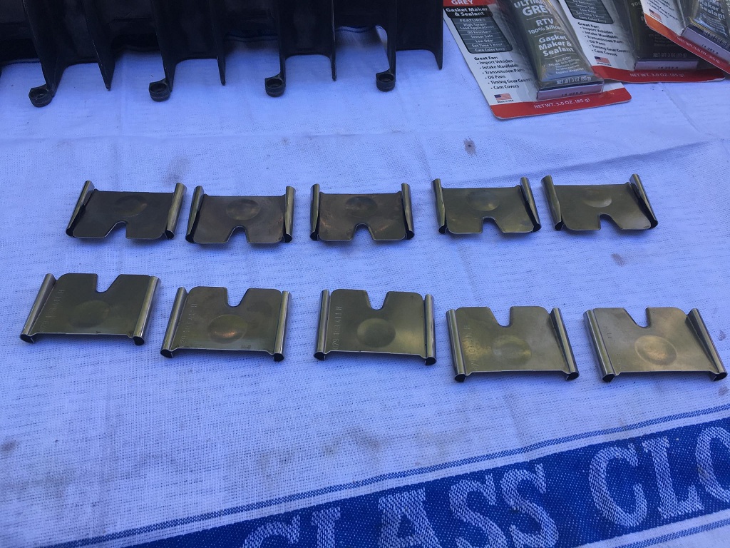

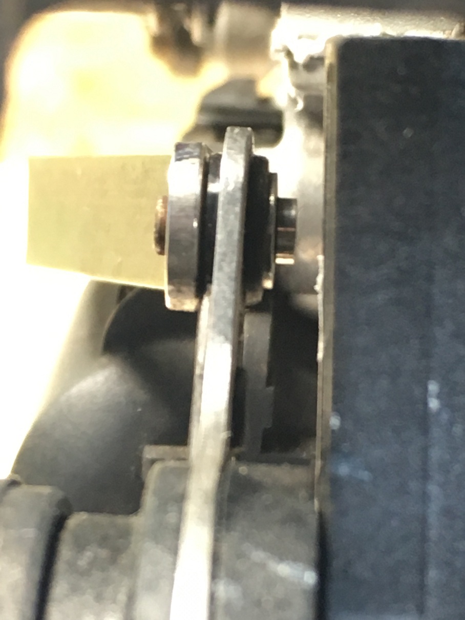

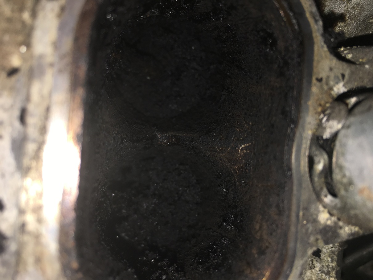

I’ve also noticed a missing secure clip on the end of variable inlet flaps arm so I got all 3 replaced after quick call to Audi day earlier.

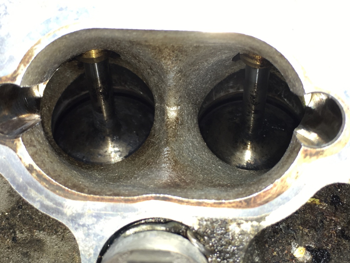

But, because the manifold was out exposing all inlets in a bot of the coked up state, it only made sense to do the full decoke especially that manifold was already fully cleaned in and out, I mean every corner every gap.
So a decoke process took place with a great result.
http://forum.a8parts.co.uk/showthread.php?t=12123

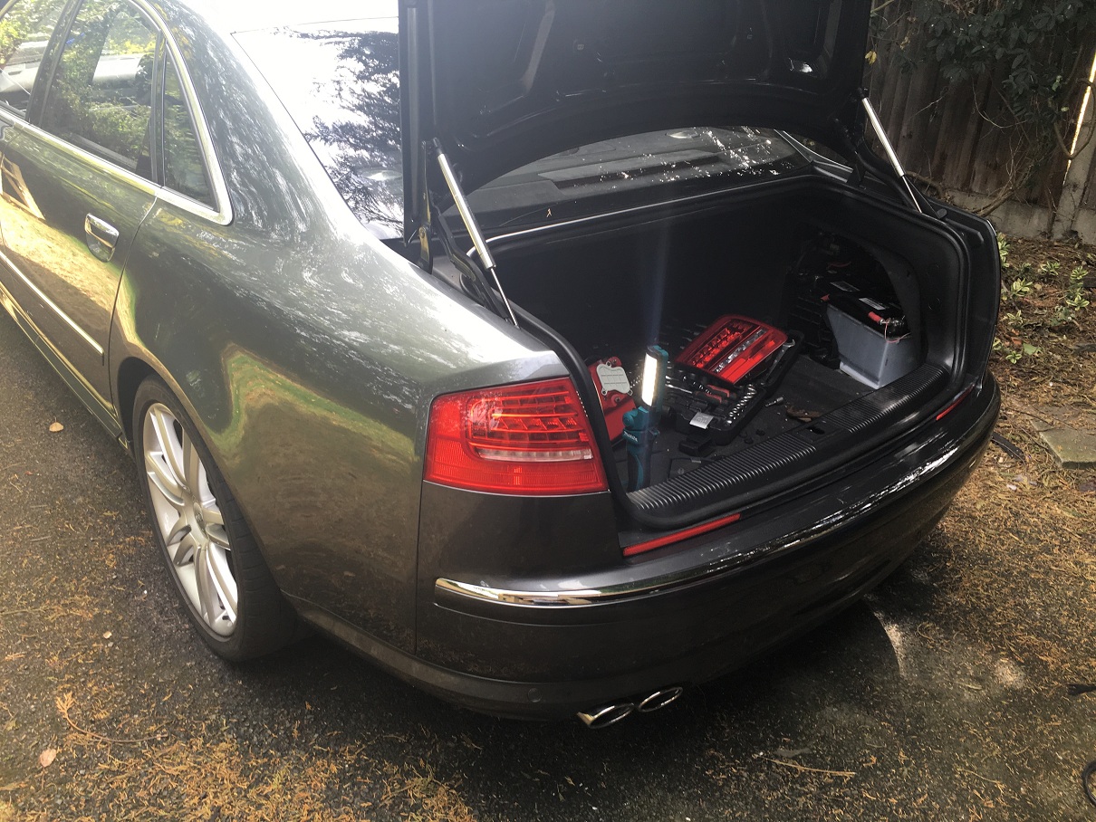

So on that note time came to service the engine and clean the bloody thing as it was driving me mad.

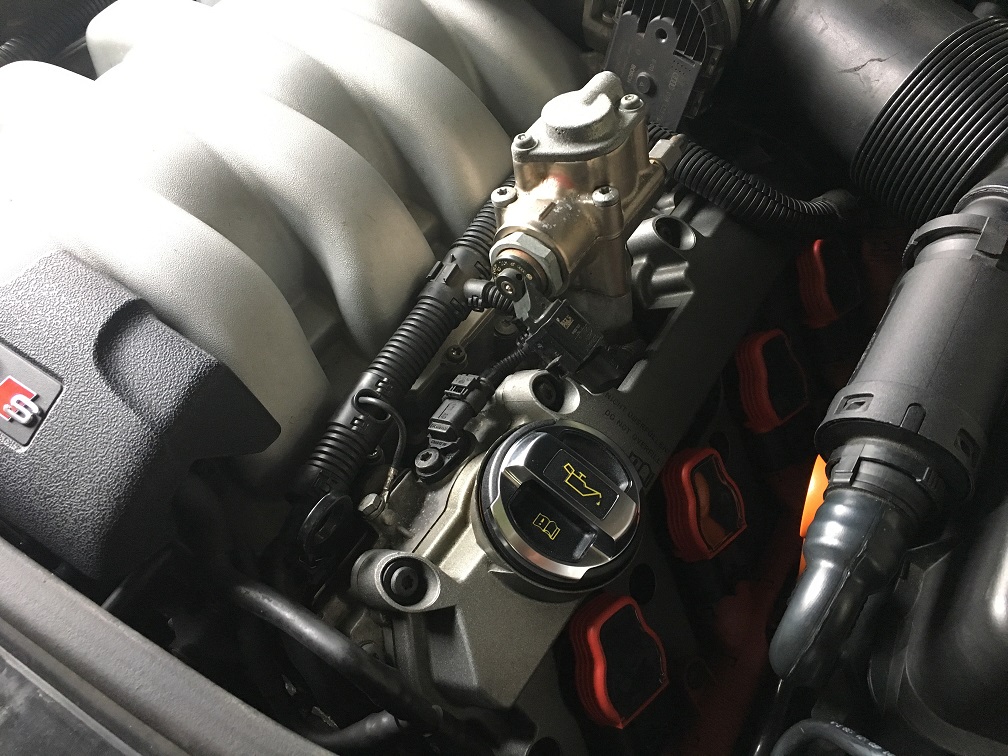

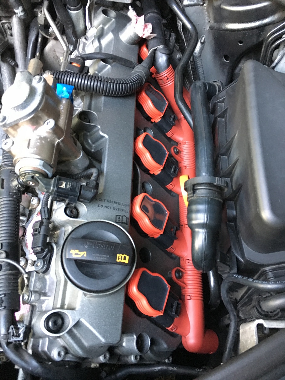

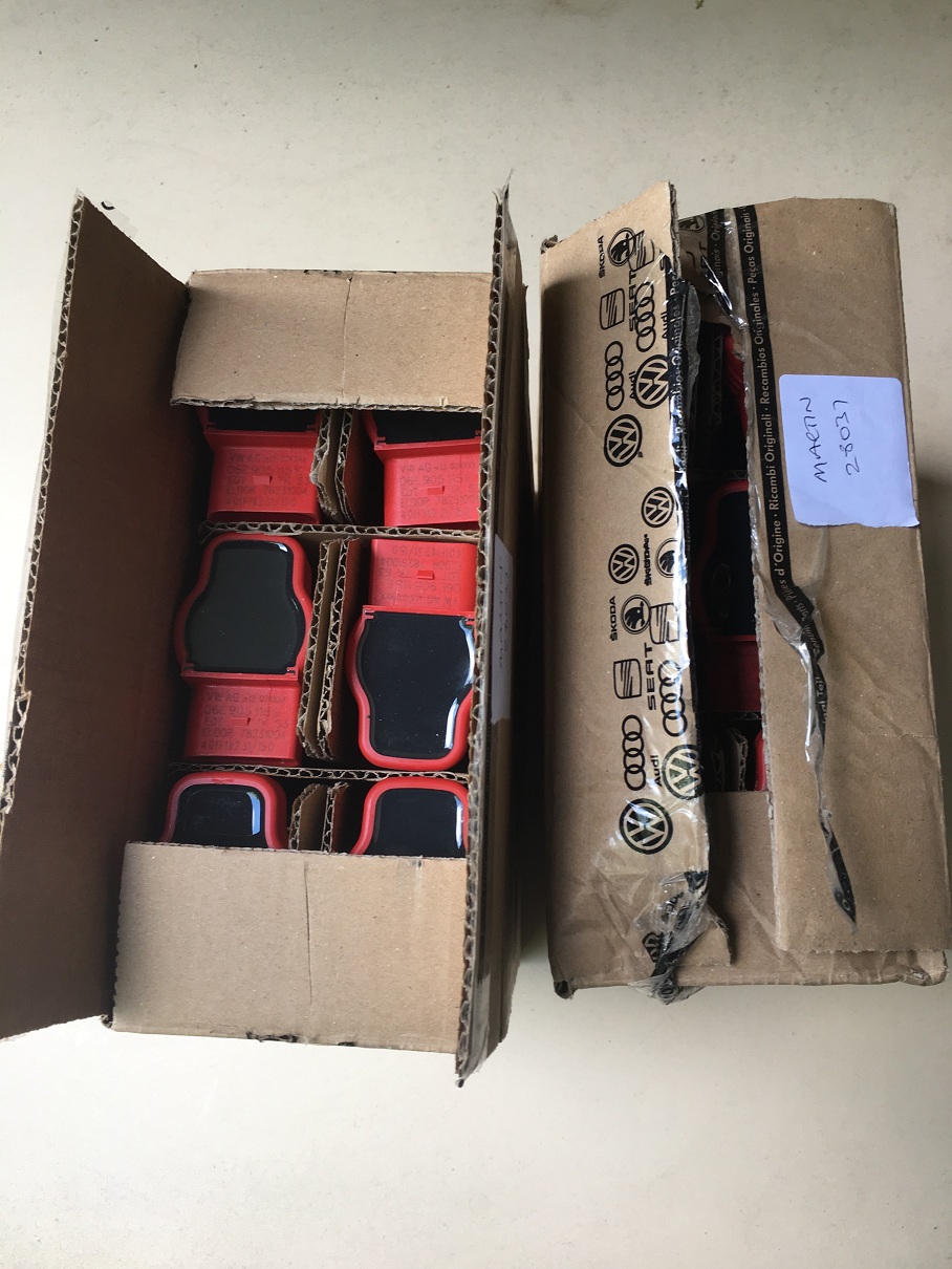

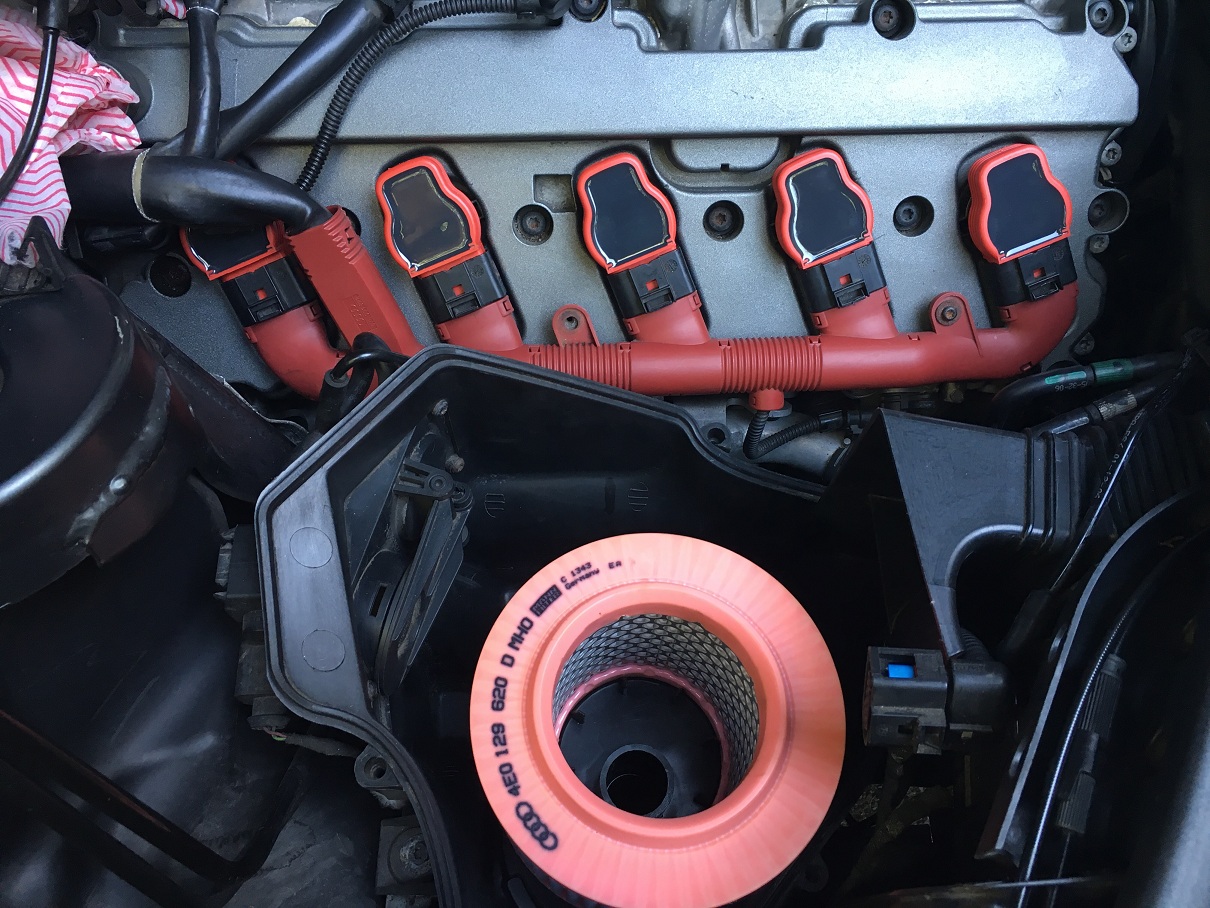

Off I went to Audi to get her a new oil separator and new coil packs.
I have also ordered 10x NGK Platinum spark plugs and new air filters and started cleaning every bit of the engine bay inc. air boxes, hoses, harnesses, plugs, you name it.
Spark plug holes were a bit filthy so I got them cleaned as well and fitted new spark plugs.

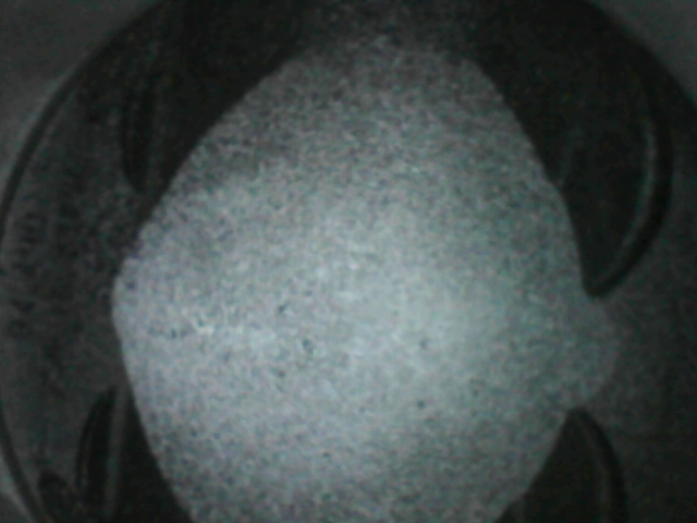

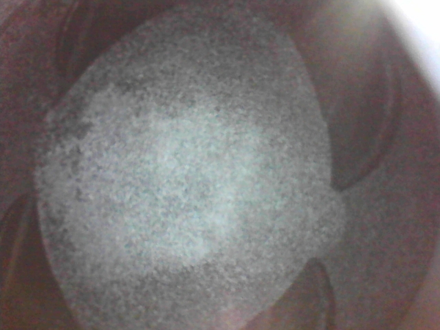

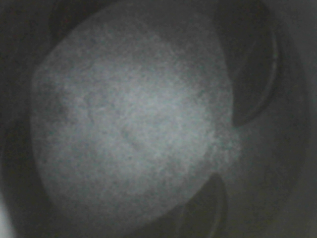

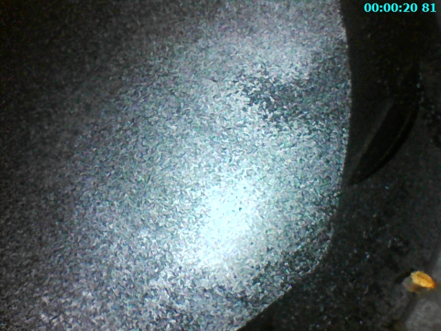

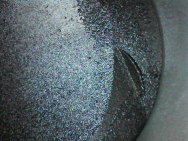

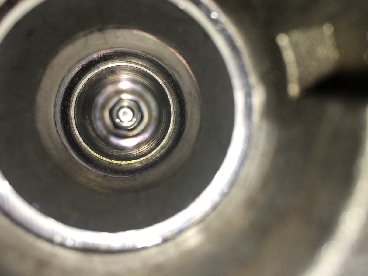

But before I did that I thought it won’t harm sticking camera down the cylinders just to have a peak.
Now it was time for the compression test on each of the cylinders to check for any invisible on the camera wear and to prove that mileage on these engines and any other V8s is a bit of a myth if car is cared for and well maintained.
Mileage is 160k.

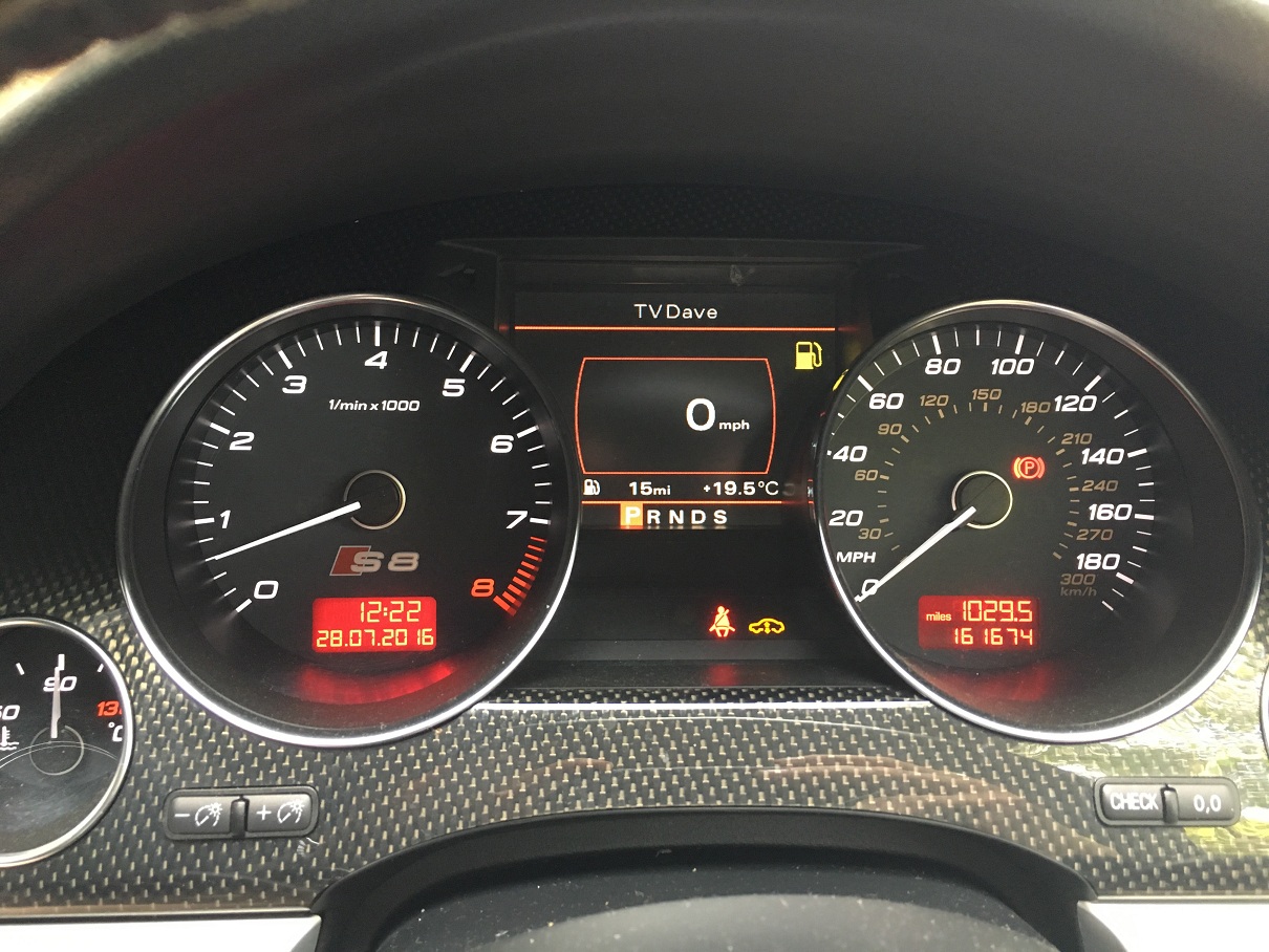

Next on the list was suspension light on the instrument cluster.
Thankfully it was only a faulty level sensor on the rear wheel which explained why @ss was siting so low.
After sorting that it was time to do the suspension calibration while cheating on the values a little so the car can sit a bit lower by entering slightly higher readings, something I’m not 100% happy yet and it’s on my list to do – lower it slightly more.
That’s car going up to lift mode before calibrating suspension for the 4th or 5th time just go get the values within less than 5mm between the wheels for each axle.
So after sorting that and instrument cluster showing no faults I’ve realised there is something missing here….ah yeah, chrome steering wheel buttons and my beloved custom paddles from US. Not everyone likes them, but I do, plus I use paddles a lot and they are sooooooooooo much better and sooooooooo much more comfortable than standard paddles it’s just unreal. It just feels so much better and more solid not like the standard A8/S8 plastic clicking almost identical to some budget gaming steering wheel.

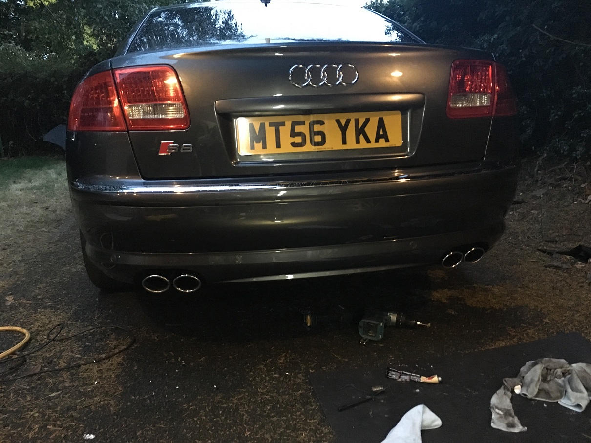

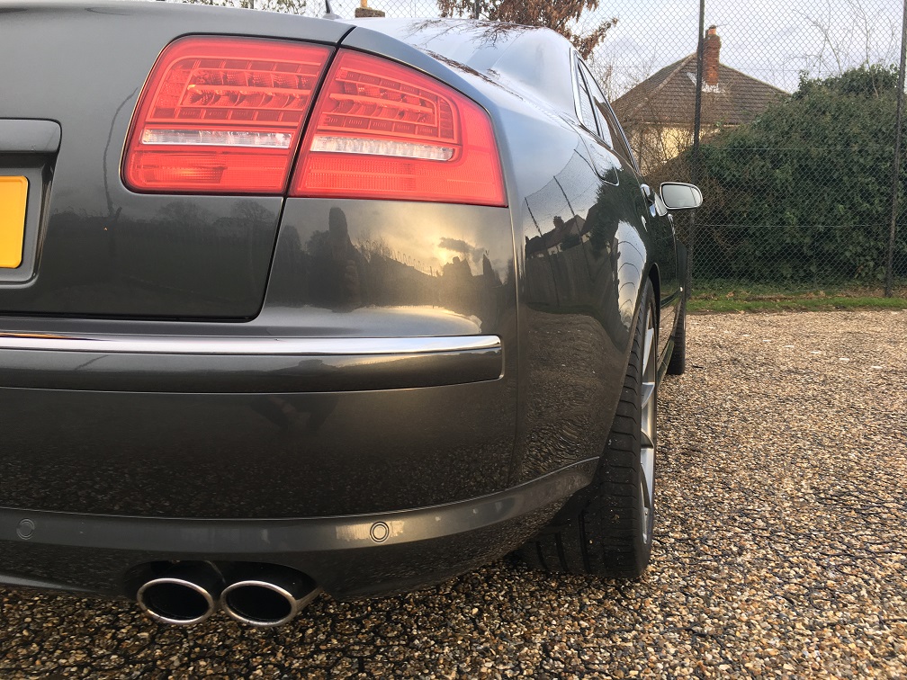

Next on the list were of course the tail pipes, another thing I can’t stand being filthy.
Here they are before...
...and after

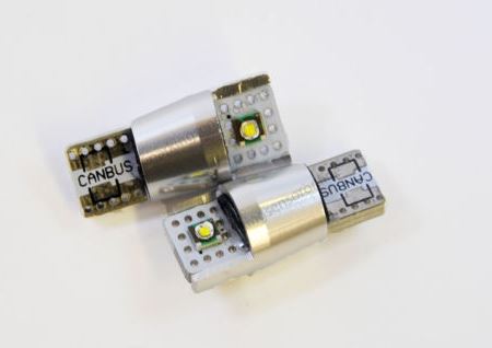

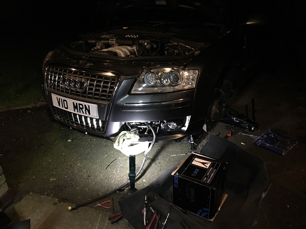

Next were the FL tail lights, in my opinion a must on any PF A8 or S8, they just change the look of the car so much is unreal.

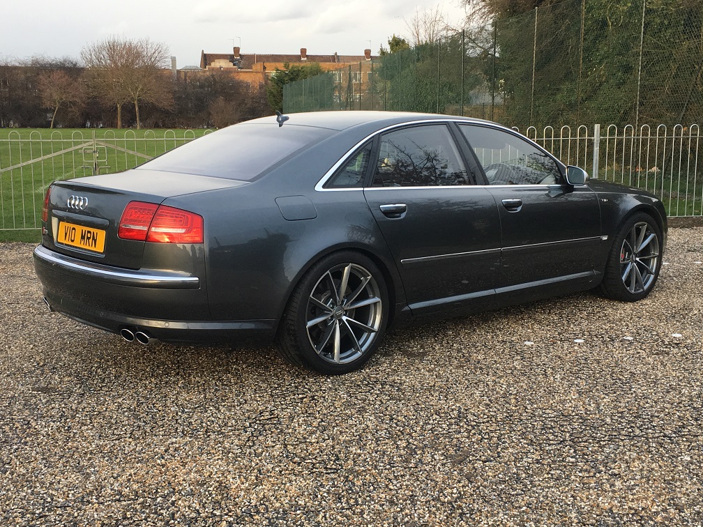

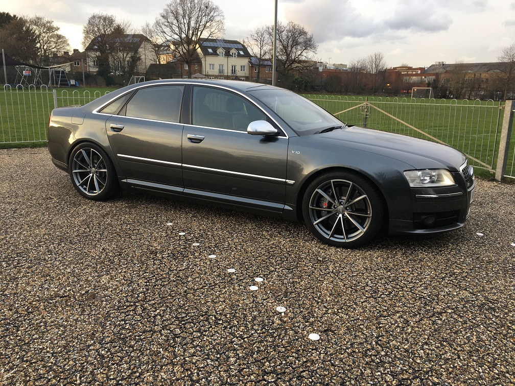

And here she is on her first test drive with the rear end looking sweet and clean.

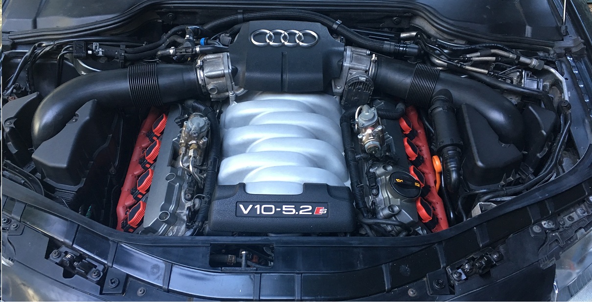

And obviously the engine bay which looked like that all over...
…to look like that after.

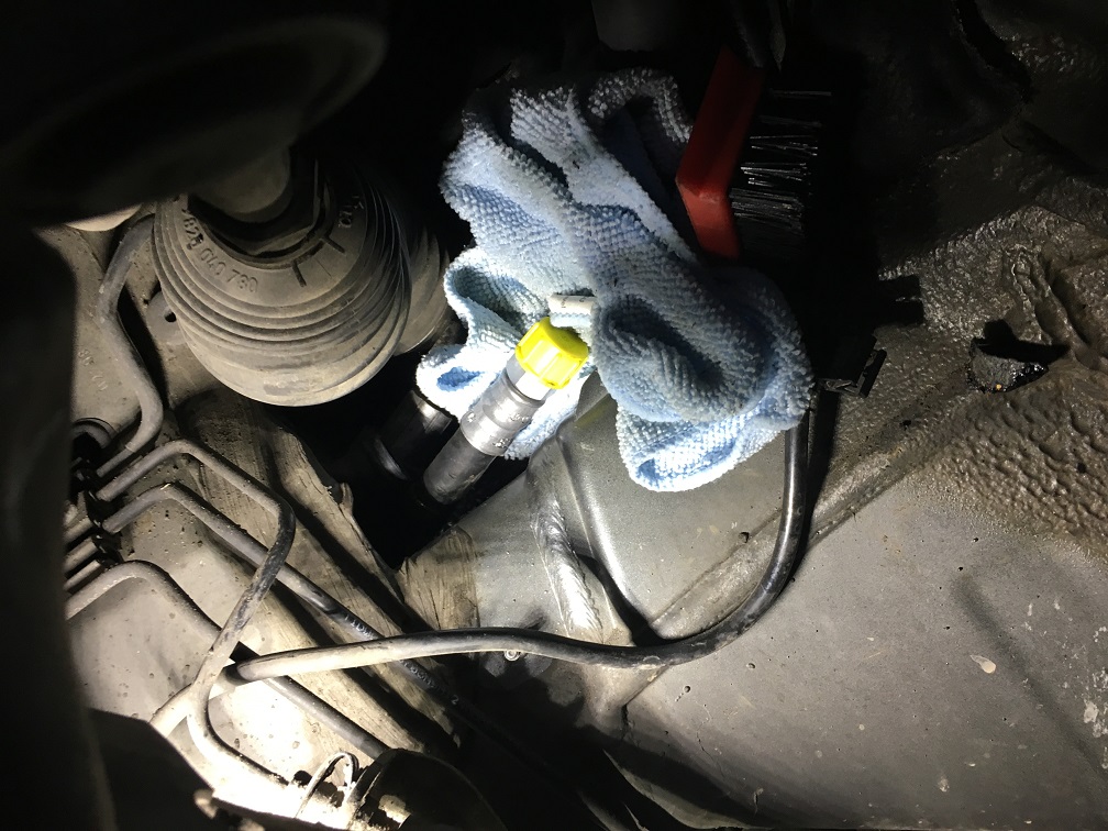

So the next was the service (over 3 days) where she had:
- Every door boot bonnet hinged lubricated
- Checked entire underbody and every component inc. any software updates
- Oil change and filter
- Gearbox service
- Dif oil change
- Rear pads
- Rear wheel bearings
- Alternator belt change
- Air Con service
- Brake fluid change
- Coolant change

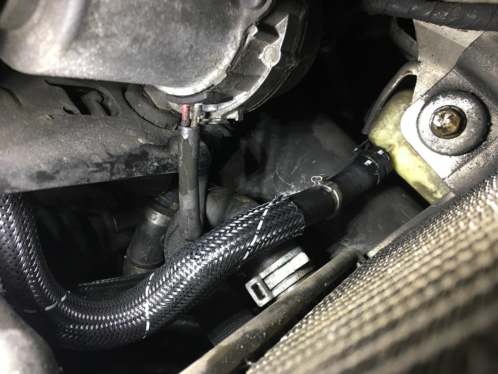

- One of the radiator fans wiring repaired
- Suspension’s compressor piston ring changed
