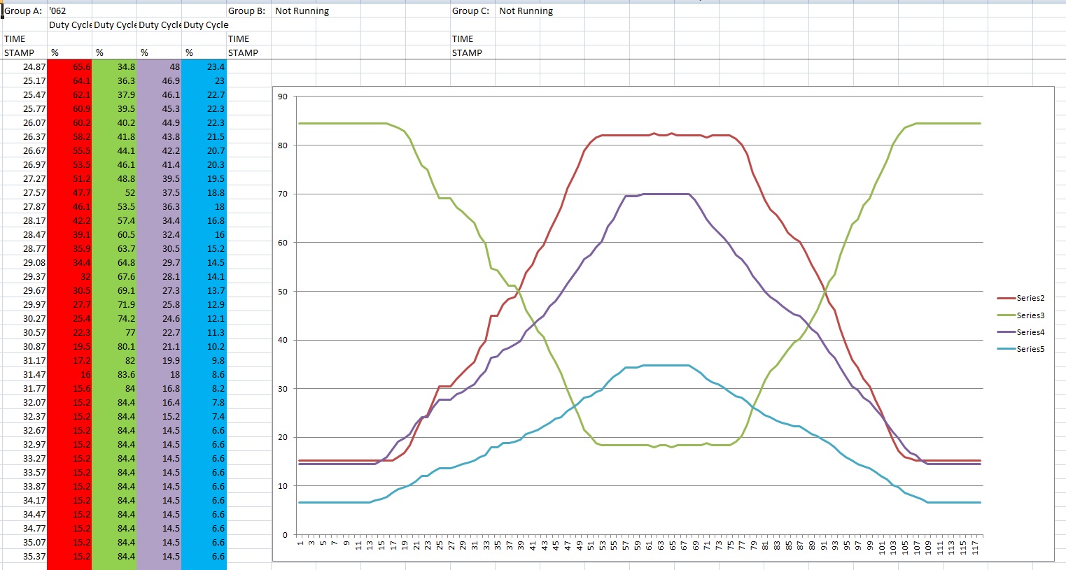

Could you tell me what channels to measure, and I'll see if I can do it. I only found one test for it and that was when static. It was also just a single reading, not dual.

See here: http://www.ross-tech.com/vag-com/m_blocks/060-069.html Group 62 shows all 4 values for pedal and throttle body.

Had a look at that, and also managed to get Elsa running again on the other laptop. Having read through what it says, I think my test sorts of confirms that my TPS is kaput. See below for results:
The Red and Green traces are the throttle valve in the engine bay, and is working correctly as one is a mirror of the other. If I've read the details on Elsa correctly, the Blue trace on the other hand should be a mirror of the Purple trace, which it clearly ain't. Time to dig out the replacement, methinks!

According to this, that is correct: http://wiki.ross-tech.com/wiki/index...7/P1639/005689
There are 2 sensors in the accelerator pedal, both should increase in the same direction as the accelerator is pressed but they have different scales. This means one counts from 0 to 100, while the other one counts from 0 to 50.
