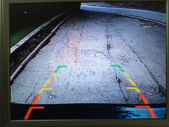

So I just blu-tak'd it to the place in the pictures above and jury-rigged a monitor. Line-up pretty near perfect, with bumper in view as required.
(Might just raise it a few degrees when finally fitting)
Old 15th July 2016, 01:24 PM
Just measured up, the very bottom of the screen view is 1" to the rear of the shiny trim strip and 2" from the rear edge of the bumper. Forget adjustment, that will do.
On a negative note, the coloured lines are a bit rubbish.

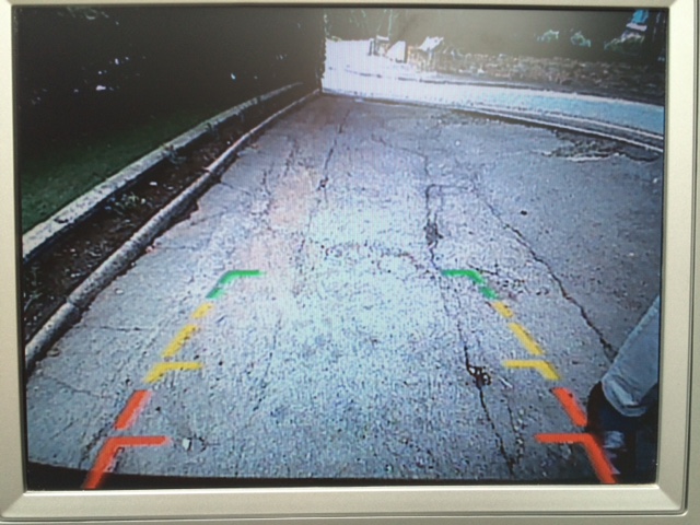

On the other hand, when raised a bit the view into the distance is better....
The lines by the way are "roughly" in line with the INNER edges of the tyres.
