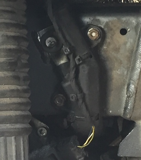

Coded the battery, attempted to start. Listened to the start click a few times. I had removed the strap and replaced it before tightening up. I removed the strap and filed the innner washer, chassis plate and bolt, to ensure a good connection. Firer up first time ������. Many thanks for all your help. Attached photo of strap

Old 30th October 2016, 07:45 PM
Did you have that earth strap off when doing the turbo?
Old 30th October 2016, 08:44 PM
North2007 North2007 is offline
Join Date: Jul 2016
Location: Mid Ulster - Northern Ireland
Posts: 74
Earth strap was removed, then secured back on, it was tight! However would not conduct well enough to turn starter. Only after a file back did it work.
2003, A8 D3 4.0 TDI
Old 30th October 2016, 10:06 PM
So where exactly is it?
Old 30th October 2016, 11:05 PM
Join Date: Jul 2016
Posts: 74
Right when arch, photo shows side of strut - just to right of it 13mm bolt securing
2003, A8 D3 4.0 TDI
Old 31st October 2016, 05:53 AM
That will be under the wheel arch liner then?
Old 31st October 2016, 07:15 AM
Join Date: Jul 2016
Posts: 74
Yes
