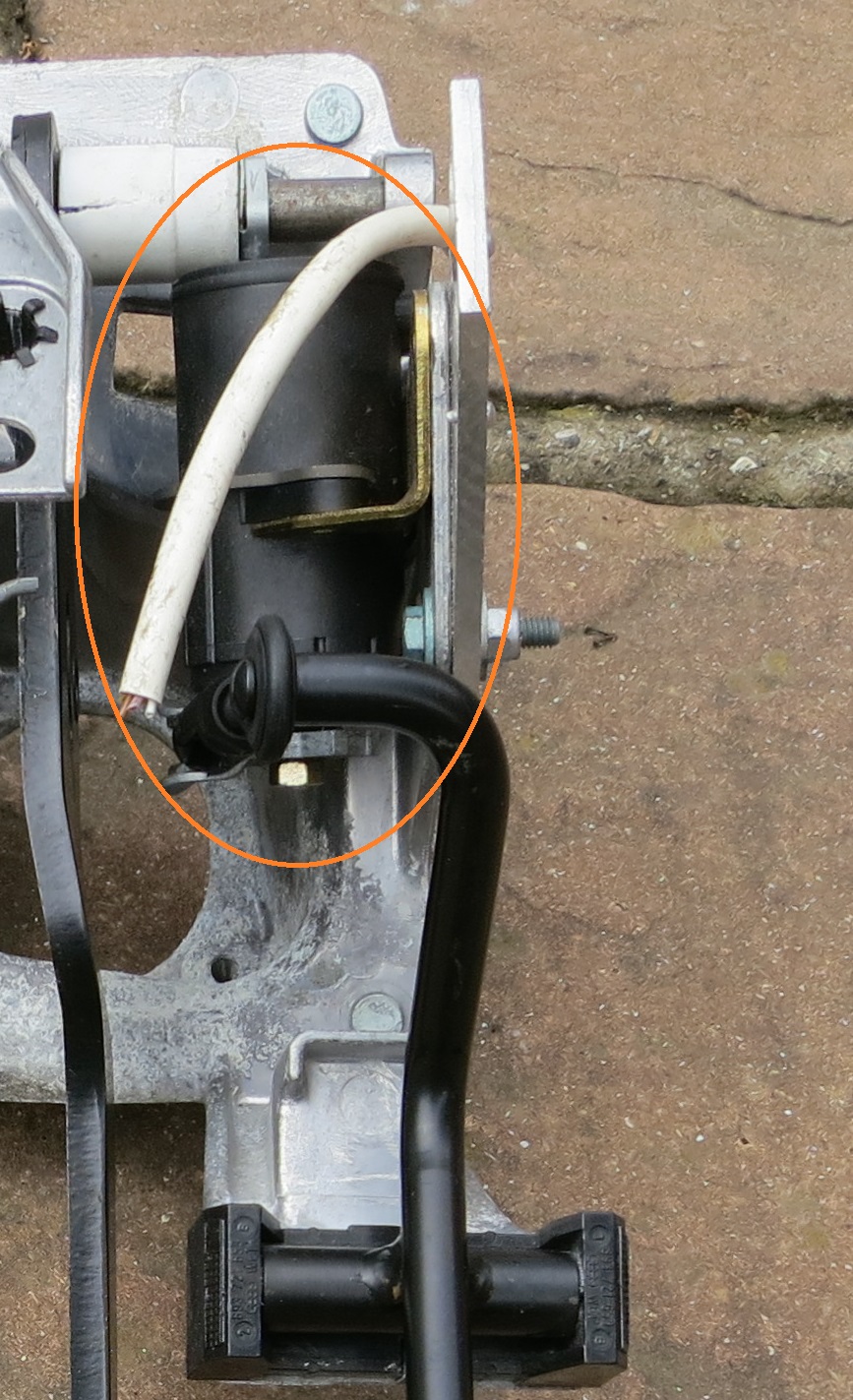

Just a random thought, could the gas pedal actuator itself be making the noise? its a little barrel shaped object connected to the gas pedal. Does the noise seem to be coming from inside the cabin?

I was thinking of the accelerator electronic mechanism, as long as its not at rest it could make a noise? I dont know exactly how it works but it can move the gas pedal on its own when in cruise control, check it out its freaky . When you press the gas its constantly under some sort of tension. I assume it must be electrical since it has no vacuum hoses going to it possibly its some sort of solenoid to move the pedal electromagnetically?
However that should mean it would make a noise even when car is stopped in neutral and revved.
Maybe there is nothing in there to make a noise anyway.

The pedal only moves (very slightly IIRC) with the PF cruise control, Sean has an FL model where it's all integrated into the engine management, no separate module.
Old 24th May 2017, 08:51 AM
Ah, ok, maybe I got confused with my old car, a Volvo, that pedal definitely moved when pressing the + / - button on the cruise control. Its a long time since I used cruise control on a D2, it doesn't work on my current car it only worked on my previous S8 and that was 4 years ago.
