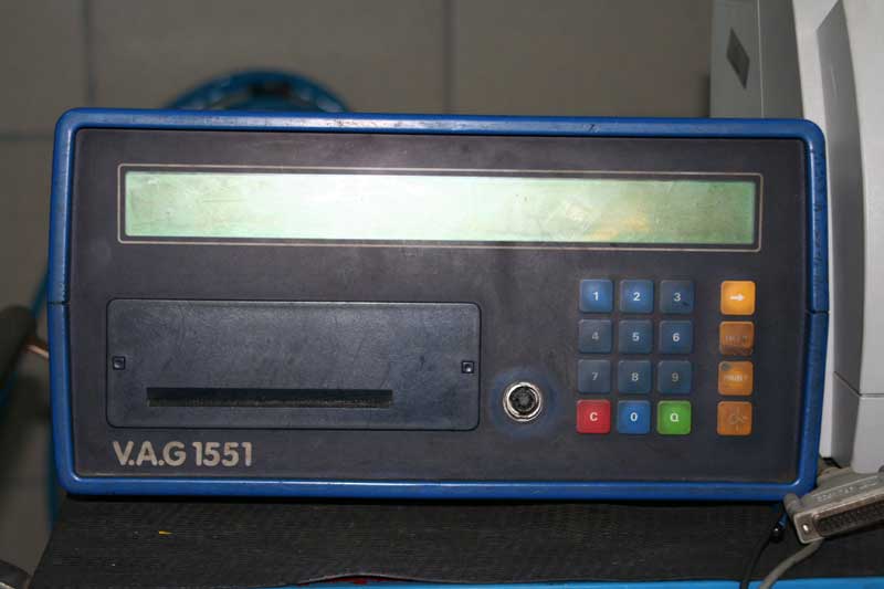

They have pulled out an old VAG 1551, I think he said. Should be a large blue box by the description; with a small printer module that takes forever.
The one who received the ECU from me, admitted that he was scared when I had reported the engine oil light immediately after the service. He considered telling me to not continue driving. And when I called two days later that the car had stopped. He believed it had a real oil pressure fault, and that the engine was severely damaged
