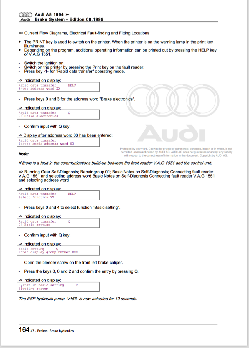

According to my workshop manual, see attached file

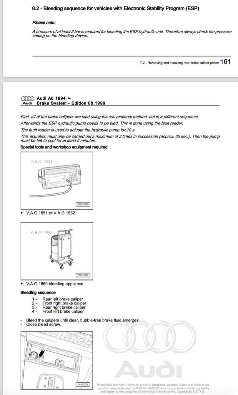

VCDS is only needed to cycle the ESP pump if the system has been opened in that area or drained. For a straight fluid change it doesn't need to be done. The sequence is different for cars with ESP though:
1 - rear left
2 - front right
3 - rear right
4 - front left
Old 30th March 2018, 12:16 PM

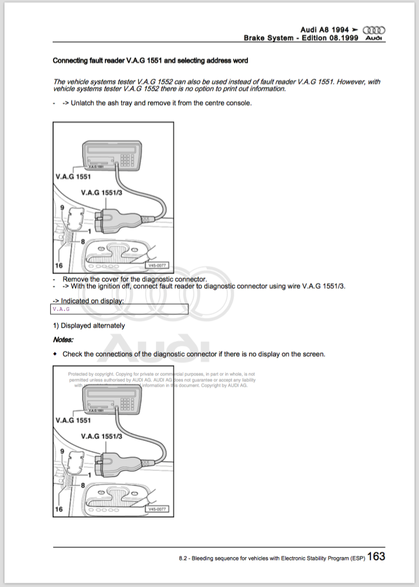

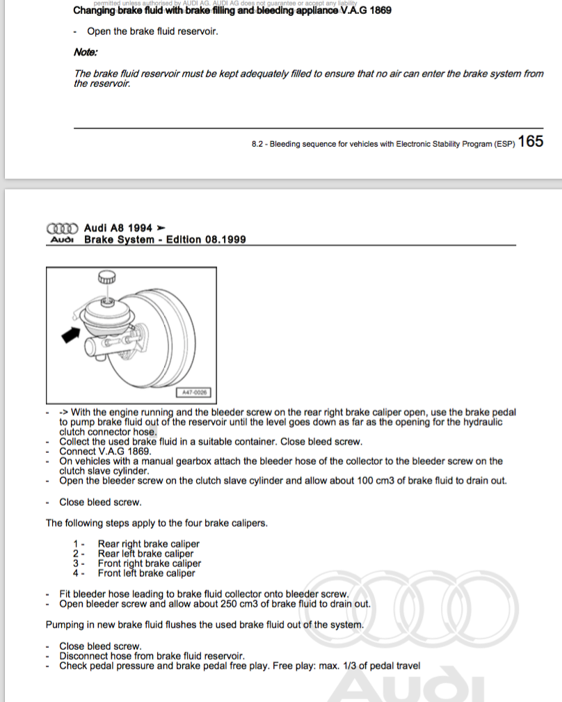

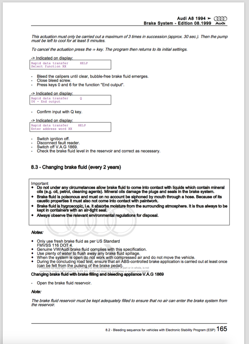

Here is what I have on the ESP procedure.
MJ is correct of course, as always
Name:	brake fuel change - esp.png
